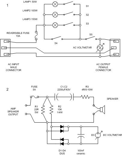

I'm sorry about your accident with the amp, especially that you blew a pricey speaker. BTW, it is an unspoken rule and common procedure that new DIY amps should be tried out on cheap speakers and that one should check DC offset on the output terminals before connecting the speakers. Once the amp has been built, it doesn't hurt to leave it loaded with such a cheap speaker for a few days so that various amp parameters are allowed to stabilize and to safeguard against any shortcomings that may cause malfunction in the long run.
When building an amp, the most critical moment is switching it on for the first time. More experienced (and those with more resources available to them) DIY-ers would use an autotransformer (variac) and gradually increase the voltage to the nominal level, keeping an eye on the basic amp parameters while doing that. This enables them to spot possible mistakes and prevent the parts from being destroyed. When testing low-power amps, one might find symmetrical bench power supply with output current limiting capabilities very useful as they make it virtually impossible to blow up anything.
In my early DIY days, when I had nothing of my current equipment available to me, I built myself a simple circuit which I used to insert between a wall outlet and the amp I was testing/building, as can be seen on Figure 1.
Using the mains lamps 1-3 and the corresponding switcher combinations S1-S4, transformer pre-load is set. S5 serves as the main power-on switch while the AC voltmeter is connected to the output connector in order to monitor output voltage. By using this circuit I was able to replace variac and gradually increase working voltage of the amp, which proved to be very useful for servicing other equipment as well.
Also, your amp was damaged probably because a huge DC offset appeared on the amp's output. To avoid this, I used to insert a simple circuit (Figure 2) between the amp and the speaker so as to protect the speaker from damage.
Caps C1 and C2 isolate the speaker from a possible DC offset, R3 limits maximum speaker power (even if the amp becomes unstable), R1 serves as the minimum amp load. The bottom part of the circuit (diodes, caps) serves as a multi-purpose DC-AC voltmeter. It shows reading if DC offset appeares on the amp output (exceeding 0.7V) or if the amp oscillates.
Regards
