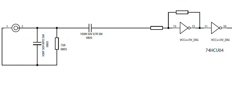

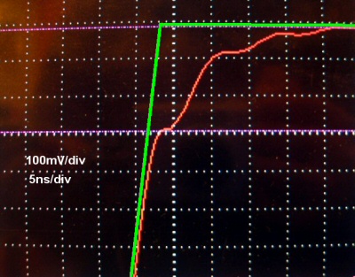

@SY
this dip down is effect of termination with 100 pF capacitor. 75R source, 75R BNC, 4 meter long 75R cable (+/-1.5R), 75R BNC input, termination with 75R + 100pF.
Cambridge Audio Dacmagic, if you want to know Input section schematic attached
Yes, but my question was directed at the actual topic, not at adding capacitors- what is the effect of an RCA connector in a correct impedance line which is otherwise correctly driven and terminated? Do you or Guido or anyone else have transmitted waveforms or, better yet, analysis of the analog output of the D/A for that condition? Not speaker wires, not capacitors, not wrong impedances, but RCA plugs?
