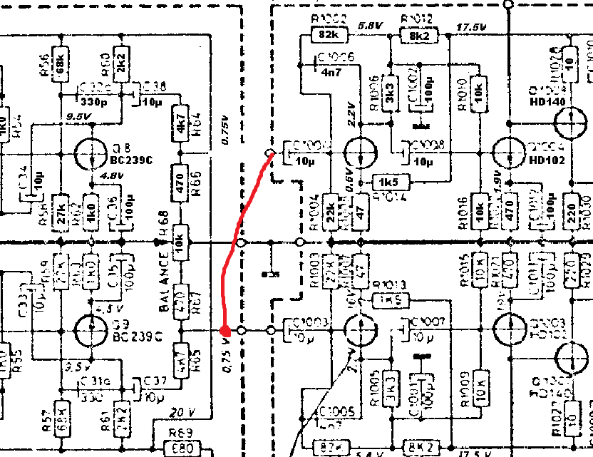

It sounds as though you may have a combination of more than one problem part, probably caps. You have found one that was faulty... and its not fixed it... so that's a pretty good sign there will be more.
Its not a very clear diagram to follow.
You could try isolating power amp input and linking it to the other channels feed. That would prove if there was a problem in the power stages.

Yeah, for a beginner like myself now try to pinpoint from that diagram the components to the board. I'm lucky I got this far with this with so little experience. I haven't tried reading on any diagrams before this.

I have a question: do you think the caps before bass pot (R48) could be in perfect working order since the voltage levels equals on both channels until that point? Would narrow down the search.

I've not got the circuit in front of me just now but the millivolt differences you measure are probably just caused by tiny leakage currents and slight normal variations in the DC conditons between the channels. If you measured say 6 volts on one transistor collector and 2 volts on the other channel, then is the time to start investigating.
99% certain your problem will be cap related from what you have described. All the electrolytics really need replacement (but its nice to find the problem parts/s by proper methods first).

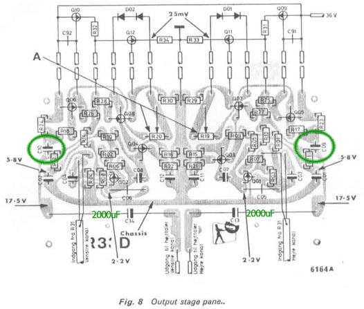

I have more questions, since I'm not very good at reading diagrams tho I can try and use simple logic. I have attached here screenshot of the actual pcb layout and circled the caps C09 and C10 (C1009 and C1010) and the reason for this is that on my amp output stage I see they are not installed on the board as they appear on the schematics. They both are inverted on the board. Polarity appears to be inverted for both caps and I can see very clear plus sign facing away from the 2000uF caps. What I understand of the schematics C09 and C10 plus sign should be facing towards 2000uF caps, right?
Why these caps are installed like this, because everything works great now and they appear in normal condition. Almost they didn't blow up yet in 45 years :D
I just thought to replace them as I have the replacements here, but I'm afraid to invert the current positions.
I have checked this multiple times and I can't make any sense of this. :confused:
Should I believe the board setup or the schematics?

The diagrams are really blurry to follow easily but it appears the caps are marked incorrectly on the circuit diagram. They are called 'bootstrap' caps and link the main output to the feed to the voltage amplifier stage, the idea is that at as the output voltage rises, it 'adds' to the supply and improves performance and linearity for that stage.
Third of the way down the page 'Active current source or bootstrap'
Elliott Sound Products - Audio Power Amplifier Design Guidelines
Fit the new caps the same way as the old. Whenever there is doubt just measure the DC voltage across the cap and make sure it ties in with the markings polarity wise.
Years ago the tolerance of electrolytics was often quoted as +100% and -50%, these days I think -/+20% is more usual for smaller values but your performance difference is coming from the fact the old caps had dried out and become high impedance.

Will replace the caps as they appear on the board. Wonder what a mishap in a critical document.

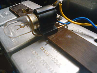

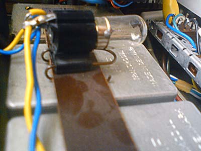

Another ridiculous issue is that the pair of lamps used to indicate power on inside seem like stuck and I'm having serious trouble removing them. Should they come out just by pulling them? I have tried to wiggle them with pliers, turn pull and push, but they just sit stuck there. Cursed.

Here are pics of the two lamps, both remain stuck, if it's any help pointing out how they should pop loose.
It can be said, the clamp assembly looks sort of fragile with plastic socket. I didn't use much force to them, if there's a simple logic to remove them?

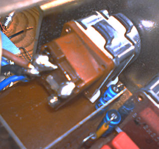

If the control burnt up then it has to be the switch part that failed. Look and see if the control is a standard 3 pin (6 in total) type or whether it really is a 4 (8) pin one which means it has the loudness feature.
The bulbs... I would have to be sat in front of it but they will either unscrew or push and twist and turn, or even just 'pull' out. After all these years they could well be seized in place.

I was able to determine the volume pot really has got 4 legs in a row.
It was tricky to see the leftmost left there, since the casing would block my view. All the legs seems to be soldered to the preamp board.
Maybe I wasn't clear enough or didn't understand all the way loudness compensation issue, but with "power-on" in my earlier post I referred to the fact the unit would turn off when you turned volume control all the way to the left. It would turn left and there used to be small edge in the leftmost position and turning the control over the edge the unit itself turned off and vice versa.
Volume pot with on/off switch.
Here are two quick photos. The other represents the controls in their leftmost position. Before the problem with the pot the controls would go to same position. Another showing the volume pot sitting on the pcb. It doesn't prove anything, but it appears something used to be connected to the bottom of the pot terminals there.
Finally I was able to remove the bulbs. They unscrewed off after applying small coating of CRC and then twisting. Thanks for the tips!
Actually playing around with the volume control, the switch is still there. There's still tiny edge to climb over, only the unit is not turning off, it's just muted as the volume is all the way down. On the preamp main rail there's still 36V present when muted.
