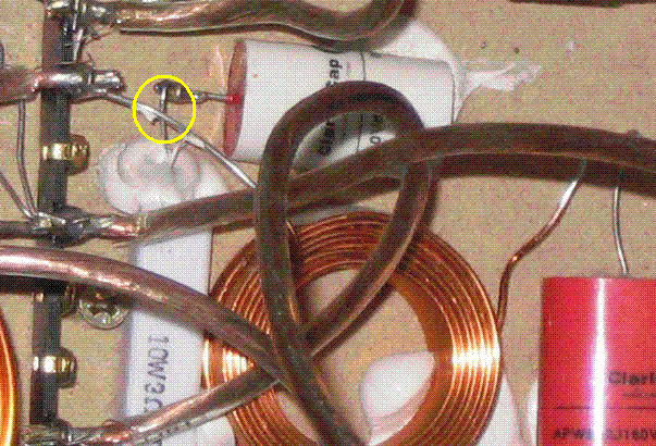

and if xo inductors are close together, they should be mounted correctly
look here
Placement of coils in crossover networks
is the xo layout exactly like original
component values etc
inductor resistance should be the same etc
Troels usually show it by a 'blank' resistor in schematic

what i will do is solder two wires over the 3.3 ohm resistor: the first resistor in the tweeter filter, cause he will put up the speakers near the ceiling in a corner. that should theoreticly bring up the lows with 9db; i guess at that point he will have to short the resistor to gain a few db's in treble. and that way he can experiment with some resistors without having to open the box.
at the moment i did not put any demping material in it. tomorrow i might find the time to test this.
