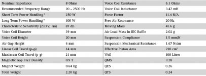

CD22RN4X has Le=3.47mH and Mms=42g and Qts=0.24. ICK
The 8" SBacoustics SB23NRX45 has Le=0.6mH and Mms=27g and Qts=0.38 (ideal for ported). Great for Xover to 4" midrange.

There are more problems with the CD22 than just the enclosure size.
-The CD22 has a massive shelf in the response at 600Hz. There is probably also a nasty cone resonance to go with it.
At least the CA22 has a generally rising response which is easy to correct in the crossover. The CD22 would require much more crossover work to hammer into an acceptable response for the ~580Hz crossover that the classic 8 uses.
-The CD22 is much less sensitive (2.5dB SPL) than the CA22 which would require the entire crossover to be reworked to bring the mid and tweeter down to similar levels. Troels also seems to be a fan of light weight high-sensitivity drivers which explains the choice of the CA22 in the first place.

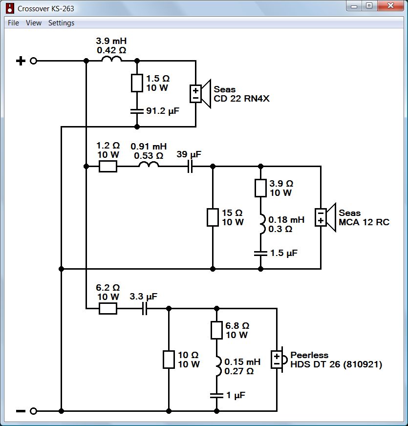

can you guys take a look at this link KS-263
and tell me what you think?

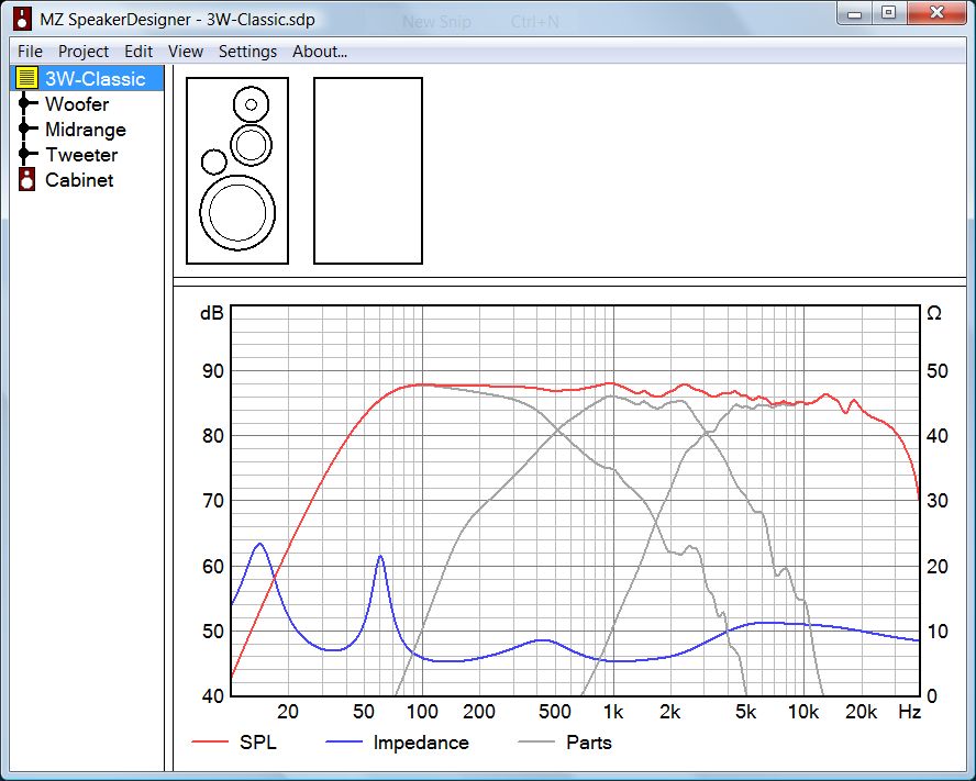

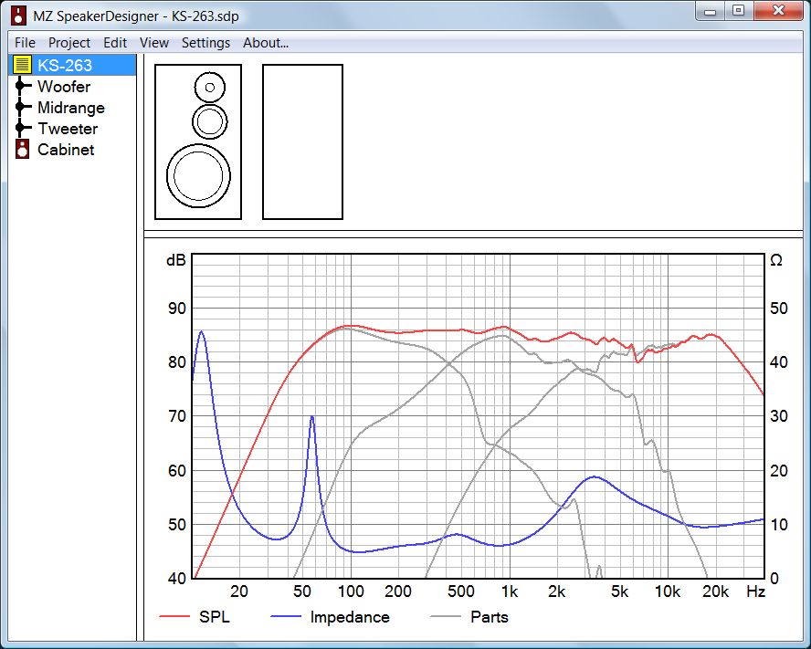

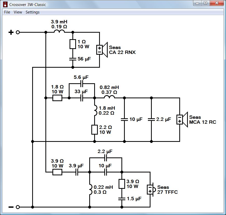

Based on my simulation the KS-263 seems to be a fairly decent speaker. There's a little peak at 1 kHz and a dip at 6.5 kHz. However the CD22RN4X doesn't go lower than the 3W-Classic due to the limited volume of 23 liters.

Troels is using 37- 40L
I would keep the baffle and come out the back end.
