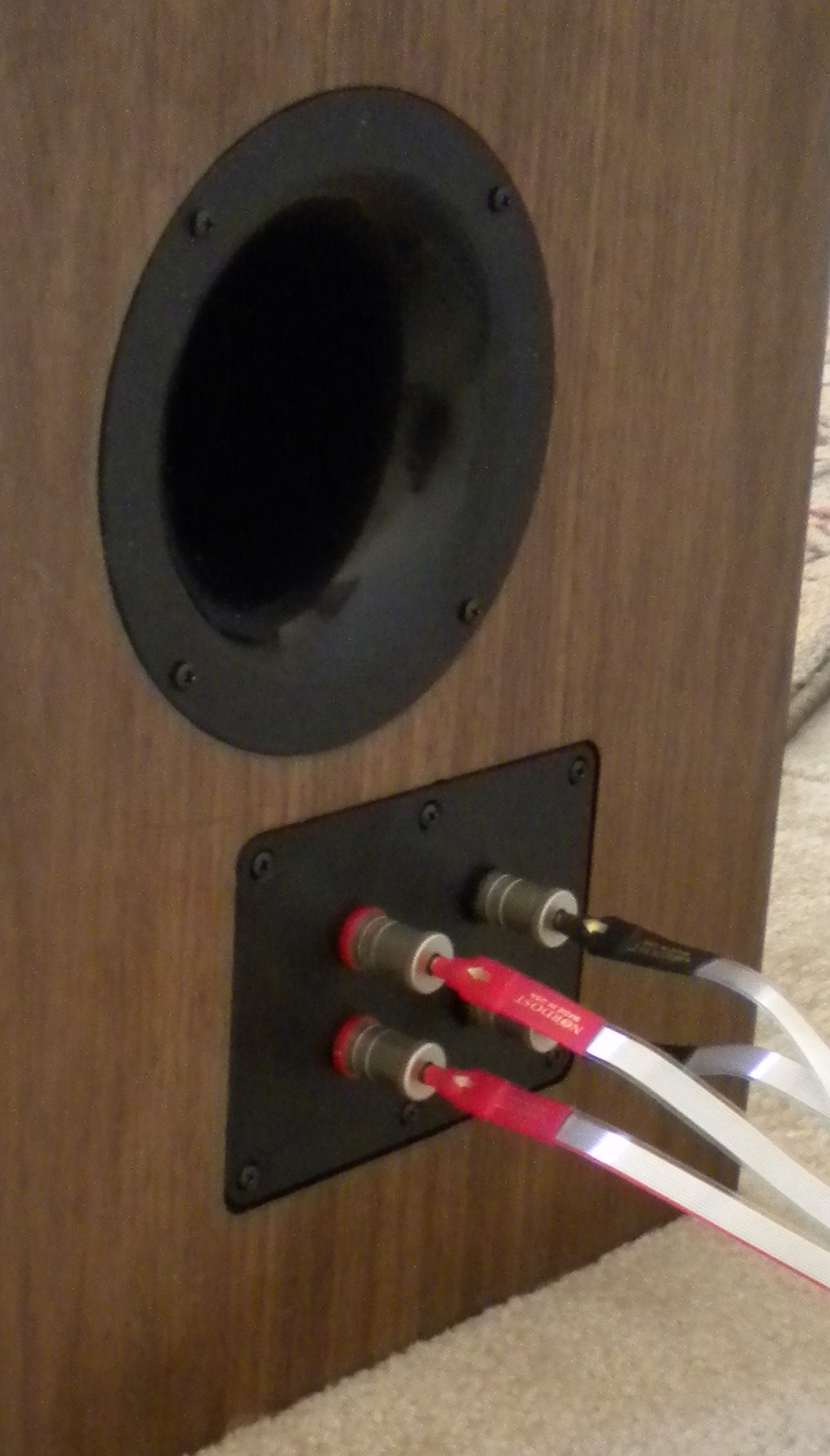

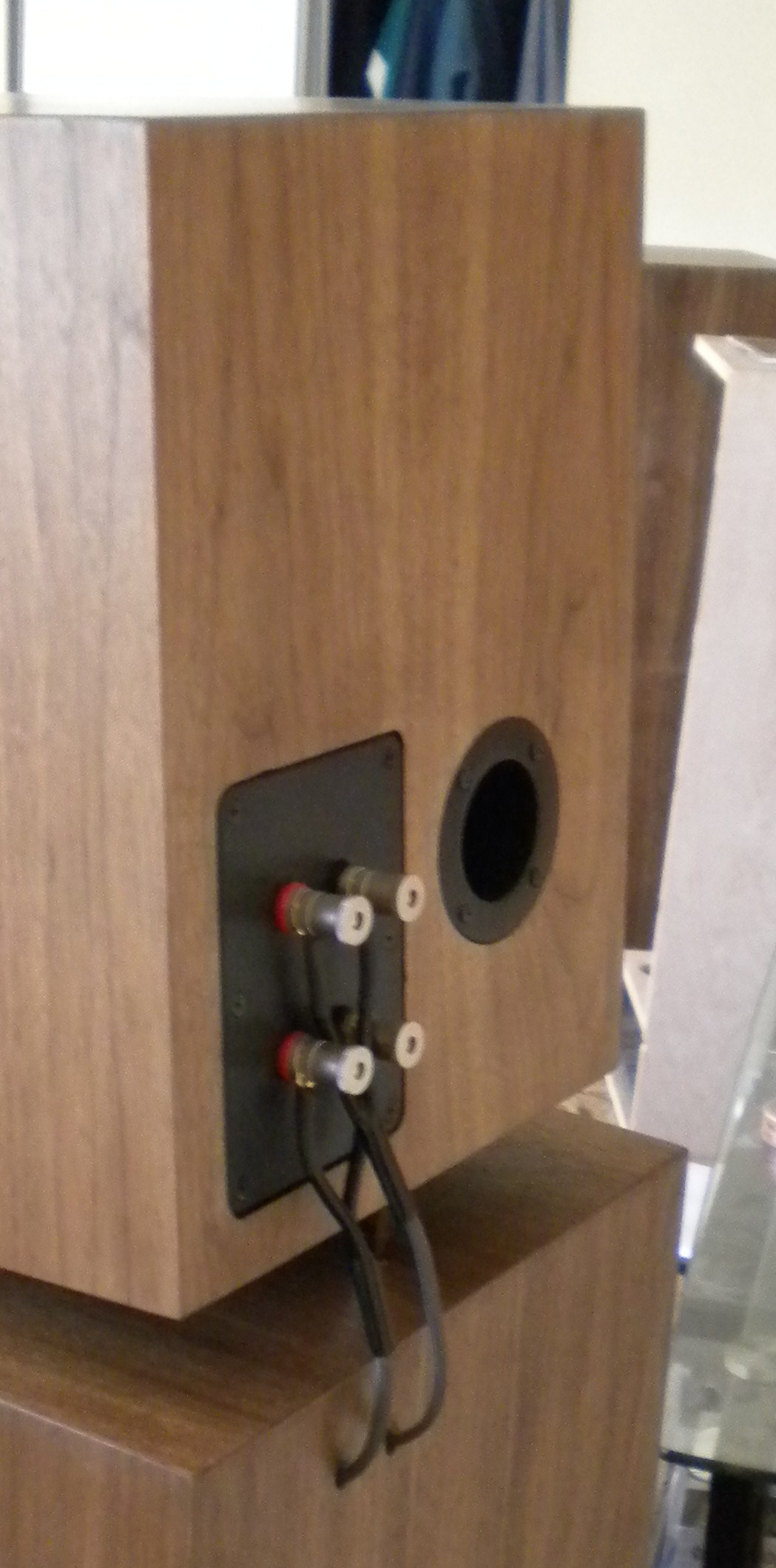

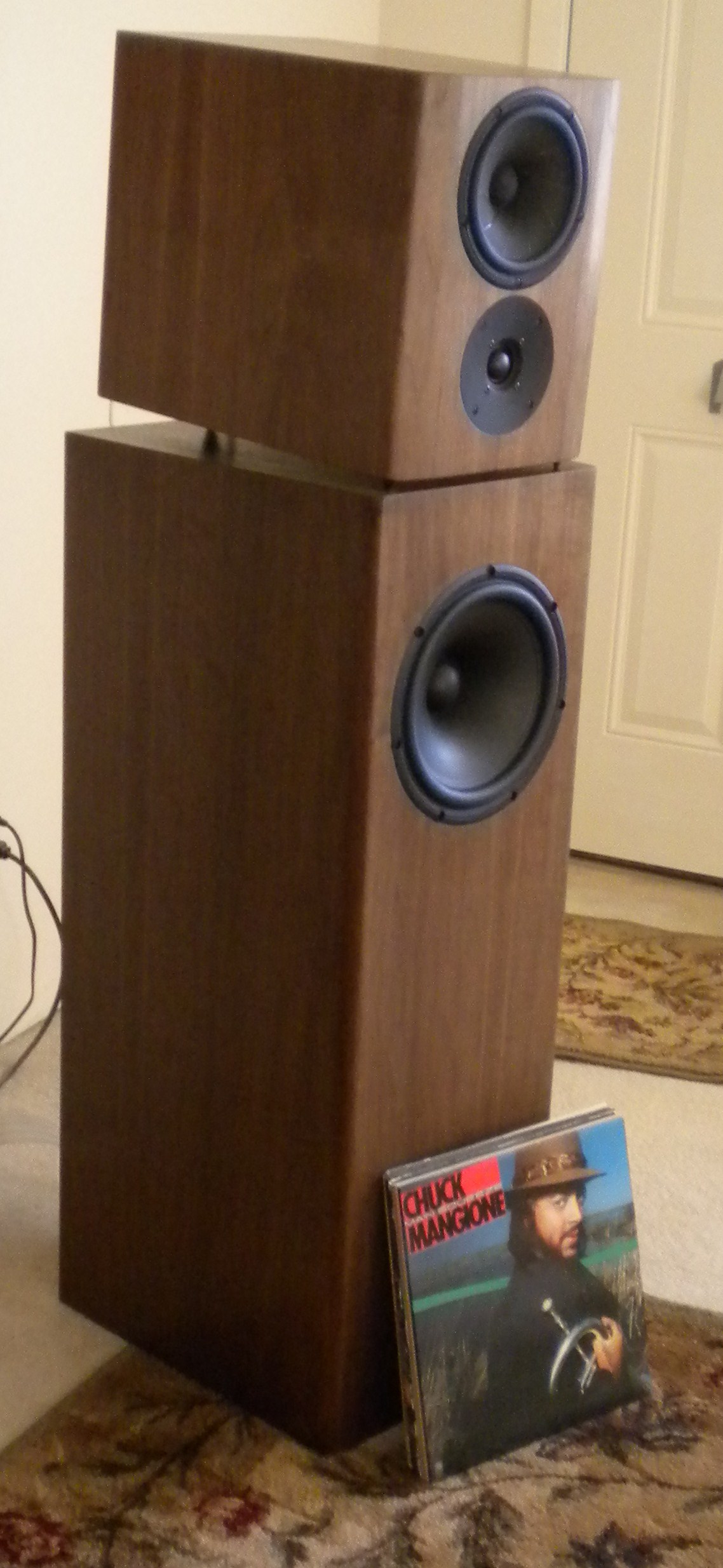

just finished 1st of pair of Jensen 1071. WOW -the SS 18W/8531 sounds euphoric as a dedicated midrange. Amazing bass too with 10" woofer and no-compromise box volume.
I deviated a little with bass cab dimensions (keeping volume constant) to fit 1 piece veneer for front and sides. I used 1 ohm resistor for tweeter R1011 -not 0.47 as per troels' OK. Boxes are premium birch-ply called "Pure-Bond" from Home-Depot. The front and sides are laminated to 1.75" with extensive matrix bracing. Damping is No-Rez and Acousti-Stuff. All coils are air-core. Caps are Clarity Cap PX,SA,ESA and MR and Jantzen Superior.
thanks Troels for a terrific design ! regards, tom

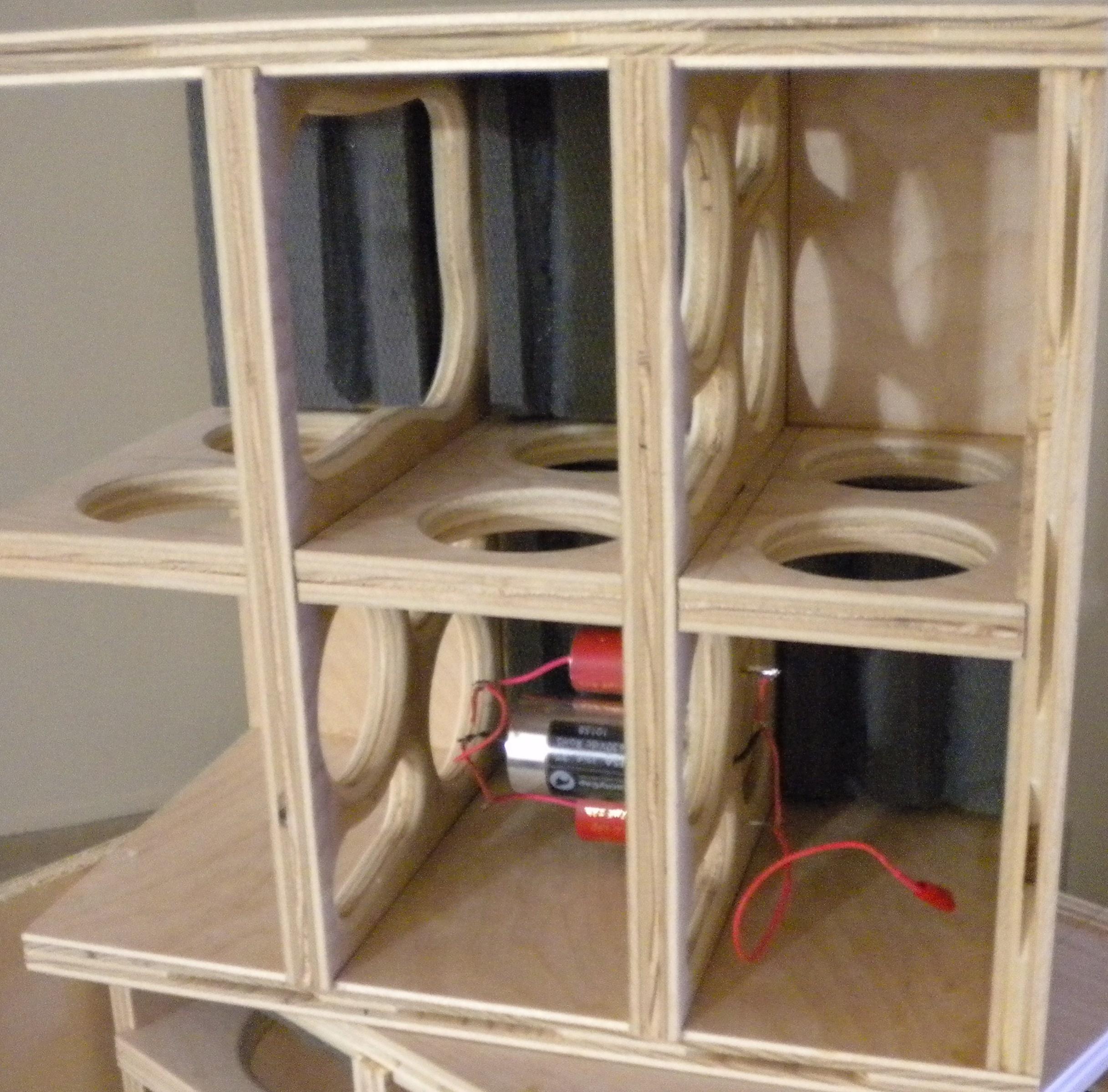

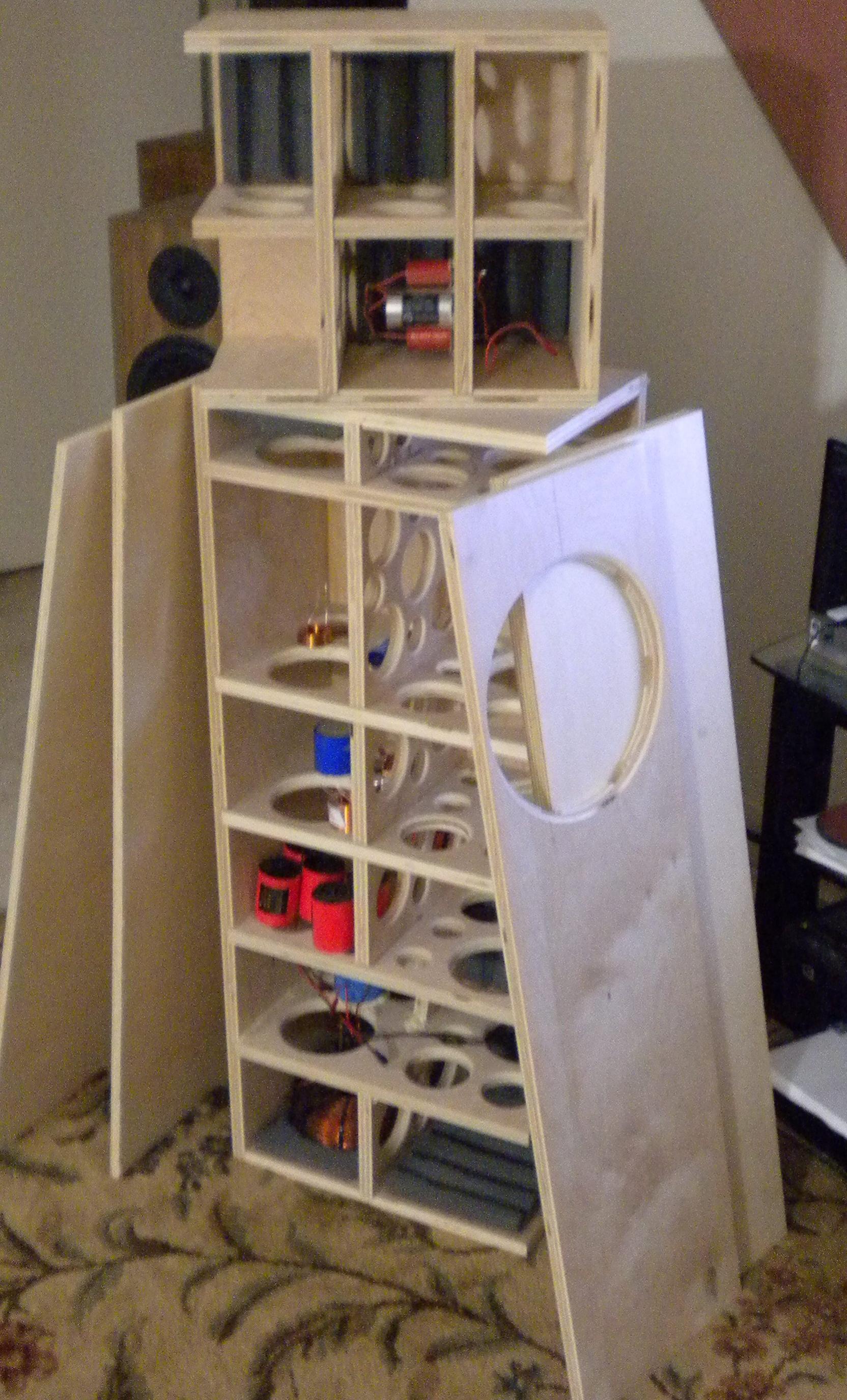

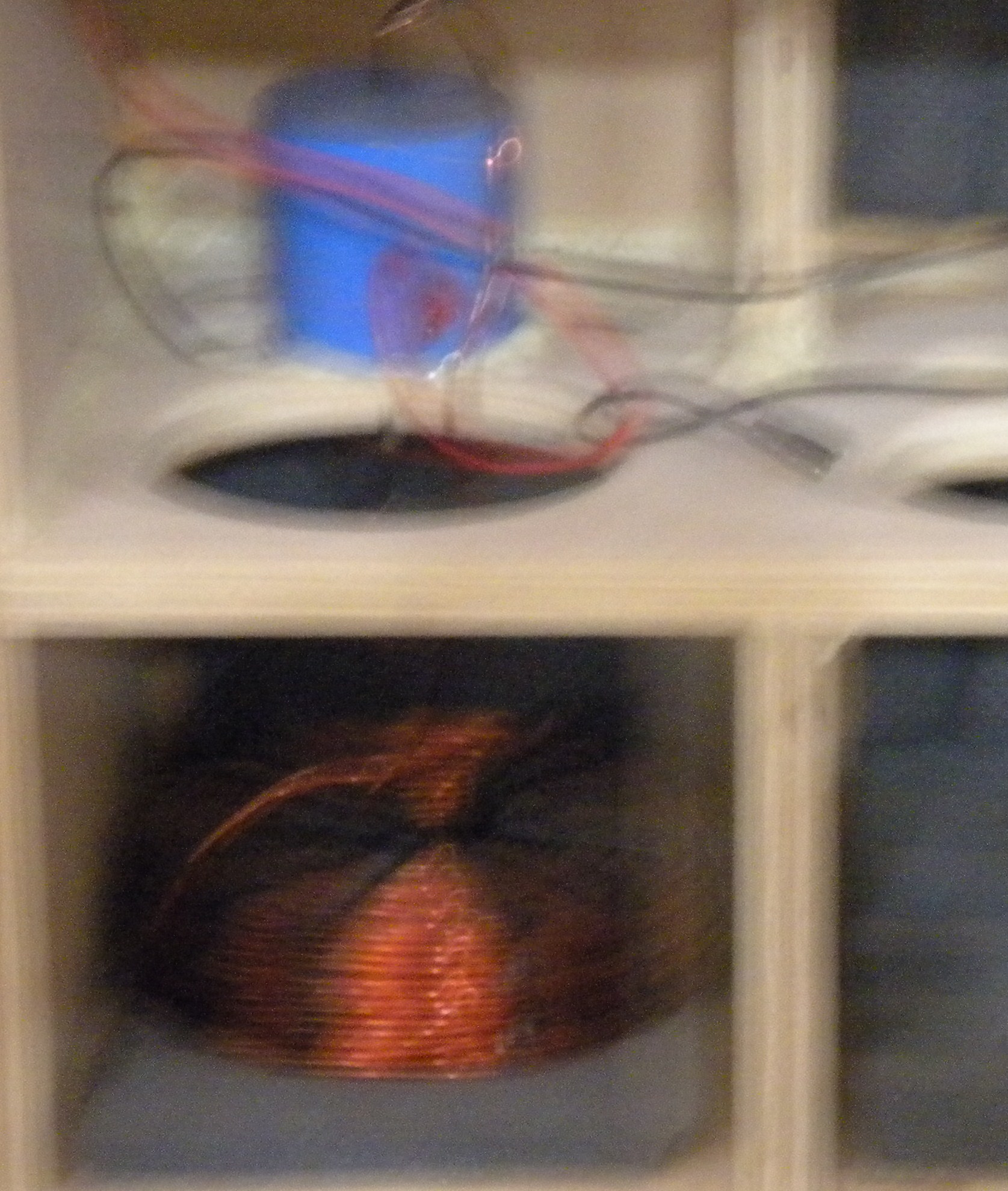

here are pics of progress so far with 2nd of pair. The woofer coil is mounted with 4 heavy gauge tie wraps through bottom panel. the rest of x-over parts are loosely placed just to give a rough idea of placement. the large caps and coil were accounted for during dimension calculations. the slots around panel perimeters are for biscuit joints. the extra panels are laminated on sides after inner shell is complete. I do all cut-outs AFTER veneering.
Glue used is Gorilla-Glue which allows plenty of application and assembly time before cured. also 100% waterproof. Enjoy, tom
