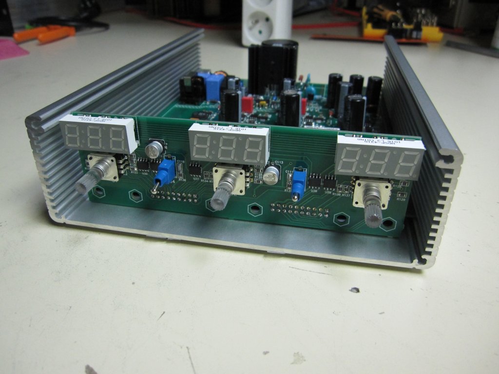

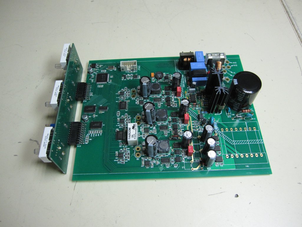

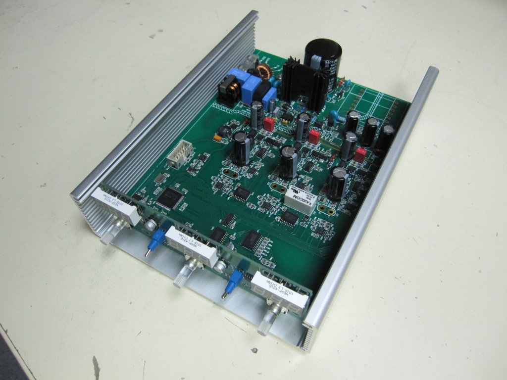

Because some pictures are more clear than a long article, below a picture of what should look like the front and rear panel, and one of the bare PCB (not wired).

Test in progress...
I have written a first software for test.
It allow to test many functions separatly and easily.
The PLD was succesfully programed with, and no big issue was encountered.
  • 7 segments display multiplexing is ok
  • Digital encoder's and leds are ok
  • U/I mux and A/D converter is ok.
  • All digital potentiometers (for setting V/I) are correctly drived,
  • All bucks work fine with approximatively expected voltage range.
  • Symetric control of outA/outB is ok.
  • Output enable switch is ok.
I will try to post a small video of the test program in progress this week-end.
I must work hard now next week on the final PLD program that will include many more logics functions...

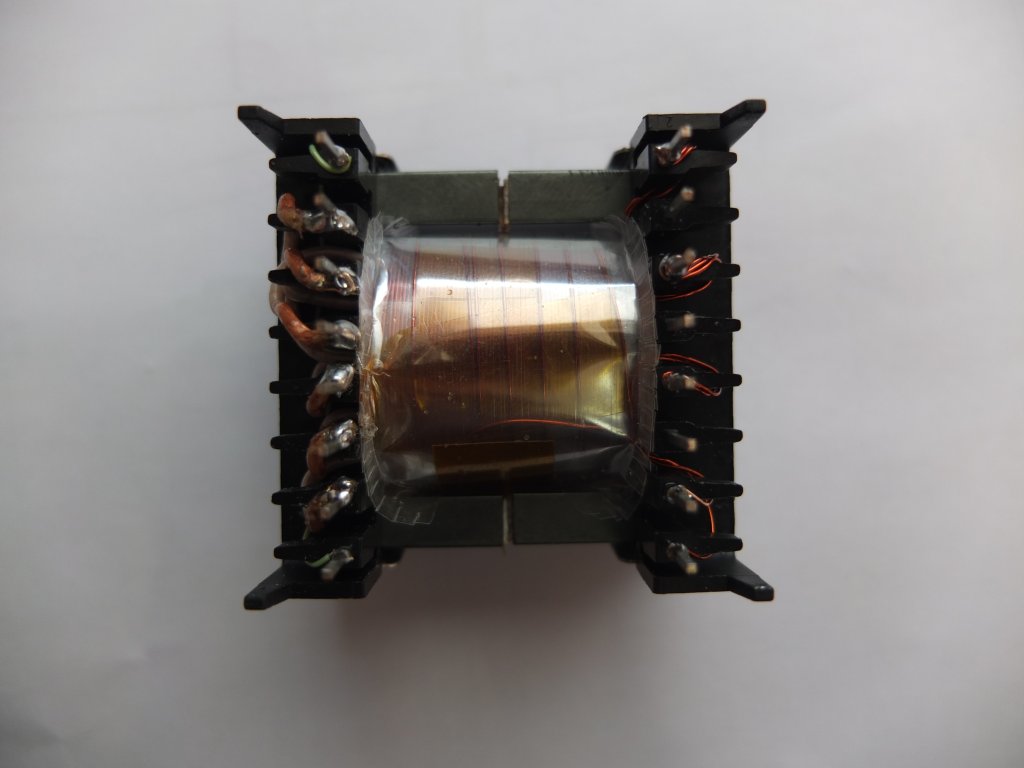

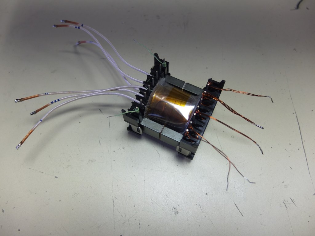

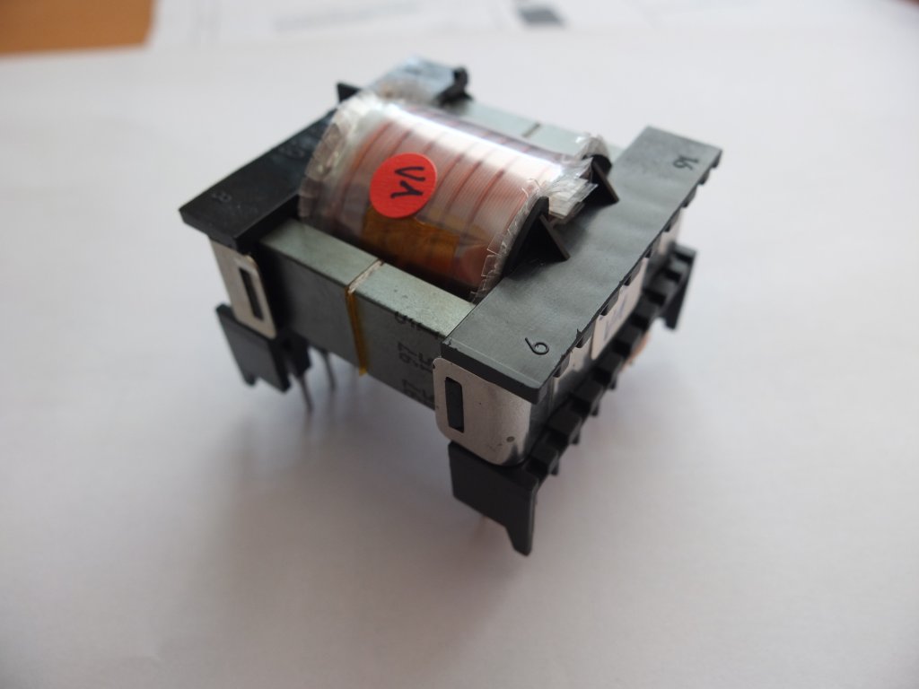

The flyback transformer prototype has been wound.
I test it's "real life" specs in the week with an "on the fly" test board.
The primary is split in 2 for lower leakage, and secondary windings are
winding at same time for maximum coupling.
I use Litz wires for secondary, but multiple small wire could work too.
In/out parasitic capacitances are neutralized with two copper shields between primary/secondary sides.
The shunt copper layer outside the transformer core that reduce radiated EMI will be added only
at the end( transfomer fully characterised).
