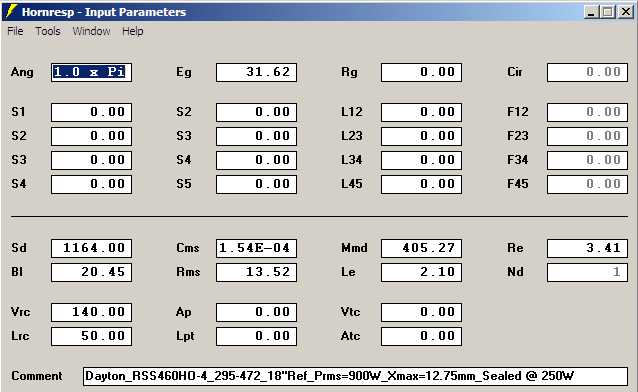

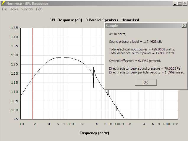

I tried this one in a sealed V_net=140L box in Hornresp. At the low frequency end of your goal: it takes three of those boxes (@ 250W ea.) to get to your SPL goal, assuming some room gain, and keeping the excursion below Xmax. It will take an LTC or some form of equalization to flatten the response.

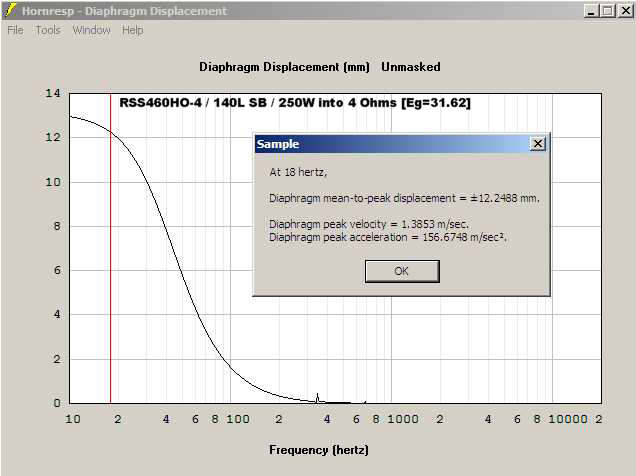

That model is at x-max?

Hi turbodwg,
Post #63: "...model is at x-max?"
It is at the very low end MedPed seems to be looking for, e.g.: ~~18Hz. Xmax listed as 12.75mm. So any power past 250W/4_Ohm in this relatively small sealed enclosure (140L) will exceed Xmax (power compression not taken into account). On the other hand, you might be able to do structural damage to a normal home even with two (one?) of these "beasts", and 500W.

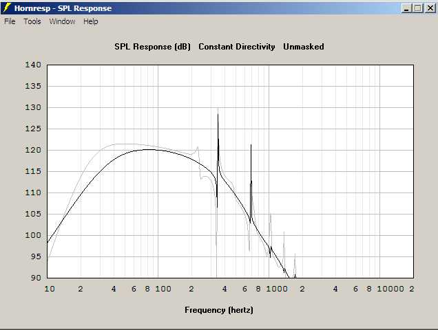

Post #74
Hi MedPed,
In Post #62 you'll find Hornresp Input/multiple sub SPL screens, in Post #68 you have the displacement graph; these are close enough to describe mRgSr's project (I'm not going to spend the time calculating the exact internal volume, this is diy after all :)). In his thread you'll also find my quick stab at a BR (vented/bass reflex) for this driver w/ the same external dimensions, Post #30: http://www.diyaudio.com/forums/subwoofers/221660-new-ht-subwoofer-dayton-ref-18-a-3.html .
I'll attach a SPL comparison for these two boxes. Gotta run......
P.S.: I would consider two of those "serious" overkill. :) Nice.
