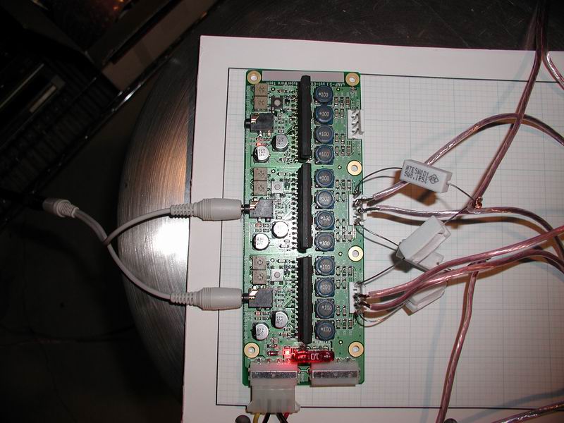

Done
Well, got all the soldering done and ran the TA202's in parallel. It didn't blow up. It did sound a bit louder...20 wpc to perhaps a 35 wpc??
The boards I have have six independent channels and I paralleled four of the six...see pic below. The board also has two mini-pots to control gain on each channel. I noticed if one channel gain was lowered at high volumes, that would take that pair (the TA2020 chip) into fault mode, while the other 2 channels remained operating, and needed to push the mute button to reset the fault. Must have been a reverse voltage trip from the overpowering of the other 2 channels.
Anyway, it sounded just OK. Seems that the sound wasn't as precise as regular two channels straight up. But this could have been my power supply gasping for more amps - as I noticed the individual chanel LEDs would flicker on deep bass notes. Also could have been the .1 ohm 5 watt wirewound resistor (all I could find) on the four + outputs. The negative outputs were tied without resistors, as I don't think it was required. Maybe they are needed....
Anyway, if anything this is encouraging. I still beleive this can be done corrctly to increase the power of these chips by 50% - 75%.
Anyone else want to try and post results? I don't think it will harm your amp. If the TA2024 faults out, you should be able to just repower the unit up to reset the fault...
I have 10 1 ohm- 1 Watt resistors I can try on all positive and negative channel outs too. Maybe tomorrow...
I will repost the results.
They are needed because of the differential outputs :att'n: I tried to explain that in my posts above but guess I didn't make it as clear as I thought!

Joined 2005
Will re-try
BWRX --> You said four resistors in your previous post, and from the LM3886 datahseet outlining the parallel mode, you only need to put the four resistors on the four positive outputs and the neg outputs go to ground resistorless ...
I will try again with all eight leads resistored. Looks like I will have to do the 1 ohm 1 watt since I am 2 resistors short of the 8 required at .5 ohm 5 watts......
Think the wire wound resistors vs the Carbon types would lead to a major sound difference? After all, carbon types are used in the amps and the wire wounds are used in the crossovers, so tthey are both audio worthy...
I hope it sounds quite a bit better, as I was disappointed in the test sound quality...

Joined 2005
After having all eight resistors on the outputs, the sound was a bit better, but I firmly believe my linear power supply is insufficient for these four channels.

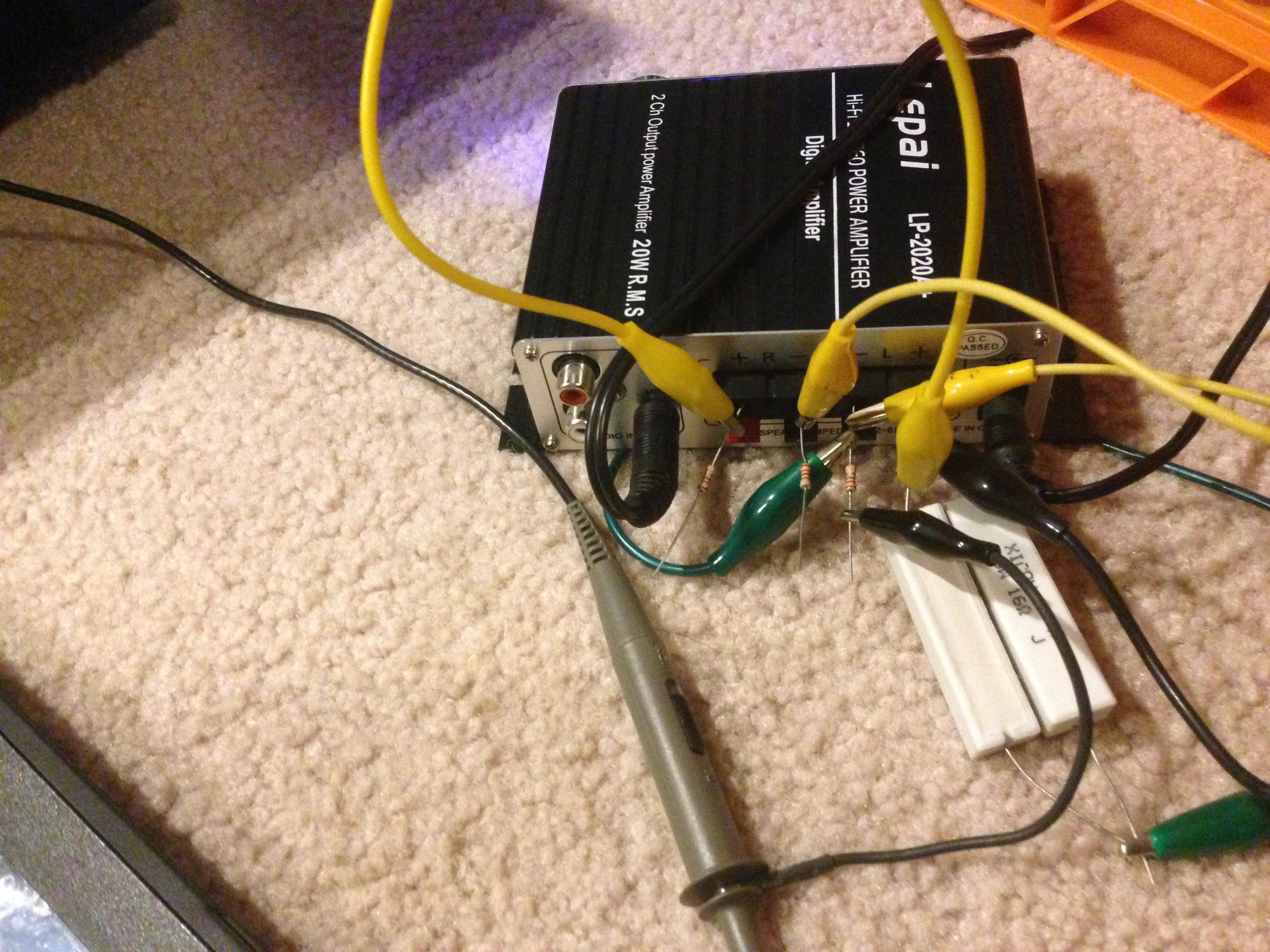

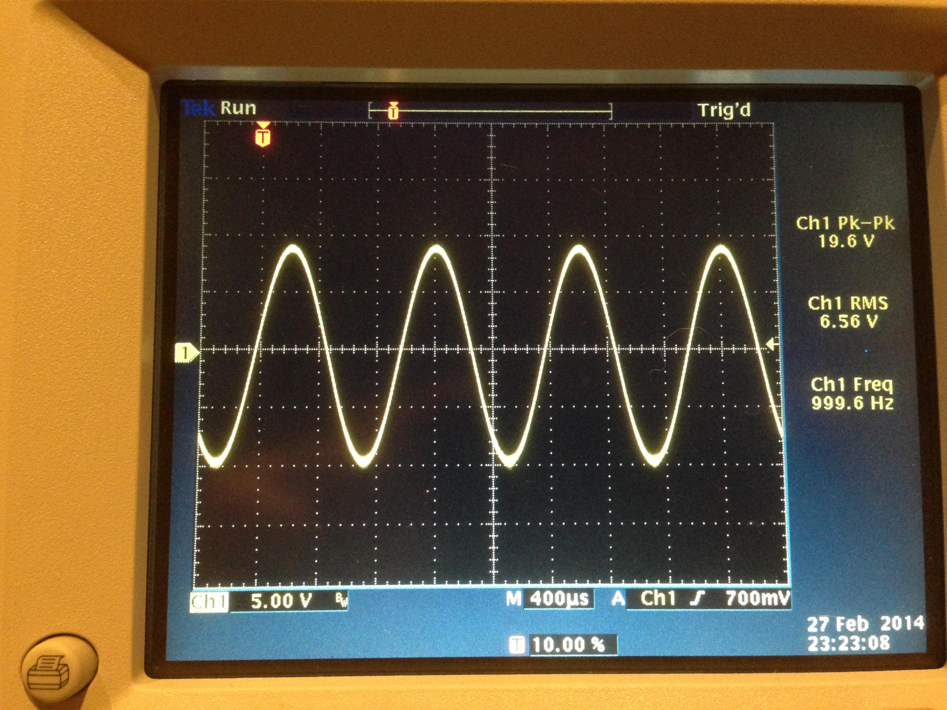

I just tried this last night and No. It doesn't work at all. You did not see any more power. The scope was floating and seeing the full output range into an 8 ohm resistor (2-16 ohms in parallel to handle the power). Stock supply was 13v, the bridged outputs generated a signal that swings about 20 volts (+10v from one half and -10v) from the other half..
RMS Power at 1Khz with the Stock Lepai LP2020+ with included adapter generates about 19.6v before distorting. Paralleling up the two outputs did nothing to the waveform.
I repeated the tests with a speaker and it was no different than the resistor.
The other thing I found was that you can only get about 19.6 pk-pk output = 6.93v RMS = 6.0Watts RMS into 8Ohms at ~1% distortion. This works great as computer speakers, but kinda sucks for my band gig rig..

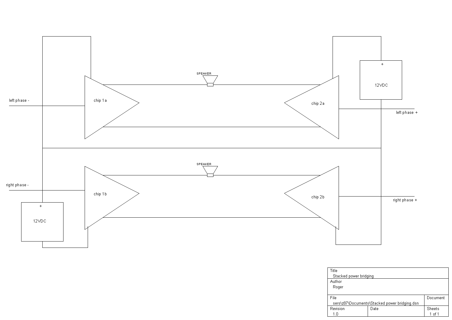

I think there is a way to bridge: bridged amps. It involves supply stacking...Or rather isolated supply stacking. The only assumptions is that the chips share/split the stack. The trick is common to TV transmitters. 50VDC supplies are stacked with there respective MOSFET amplifiers to generate killowatts into 50 ohm loads. I'm not suggesting you build a welder out of TA 2024 chips. But I am suggesting it might be possible to stack a pair for more voltage swing into 8 ohm loads.
Disclaimer. If you kill your friend/s don't blame me. It's just an idea I'm putting forth. I see ~$20 TA 2024 PCB at parts express you might give it a go. To improve crosstalk and dissipation (assuming it works) you might only use one side of each chip.
