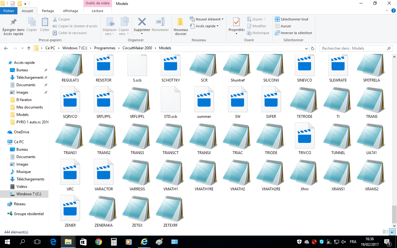

I found some models I needed and also found the explanations I was looking for. So I can save them in my circuit maker.
But: edit macro; Save macro, expand macro, and macro lock do not work. These positions remain grayed out.
Only new macro; Macro utilities etc work.
What can I do ?
What can I do ?
I simply open "triode.sub" with a text editor and add a model. Attached is my file with much more accurate models than the one above. Feel free to grab the ones you need.Hi,
What can I do ?
What do you mean by "cannot read it"? You can't open it in a text editor like Notepad?Many thanks
I have extract the zip but I cannot read it.
Forget the tutorial. Just copy and paste the models you want from the "triode.sub" I posted to the triode.sub in your "models" directory.ok groucho, I don't why I do not know why it did not work????
now what is the procedure for introduce the datas in circuit maker?
the informations in the tutorial circuit maker are grey and when I try to modify the existing datas, a window open with '' only to read ''
If running Windows 10, then that may explain problems re read only. To add data to TRIODE.SUB, I have to copy it elsewhere and then work on it with Notepad, then save and copy it back and over-ride the original TRIODE.SUB file. That worked for me. Now I can add new data to SUB files using that method, even remove stuff I don't want. Hope that helps?
Hello,
I sorry for my late response but I was missing + computer problems.
Yes it is Windows 10.
I do not find TRIODE SUB. Yiu can see on my copy the TRIODE that I registered in MODELS. That oes not work.
I dont find anywhere a ''SUB'' file in the Library or models...
Thank you for your help
