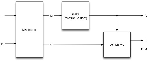

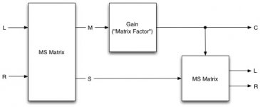

Wrote a little script for Reaper. The matrix factor can be varied with a slider:
Code:
desc: 2to3
slider1:0.5<-0,1,0.05>Matrix Factor (0-1)
@slider
matrix_factor = slider1;
@sample
l_in = spl0; r_in = spl1;
//create MS from Left/Right
m = 0.7071*(l_in+r_in);
s = 0.7071*(l_in-r_in);
//Re-matrix to Left/Right
l_out = 0.7071*((m*matrix_factor)+s);
r_out = 0.7071*((m*matrix_factor)-s);
//output
spl0=l_out; // Left
spl1=r_out; // Right
spl2=m*matrix_factor; // Center
Here's the schematic:
attachment.php

Anyway, I need to build me an extra speaker first :D
More people shoud do that, really ;) I think thy biggest hindrace of experimenting with matrix stereo is people ususally have only two speakers.

You should try coefficient of 0.5. It maximises the separation between speakers. Did I suggest it already ? :rolleyes:
0.5 is the default in my script...

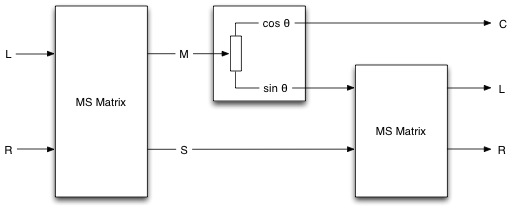

Here's my implementation of a energy-preserving 3x2 matrix decoder:

I'm not sure if the mid signal for the center (after energy preservation) needs to be attenuated by 3dB or not. Anybody?
Schematic:
attachment.php
