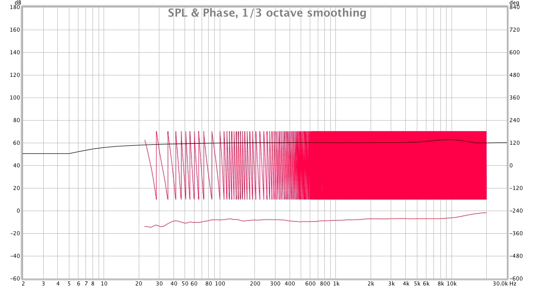

you mean THIS graph?
John, if you want people in here to take you seriously please post some real graphs, something that shows Efficiency, Impedance, Phase and Distortion would be nice, because, showing a graph of a "speaker" without "piston" like action, with no enclosure to avoid cancellations and that small surface area that is 4-5db down at 23Hz, well, defeats all the known and well proven laws of physics.

That same figure, which only demonstrated that whoever created it had no idea of how to use speaker measurement software.
At the risk of being attacked again, I will gently suggest that you get someone who knows how to do speaker measurements and has the equipment to do so to run an actual frequency response curve, and at different distances and positions. Maybe someone will take you seriously then.

I try (hard) to be open minded, anyone who knows a thing or two about basic speaker (sound emitting devices in general) operation principles and basic knowledge of physics will tell you just by looking at your design that AT BEST you have created a MIDRANGE, as it has too little surface area, no enclosure, no piston action to be a Woofer and it is to HEAVY to be a Tweeter, it's not surprise that anyone would come to the conclusion that your graph is, well, manufactured (for lack of a better word).
Again, you can't fight the laws physics and win, not gonna happen, at least not in our universe, sorry.

OK, may I ask what's the weight of the moving part of the Plannot driver?
Nope, sorry, wrong again.
In order to accurately reproduce AC waveforms as high as 20kHz you need to accelerate (and decelerate) the moving part as fast as possible, meaning very low mass, often a fraction of a GRAM, not a fraction of a POUND as the Planot.
As I said, you can't beat Physics.
