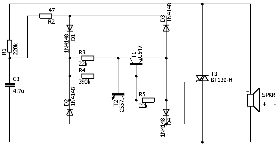

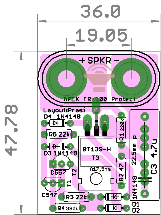

I'm going to try this one. If sits passively inside a speaker as last resort.
http://www.diyaudio.com/forums/solid-state/313651-speaker-protection-3.html#post5219563
My triacs just arrived today. They are not expensive.
I suppose one could even put a fuse at the speaker so that the crowbar sets it off.

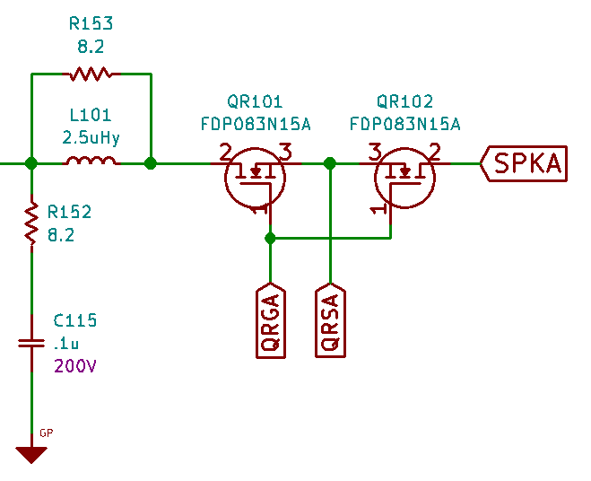

I've never used a crowbar type of protection, seems old fashioned now that we have good SS relays available.
Do you put a SSR in the audio path or do you switch the rails?
Joined 2009
I put the SSR in the audio path. Completely transparent.
Have you a schematic?

e.g. http://hifisonix.com/wordpress/wp-content/uploads/2012/08/Speaker-Relay-V1.03.pdf

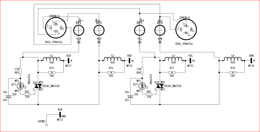

Yorkville uses this TRIAC crowbar circuit, across their product line up to 2,000W.
The SSR circuit looks good but the SPICE model does not include a real woofer's voice coil and crossover network inductance, several mH not 20uH lol. So I think the avalanche might kill the MOSFETs.

The primary purpose is so that I can measure current flow of each device in normal operating conditions. I am curious as to actual since ive never not used current sharing resistors. I can plug and unplug each and play around easier than soldering and unsoldering. I have considered setting up a circuit that can tell when one is not working and to again, in software, do whatever I want. This isnt really the priority though and will probably SSR the output via Paul Bysouth idea in post TGM 1i - an integrated hybrid amp inspired by Hugh Dean and as well have that sensed by the RPI. Have it email me if theres a problem lol. It will probably be some time before all that stuff is hashed out, so the individual fuses will offer that temporary security as well. Its this little detail of what final parts can go on the amp board before I get them made. Id like to have the amps nearest completion so that I only have to mess with the accessories attached to it, which can have many versions. In the end, i can solder wire each device directly to the power rail and simply have the two rail fuses. Fuses more for test and temporary security. Prototype
Back in the days when the linear power supplies were king. you needed a crowbar to save the load if the pass device on the supply shorted. Center-fired SCRs (symmetric gate feed) were preferred over edge-fired to prevent SOA failures due to hot spots from uneven SCR turn-on. Motorola had a line of SCRs for crowbar duty. I don't know that triacs would do the job properly.

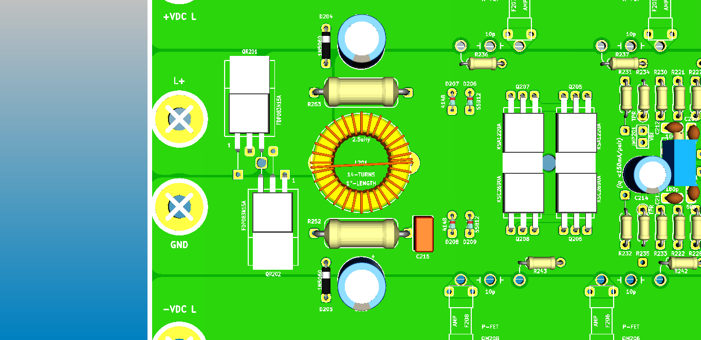

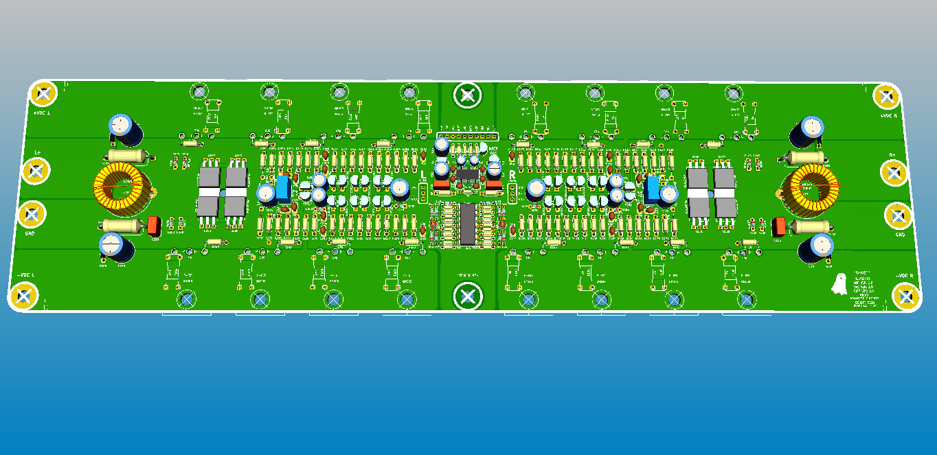

This is what I am probably going with..
Just the FETs on the amp board, control traced to a master pin header to the accy board. Forgive the silly 3d leads missing the pads.
As a note, Paul Bysouth claims that under test, when lifting a rail fuse, there's no pop associated. The signal just ends. Sounds like a solution to me.
My unknowledgeable fear is that since I am DC coupled DAC to amp, that I do not know the limits of signal reproduction and could possibly trigger a crowbar quite easily. Since I am in some uncharted territory for myself and doing my best to not ask too many questions, I figured this would also be a better way to allow adjustments and have some success without bombing it.
- triac's used as crowbar??
