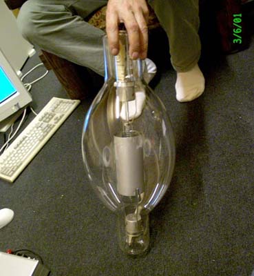

Then there's always the GM70, which AudioXpress has an article on about a year ago, and iirc, it was 30W. They are $US50 new from KW Tubes (he's on holidays till end of July).
http://kwtubes.s5.com/
Or the GM100. Now this is a man size tube. Almost literally.
http://www.vt52.com/diy/myprojects/amps/gm100/gm100.htm
Makes the 833A look like a pokemon

Let the boasting about size end here!
Yes I know and love the GM70. I'm currently building an SE amp that will run with 845's or GM70's.
The trouble with these biggun's is the heater power. Makes hum reduction a "non trivial" problem in SE. Still, it's lucky my speakers are not too efficient.
