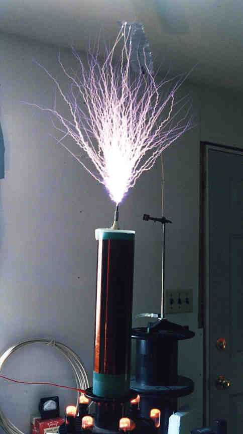

I used to wind a lot of tesla coil secondaries on a motorized arrangement that spun the coil form, stopped as needed by letting off the foot switch and by laying on the wire by a gloved hand. I found that I could NOT apply #36 wire no way, no how. The friction drag of the wire going over my finger would snap it. #29 AWG was nice to work with on the small 4 inch diameter by 1 to 4 foot long coils.
The bigger ones on 10-12 inch PVC pipe formers were wound with #18 polythermalese HAMT or #18 stranded. One was wound on a fiberglass pipe former at Hammond in Guelph from solid #10 AWG polythermalese HAMT on a big coil winding lathe with tensioner. I would have NEVER done this by hand feeding at that tension. One biggie got #6 stranded laid on by one hand as I rolled the large coil former on a shaft supported by two sawhorses. That didn`t work so well so off came all the #6 and got rewound with twice as many turns of #12 nylon covered stranded. My hands hurt just thinking about that job.

A little OT, but since you mentioned Tesla coils, I have a friend who is an engineer at Tesla motors, and I am hoping one day soon to have a chance to test drive that electric car. I am into more than just the Audio hobby.
In Seattle, near where I live, some fellows in a club called "Weird Science" set up a very large Tesla coil in the basement of a home. The discharge ball at the top of the coil was near the ceiling. After experimenting with it for a while, someone smelled smoke. They had to tear into the ceiling. Induction from the Tesla coil had set the aluminum foil backed insulation on fire.

Been there, done that. It was my first fairly large coil and I got carried away with the awesome phenomenon I was experiencing for the first time. Fire got hold in the ceiling while I was sleeping. I was incredibly lucky that I woke up and smelled smoke. I lived. That is not a mistake you make twice. After that the coil went outdoors to test. Threw an 18 footer first light! Yeah, it was a bit too big for my living room lab.
