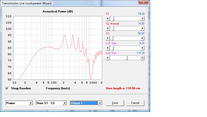

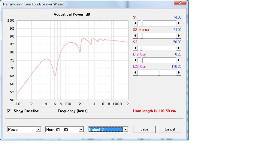

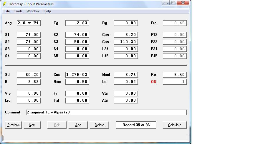

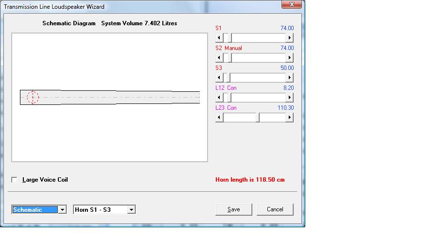

HornResp Model - Existing TL
The TL has a simple taper and offset driver, there are no abrupt changes in cross section. So we can model it as a simple 2 section TL, which is good cause HornResp only does 5 sections max and no curvy things. The driver, taper, cross section and length will determine the performance. Bending is convenient but won't "drastically" change the prediction, same for damping.
I've put the non-damped output curves for both the driver and the port below that way you can compare them to the nearfield measurements you took. HornResp is not accurate for higher freq so compare <500Hz. Look at where the peaks and dips occur, they are the same as your TL. The magnitudes are a little larger because you don't have perfectly reflective even walls (real world). Your TL is working as designed, put the saw back in the case ;)

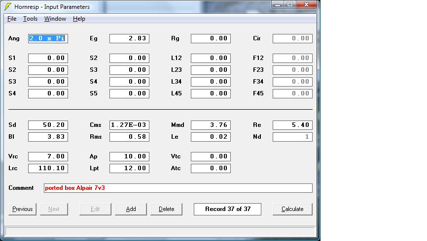

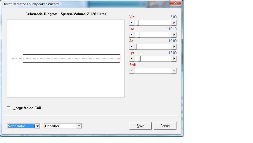

But can you make it into a Bass Reflex ??

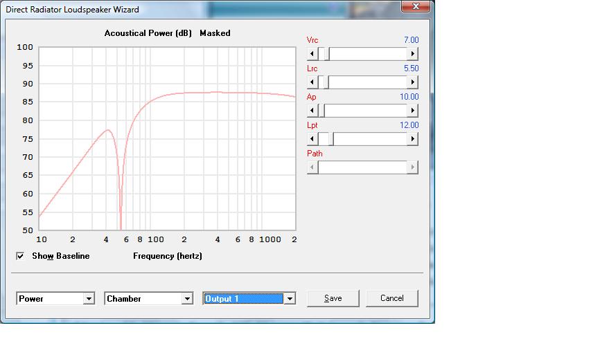

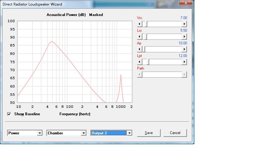

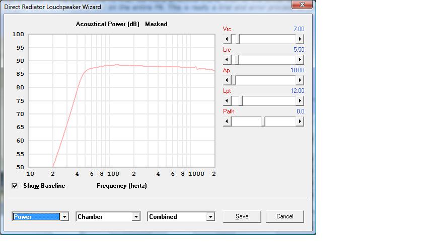

A comment came up earlier about making it into a Bass Reflex. Hmm,... wonder if that's possible. Well it turns out you can. The entire internal volume of your TL is 7.1L (5x13x110cm), that's enough volume with the right port. The right port is 3.6cm dia x 12cm at the end of the TL.
Take a block of styrofoam (don't scratch the wood) and make it a tight fit (jammed) in the mouth of the TL. Then place the pipe (3.6cm dia x 12cm) in the center of that styro block, assuming you've already made a hole for it. If you suspect air leaks use painters tape (green or blue) to seal the pipe and edges of the styro. Presto, you can test (ugh!) and compare the sound to a TL without commitment. Notice, the saw is still in the case. :eek:
The pics below show a long BR with the driver output, port output and combined output.
