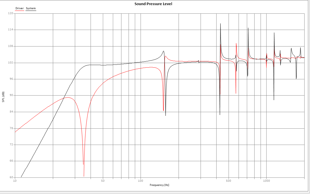

Maybe you could go a bit lower.
  • fc8.zip

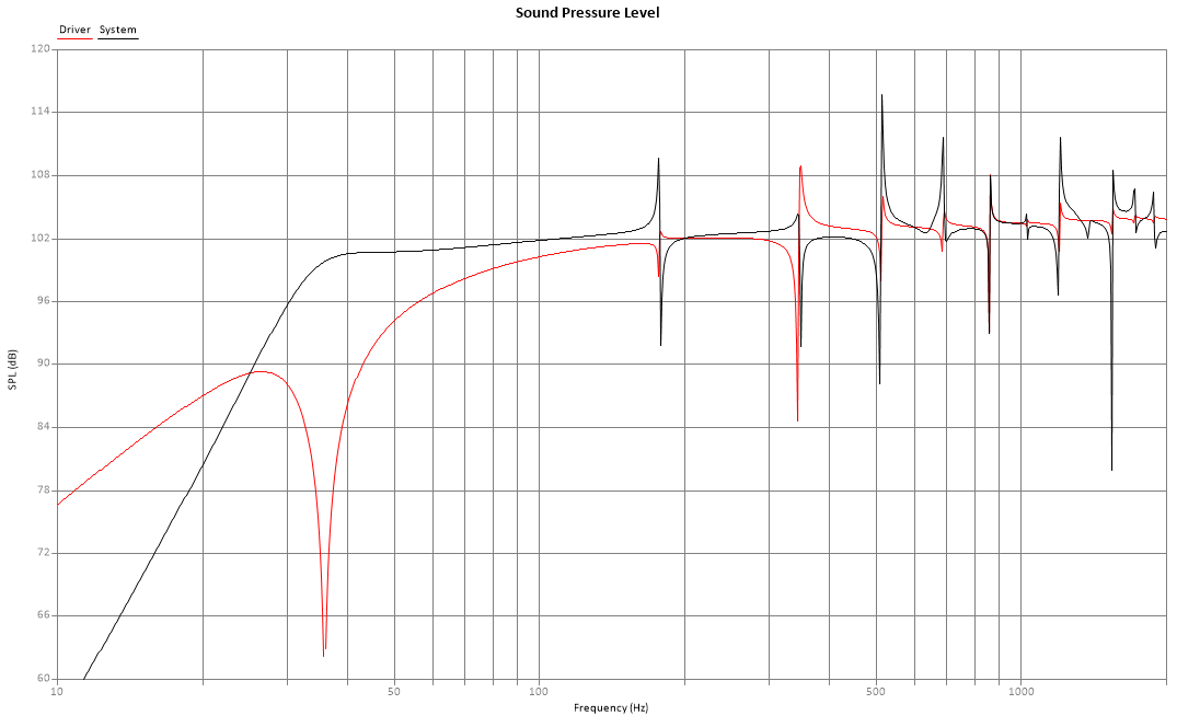

You can fold it.
I would want it even higher. Driver is too low as a floorstander. It should be around 1 meter from floor, if you are sitting.
But I don't know how you plan to use them. You can optimize them to fit your needs. If you don't need it tall, bass reflex (shorter and fatter) might be a better option.
What about this (it is below 40" and has weaker harmonics):
  • 2.zip
Thanks for the suggestions Lightbit. I think I am going forward with the 40 inch straight line. Easier to build and driver center being at 81 cm, bit higher as my current midrange driver, will suit my needs I guess.
Only thing I need to decide is width, as the FC8 is already 220 mm (8.7 inch). From an easthetic opinion, I think 11 inch internal width (12.5 external) will look other than usual.

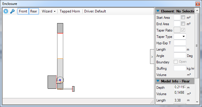

LATL app was working fine, but today, I have a bug.
I didn't update anything in my computer, all automatic updates are supposedly turned off, and yet, today, It came up with an error window, and since then, it doesn't want to draw the enclosure in the enclosure window. Only shows the driver, but can't get an enclosure.
I tried restarting the computer, opening saved files I know were good.... no luck.
I'm stuck with no enclosure.
I tried re-installing everything, still no good.
Any help?
Thanks!

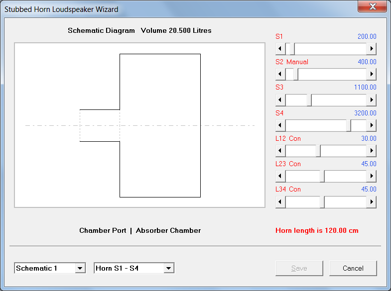

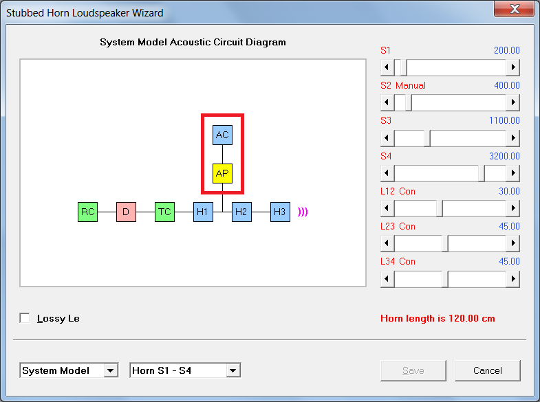

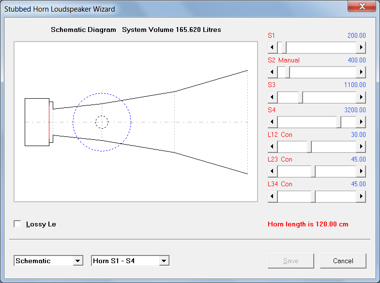

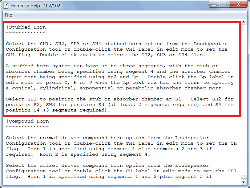

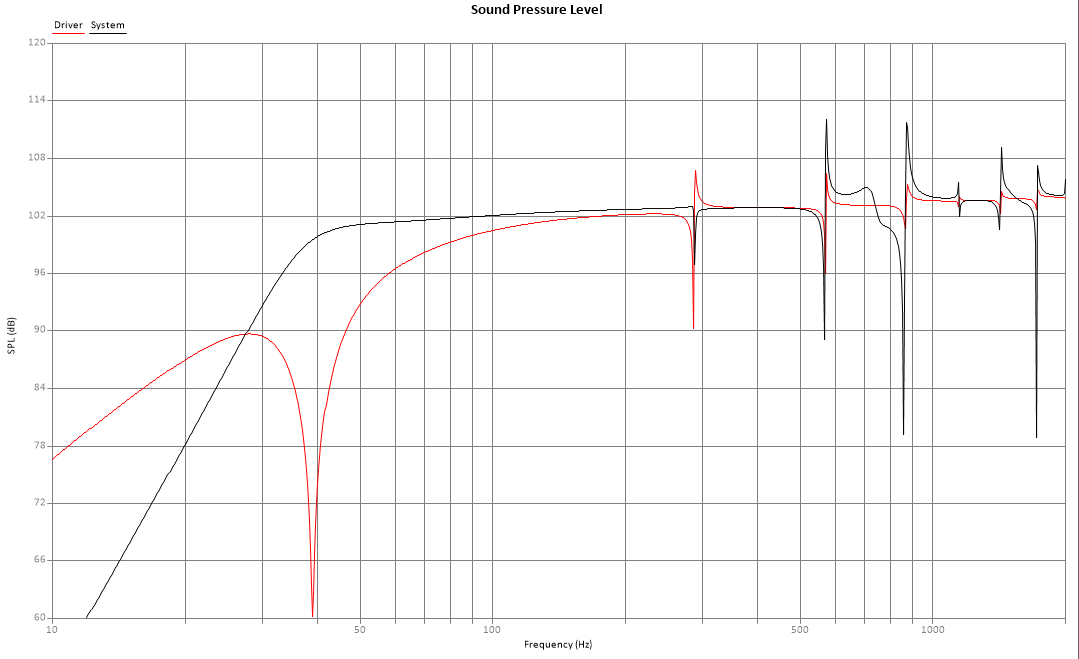

David, is it possible to add into Hornresp an ability to simulate Helmholtz resonators like on this picture?
It is currently possible to specify an absorber chamber using the stubbed horn (SH) model, but that is as far as it goes. I have no plans to take it any further - the inputs are messy enough already, without making them any worse :).
