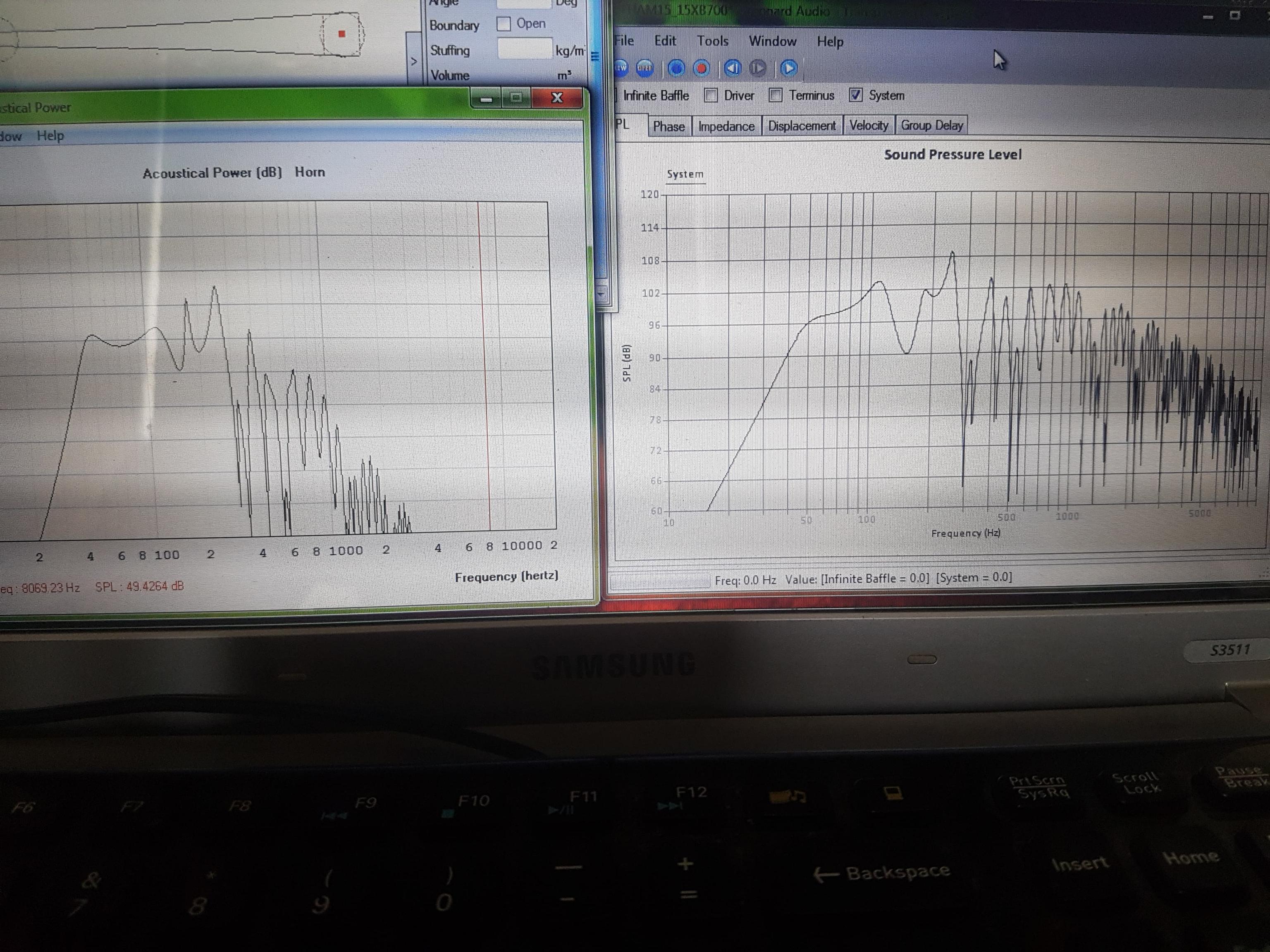

So im wondering about the difference in output between this and Hornsrep. Im modelling a THAM15 using an Oberton 15XB700, modelling the different sections as given by Martisson.
The differences I get are shown in the attached photo, with a noteable +5dB bump at 110 Hz. As I have no way to do a real-world measurement I have no way of assessing which is more accurate but I would be very curious as to why these differences may be in terms of the response derivations and assumptions used by both programs...?
Any help would be appreciated to aid in further simulations.

Huh! Isn't that special.........haven't done a TH.
OK, did a sim and when I do a bit of damping to HR's it's 'close enough' for me to the LATL's as these alignments don't match up to sims all that well anyway, though with the caveat that for whatever reason the LATL plot appears to be reverse phase [see my sims]. Change the extension on the 'Default TH' file to tlp.
All that said, I think I'll stick with HR for THs.
GM

The tapped horn model used in the Transmission Line simulation software is not correct - see Post #527 linked below:
http://www.diyaudio.com/forums/soft...n-line-modelling-software-53.html#post3744415
