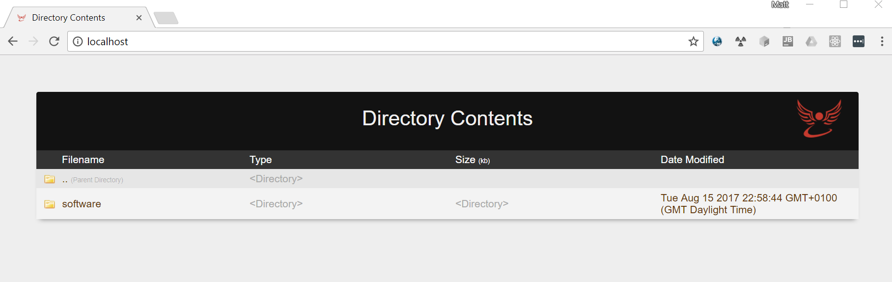

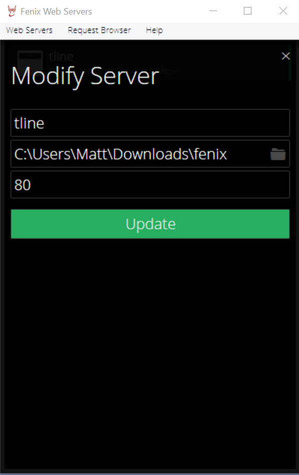

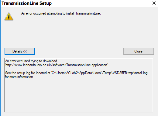

bit of a roundabout hack but I tried it on another machine and it installed ok
I am assuming no prior knowledge of webserver configuration so tried to make this simple....
1) download the attached zip (which contains a few files culled from my local installation of this app)
2) extract the contents to some directory, I used C:\Users\Matt\Downloads\fenix and you should end up with a directory in here named software in which you will find a file named TransmissionLine.application and another folder named Application Files which contains another folder named TransmissionLine_3_6_3_5 (which contains some other files inc the exe itself) NB: this zip contains the files the installer wants to download, the full list is shown below
3) configure a webserver to serve this directory on port 80, I used fenix webserver to keep it simple for windows users so instructions for that follow
- download & install it - Fenix Web Server | Static Web Servers for the Desktop
- go to the Web Servers menu and select new
- give it any name, set port = 80 and pick the directory you used in step 2
- click start server
- check it is working by opening another tab and entering localhost in the address, you should see a directory listing like
4) edit your hosts file to repoint leonardaudio to your PC, this means open c:\Windows\System32\drivers\etc\hosts in a text editor like notepad (as an administrator) and add the following line
5) check this worked by going to the same url (leonardaudio.co.uk) in another tab, it should show the same directory listing as in the last pic from step 3
6) run the setup.exe posted earlier, it should now install the app normally
