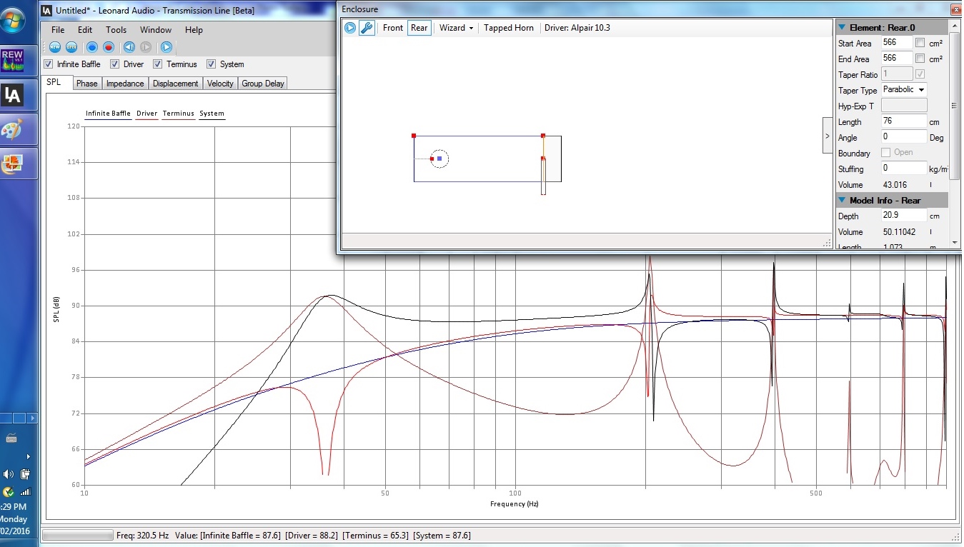

Hello, need some help. I have entered the parameters of the Alpair 10.3 for a ported enclosure, but the spl from 0 to 500hz just shows a mountain shape? nothing beyond 500hz. I have checked to make sure the specs are entered properly, but I must be doing something wrong. I think it must be the way I am entering box dimensions and I am not doing it correctly. This is for ported enclosure. My external box dimensions are H 863.6 mm, W 203.2 mm and D 279.4 mm. Vent is W 76.2mm, L 209.6 mm. I have done this in Bass Box pro and wanted to enter the dimensions into the Leonard Audio program to find the best Driver and Port (port is on front baffle) placing as these can be moved up and down on the baffle, which can't be done in BassBox Pro. Any advice would be great, thanks.
Hi
I did a quick simulation using your data and came up with the attached frequency plot. The driver is 15cm from the top and I have placed the port about 10cm from the bottom of the box. I assumed a square port because you gave a port width not diameter.
Robert
Robert
