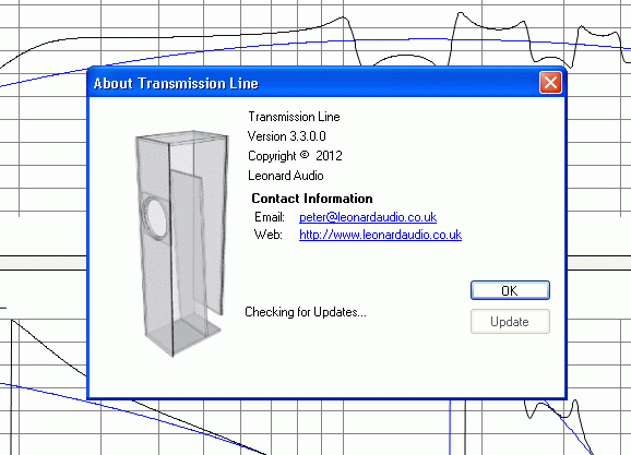

Please be aware that this software is in development, so any releases posted on the leonardaudio site are 'alpha' releases. That is, everything is subject to change, and there may be crashes and bugs. Hence, writing help files at this time would be a bit premature.

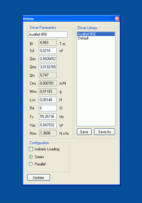

The program comes with a default driver loaded, but likely the first thing one should do is load the parameters of a driver you want to use, and then 'save' it. To do this, go to 'Window' along the top, and then select 'Driver'. Rename 'Default', then enter the driver's parameters in the white fields. Click 'Save', then click 'Update' to see changes in the SPL (and other) graphs. Things will go wacko, as the enclosure isn't meant for the new driver.
BTW, clicking on any of the measurement units will cycle through choices. For instance, you'll probably want to change Vas to liters or cu ft. (Same thing works in the 'Enclosure' window)

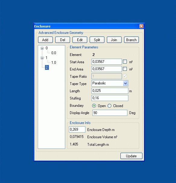

Otherwise, the best approach to become acquainted with the program and TLs is to change the existing parameters, and see what happens. Open the 'Enclosure' window, click on the '0' in the tree window to select it, and then alter the values for the 'Start Area', 'End Area' or 'Length'. Click on 'Edit' to save the changes, then 'Update' to see the results in the graph. If you do this systematically, you'll get a feel for the differences these three things make in TL design. Then you can move on and try 'Stuffing' and 'Taper Type'. These make less of a difference, but can be used to tweak the design.
To start, ignore the squiggles on the right of the SPL display (pipe resonances) and concentrate on getting a smooth, deep, roll-off in the bass.
To try the 'Add', 'Split' and 'Branch' buttons, open the 'Geometry Viewer' window so you can see how they work. They will add or divide to make more elements part of the cabinet. Click on the numbers in tree view to access their values, and again, play with them to see the effects.

Also, software 'settings' (Units, graph axis etc.) all get reset to the default upon installing a new update. I'm looking for a way to get around this as its quite annoying.

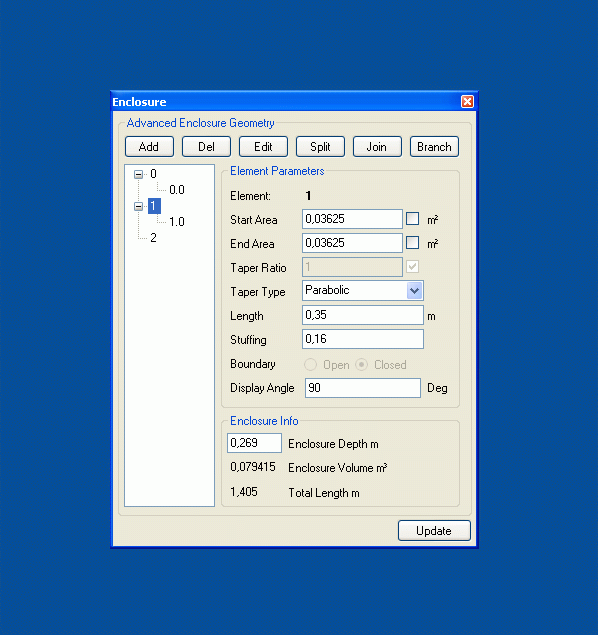

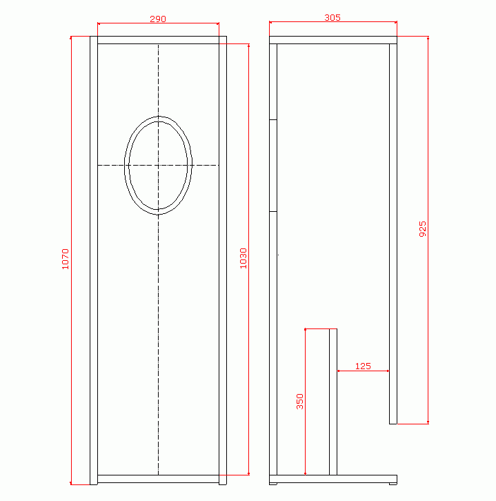

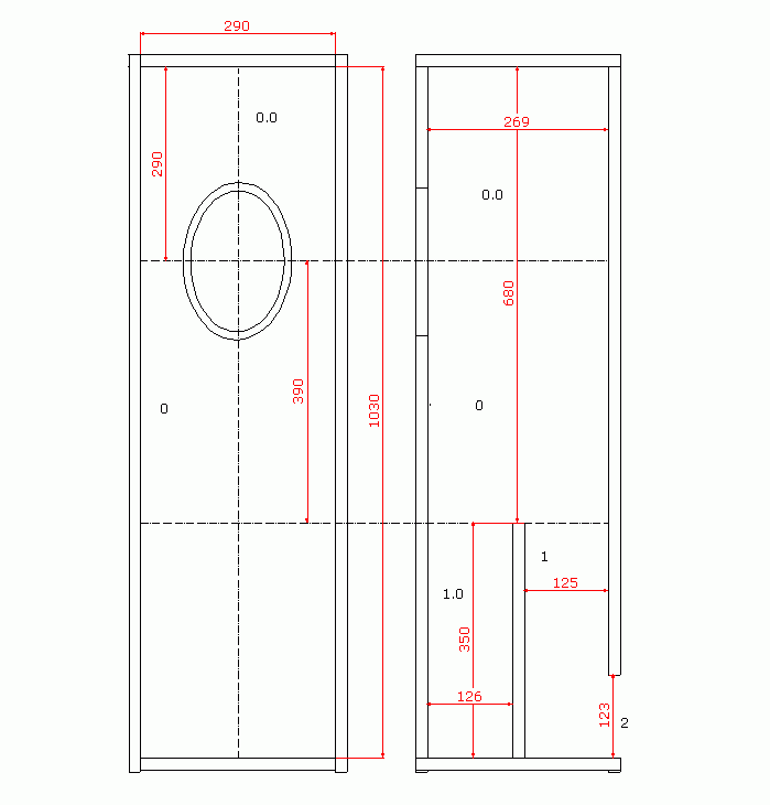

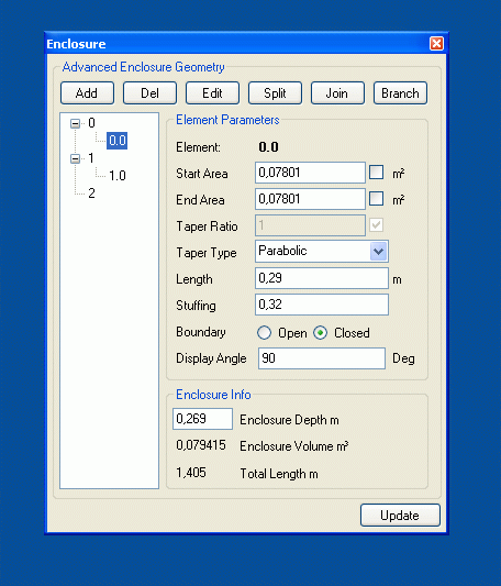

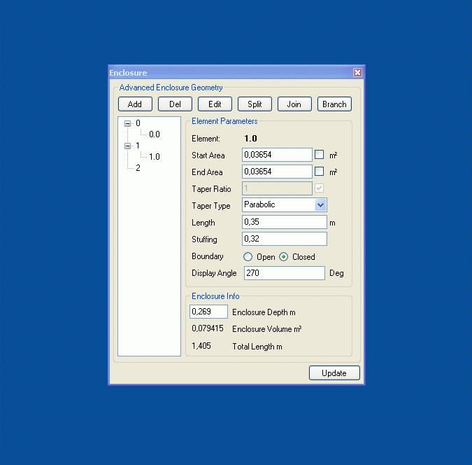

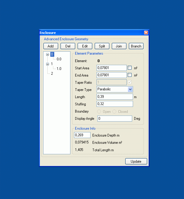

Hi, this is just to check if, finally, I'm doing the right way with the advanced version.
Hopefully will serve as worked example for other people too..
Does not matter if it is a good design or not, but if the fisical object is correctly translated to the program representation.
Included files are: the design dimentions, with the element names pictured in, and the "carpenter" or actual panel cut dimentions, as well as the program project file, ready to run (you must delete the ".doc" part , of course.)
Hope someone can point me If I made mistakes, or if everything is Ok
Many thanks

Thanks! I'm happy I'm able to use this powerful tool, can do a lot of things, not only transmission lines...
