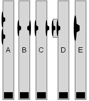

Do you mean the following with "TransFlex"
The FB1 (Floor Box 1) project started out purely as an experimental modification of the highly successful TB1 (Tiny Box 1) nearfield monitor. Designer Pete Thomas hadn't been able to try such a small bass driver in a true transmission-line system before, because the TB1 used a hybrid arrangement which he calls 'Transflex' -- a combination of reflex and short transmission-line elements (see 'The Transmission Line' box for an explanation of these designs).
http://www.soundonsound.com/sos/feb00/articles/pmcfb1.htm
- When reading the whole article I conclude that TransFlex is less good than a real, well designed, transmission line. And for me the meantioned dimensions are not an actual bottle neck. TransFlex as mentioned above sounds a little bit like, I wanted a transmission like, but needed more boom, so I builded a reflex in parallel. But that of course doesn't have to be bad, bacisly you have more to tune. Note that the HelmHoltz resonator I refered to, doesn't have an external port.
Next to that I think I found the statement you quoted on the following site:
http://www.geocities.com/rbrines1/Pages/Quarter_Wave_Resonators.html
- Clear story and all in agreement with my current thinking. Not straight, woofer not at the end of the line and stuffing to damp higher orders. But how about two units, as far as I understood, damping is not needed any more?!?!?!
What do you think will work best:
Hi Caratje,
I think B and C are the best, B for less magnetic interference and C for less distortions.
If you want a separate TL subwoofer (<80Hz) you need a long, unstuffed line and proper driver (very low Fs, Qt=0.3-0.4). And think of folding such a long tube.
Things like: tapering, stuffing, mass loading, etc. are for mid bass accuracy (80-600Hz) when the TL is part of a full range box.
Concerning Transflex I mean as it's defined in Jensen Technical Bulletin here:
http://www.diyaudio.com/forums/showthread.php?s=&threadid=70291
I choose a strait TL sub because of available tube and drivers, simplicity and need to rapid test it's potential. You can see some picture of it here:
http://www.hi-fi.ro/fhifi/viewtopic.php?t=5278&start=30
Now, I've got the courage to make the next step in TL design.
Hi Dorin,
Don't you think A will have a broader optimum, with two unequal offsets? (given MJ King's modelling) Or you assume that simply more pushing power at the optimum offset is more important/effective?
Tappering not needed? Hmm, that also sounds like I can also go for Bass reflex or closed box design...
I have also seen a subwoofer design which was basically using two separated TLs with slightly different length/offset. That was very big, as long as air is lineair I think I can combine them in one TL using different offsets.
Best regards,
Caratje
IMHO variant A with offset is good as long as you think about midbass.
For a real subwoofer the offset has no meaning, plus those two drivers are working in different conditions and could not be used to mecanical summing of left&right channels (what I wish I do with a pasive TL sub). Look here what I mean: http://www.visaton.com/english/bildgross/584_bweiche1.html
