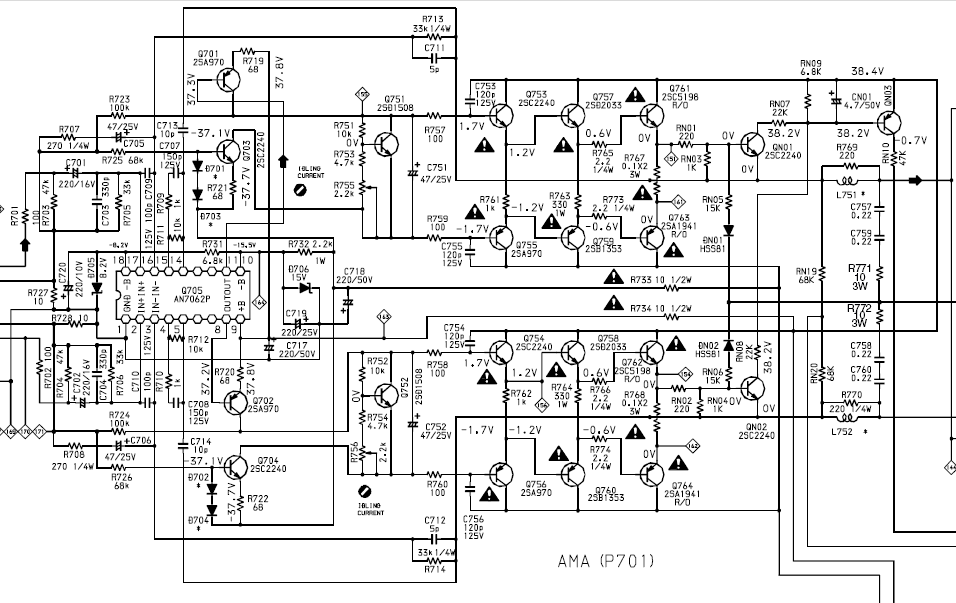

I am about to rebuild one channel of an amplifier (left side works but the right doesn't). Given the inaccuracy of transistor gains, and the fact that I am changing about 10 of them, am I likely to end up with anything useable let alone of equal volume both sides?

No, you should be fine. You really should match the differential pair. The overall gain is set by the feedback network - no worries there.Given the inaccuracy of transistor gains, and the fact that I am changing about 10 of them, am I likely to end up with anything useable let alone of equal volume both sides?

I'm afraid I'm a rank amateur, which ones are the differential pair, and how do I match them? So far I have simply obtained a schematic of the amplifier and ordered the necessary transistors for the power amplification. I have just received the parts today, so can now start playing!

We found another AN7062! This is the front end, so matching is no possible.
Hi tigger01,
Once you have this together, start it slowly. DC offset without high current draw means you need one of these IC's. I have attached the datasheet for this IC.

For a straight repair, you are doing better than most shops. For a really good repair, you need to match the parts. From what I'm reading, just install the new ones. But you are now beginning to see what value a good technician is. They also have all teh equipment needed to do this job safely and properly without any further damage.
The AN7062 is the front end of the amplifier section in your amp. This is where the differential pair is located. Look at the data sheet I posted for you. I explained why you might need to replace it.

If the differential pair are the ones I think they are (Q702 and Q704 from the schematic) they are quite cheap (2SA970GR and 2SC2240GR) although I can't find the GR flavour. Maybe I'll have a go at matching the transistors.
Are the transistors usually well matched originally or can they be improved upon?
What other transistors in the schematic would benefit from matching. I plan to replace Q702, Q704, Q752, Q754, Q756, Q758, Q760, Q762, Q764, QN02 & QN03.

Q705 contains your differential pair. The process used in making an IC normally guaranties extremely tight matching between transistors.
There is really no need to worry about the gain ranges in the parts you have bought, just replace the parts in the defective channel.
What exactly is the problem here? I fear we may have put the cart before the horse. Let's find out what is going on before touching this thing.
