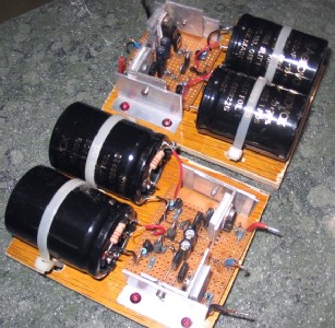

I am currently building the Pedja Rogic’s discrete power supply for my dual mono Chipamp LM3886.
I have assembled the V+ section of the power supply and have started positioning the components for the V-. I have just noticed the component supplier has sent three types of BD140 Transistor.
BD140, BD140-16 and BD140-16R4
Is it ok to use a BD140 and a 16 in the same circuit?

Yes, they are basically same transistor.
There can be some variation in HFE, gain.
BD140-16 .. is the most usual, lowest gain class ( ~160 )
BD140-25 .. is a class for those exemplars with higher gain ( ~250 )
BD140 .. only, can be in any gain span, is not classified and marked
with any of the above
Personally I have never seen any marked R4. The metalback.

So just to recap, can I use a BD140 and a BD140-16 side-by-side in the V- supply?
I was going to make some heat sinks like the ones in Nuuks picture.
No problems.
Like told.
Any variant BD140 will do well
When you use one aluminum piece heatsink per transistor, there can be no shortcut.
Even if using no TO-126 transistor insulators.
Just do not let those heatsinks come into electrical contact.
If you use eletrical insulators for mount transistors, then is no issue.
Can not be shortcuts whatever.
Like told.

Crikey those transistors must get hot! Nuuk's used quite a lot of metal on his heat sinks. There must be about 9mm attached to the back of those transistors, and that's not including the bracket to both sides.
Richard
Hi,Tripmaster said:Crikey those transistors must get hot!
measure the voltage drop across the pass transistor.
Measure the current through the pass transistor.
Multiply Volts * Amps to arrive at Watts. Choose a heatsink to suit.
No they don't get hot at all. But Pedja told me to heatsink them and that's what I made up from scraps of aluminium lying around the bench.

AndrewT said:Hi,
Thanks Andrew
I will do what you suggest just so I understand. I'm sure Nick's are just fine or he would have changed them.
Richard
