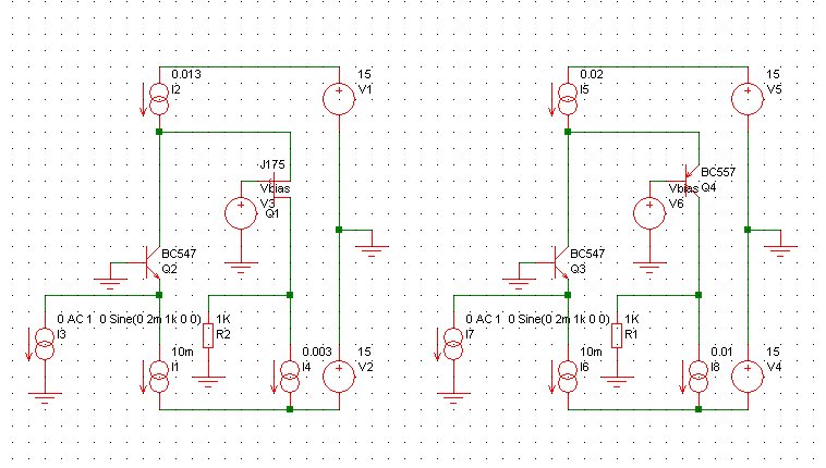

Bricolo said:
nice one! it simulates around -130dB
You can probably gain some more dB's by tweaking the resistance and choosing a new generation "Hi-Fet". At this level, however, the simulation results will have to be taken with a pinch of salt. To confirm the results, you'll need to build a model and make real measurements.
LV
boholm said:Choice of transistor and amount of current running thru' it compared to amount of current delivered by DAC are also topics worth investigating.
From what I've seen in sim results, there's an optimalpoint arount 10mA for a BJT. I don't know why the performance doesn't increase further when I increase the bias

Yes I know this one, but I think the compensation is for the Vbe modilation. He regulates Vbe so the input voltage is constant-> really low input impedance. I'm not sure that other non linearities are compensated
LV
I'll tru that, where can I learn more about those Hi-Fets?
Of course, -130dB isn't realistic for a real measurement. But my point is that if you can lower the distortion from -80 to -130 in simulations, you can also expect a nice real improvement

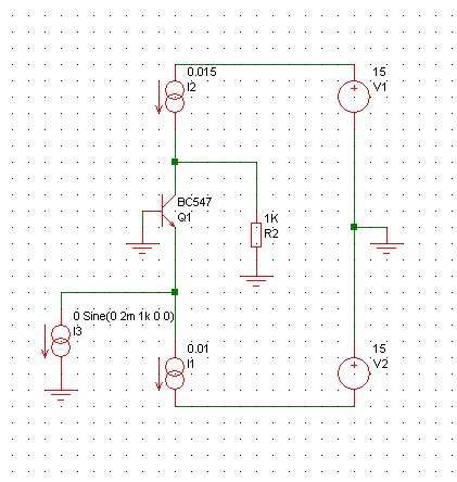

A few notes (since I already did a similar design) :
- CFPs like to oscillate. I built one with CFPs and it was a nice RF oscillator.
- If your simulator gives you -120 dB distortion, you should check that it models all the transistor defects like : parasitic capacitance variation with voltage and temperature ; signal-induced die temperature variation ; variation of hFe and Vbe with Ic, Vce and die temperature, etc.
JFETs are nice because there is no "base" current. Or is there ? Yes there is source current ; but instead of being Ic/hFe it's d(Vgd)*Cgd so check out your paratitic capacitances. You can cascode the JFET but in this case, where does the cascode base current go ? It is better to consider the base current as an "error" current and reinject it in the circuit.

that's exactly the idea I started to devellopp yersteday! in simulations, with a perfect current controlled current source, the distortion becomes zero
now I'm trying to design a current miror that agrees to to the same

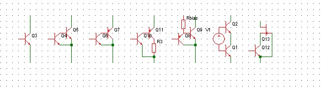

lineup said:
How can we improve, using this most obvious configuration:
CFP or darlington, with 2 (-3) transistors helping eachother?
Making up a super-transistor.
What say must be 2 JFET or 2 BJT or 2 MOSFET?
In CFP?

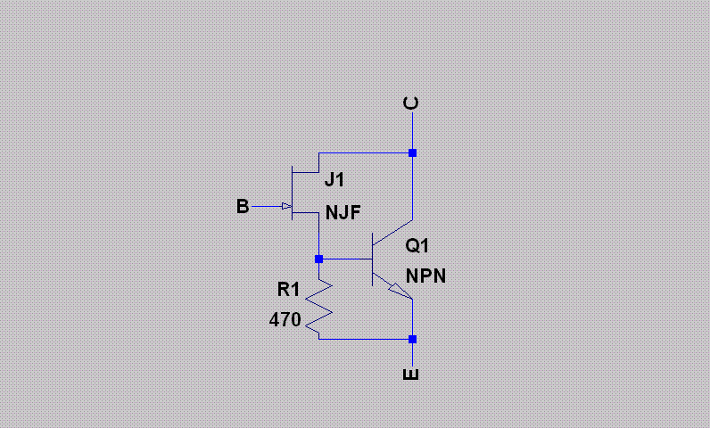

I have done some models using JFET + BJT foldback input stages
for high performance amplifiers.
(I am not talking about cascading.
Yet, I have never ever had to use any slow-down-cascade transistor for a helper in any amplifier.)
Let the JFET contribute what it does best
and Bipolar ( BC550C ) contribute its linearity by current
and if you need
add a small-signal MOSFET to this super-transistor stage
and let MOS contribute linearity at delta Vce ( VDS ) changes.
