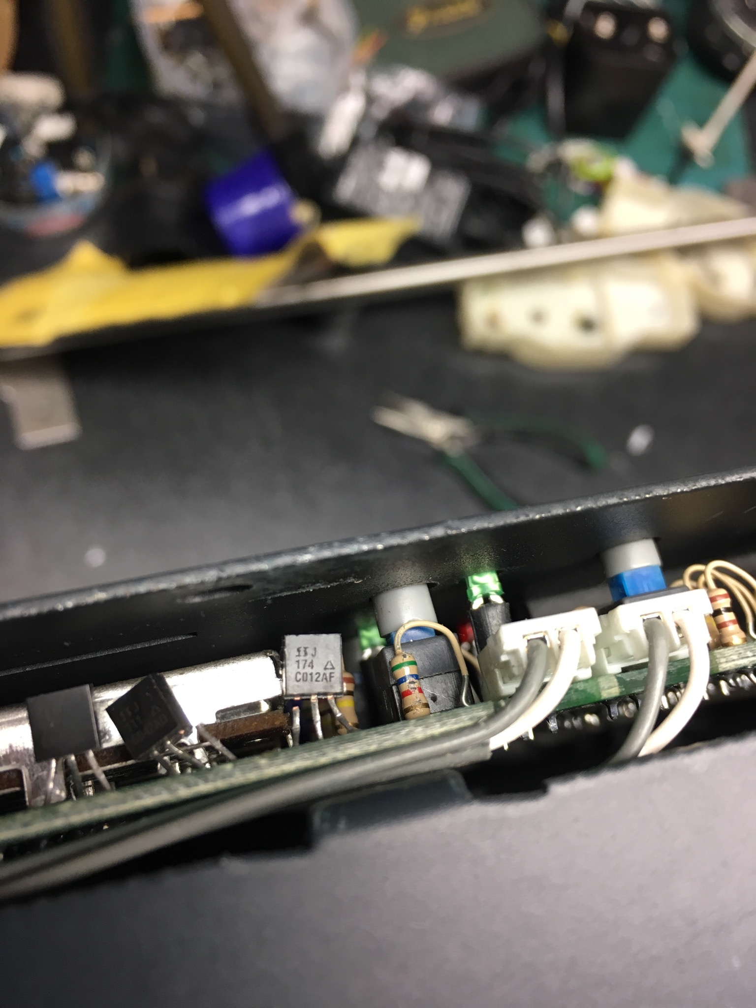

I’m working on a Carlsbro Eclipse12 mixing console. Transistor TR22 and TR23 need replacing. I can’t find any thing with the markings C012AF and C042AD.
I attach a picture. I would be delighted if someone could help me in finding a replacement.
Many thanks in advance

The j111 is here: http://www.onsemi.com/pub/Collateral/J111-D.PDF
and J174 https://media.digikey.com/pdf/Data Sheets/Fairchild PDFs/J17x,MMBFJ17x.pdf
Both should be available at DigiKey
