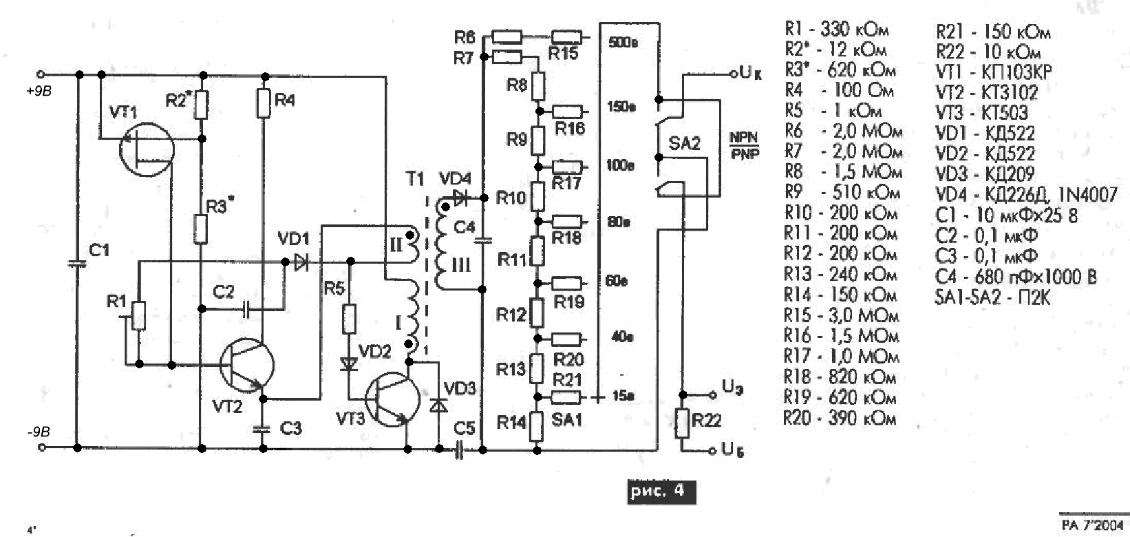

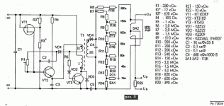

There is such a circuit for selection of transistors for h21e and check UceR.
It is clear from all electrical circuits.

You're absolutely right. But. Selection for һ21е reduces INPUT OFFSET CURRENT, and we are interested in, in addition, the INPUT OFFSET VOLTAGE. To reduce this last to be measured and Ube, which often has a variation.
In fact, a high degree of matching of the transistors in the amplifiers is not as important. The servo helps to eliminate the effects of unbalance in the input stage.Remain to know what happens with distortion. About this I have no data.

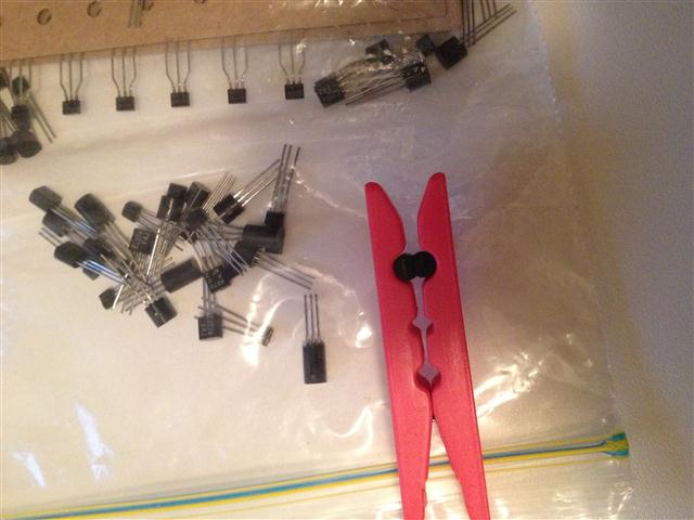

group them into batches that have similar hFE using the transistor facility on a DMM.
Then select from a batch to insert REF & DUT to try to find matched pairs.
You need to check hFE (test1) AND see if they pass similar current (test2) when both are fed with the same base voltage
for test1 you select a base resistor value that allows you to measure the base current.
for test2 you need to select a base resistor value equal to zero ohms.

I use two 3socket 0.1" Single In Line (SIL sockets) glued together to form a 6socket jig for the two transistors. I clamp the flat faces together with a spring clamp, (a tiny elastic band would do the same, but I have never seen one small enough).

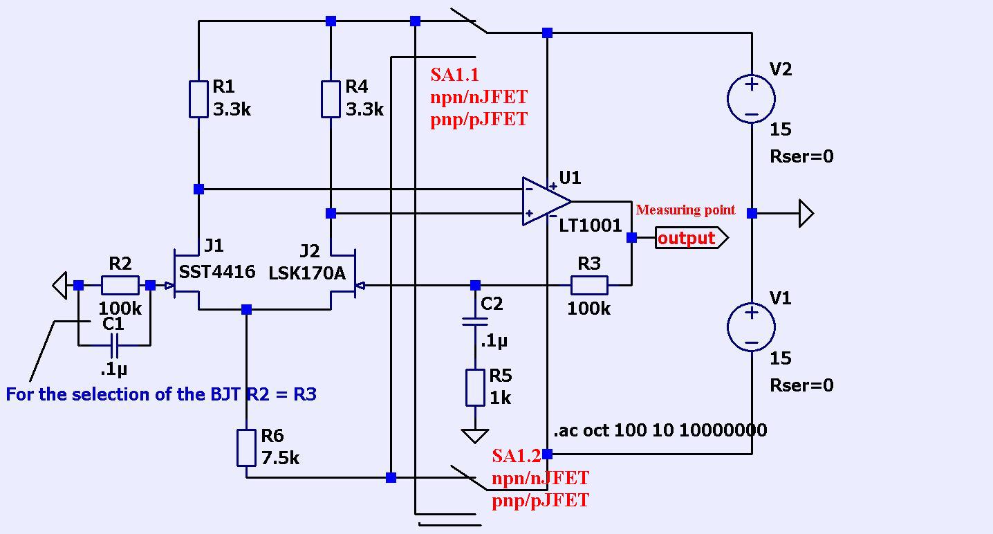

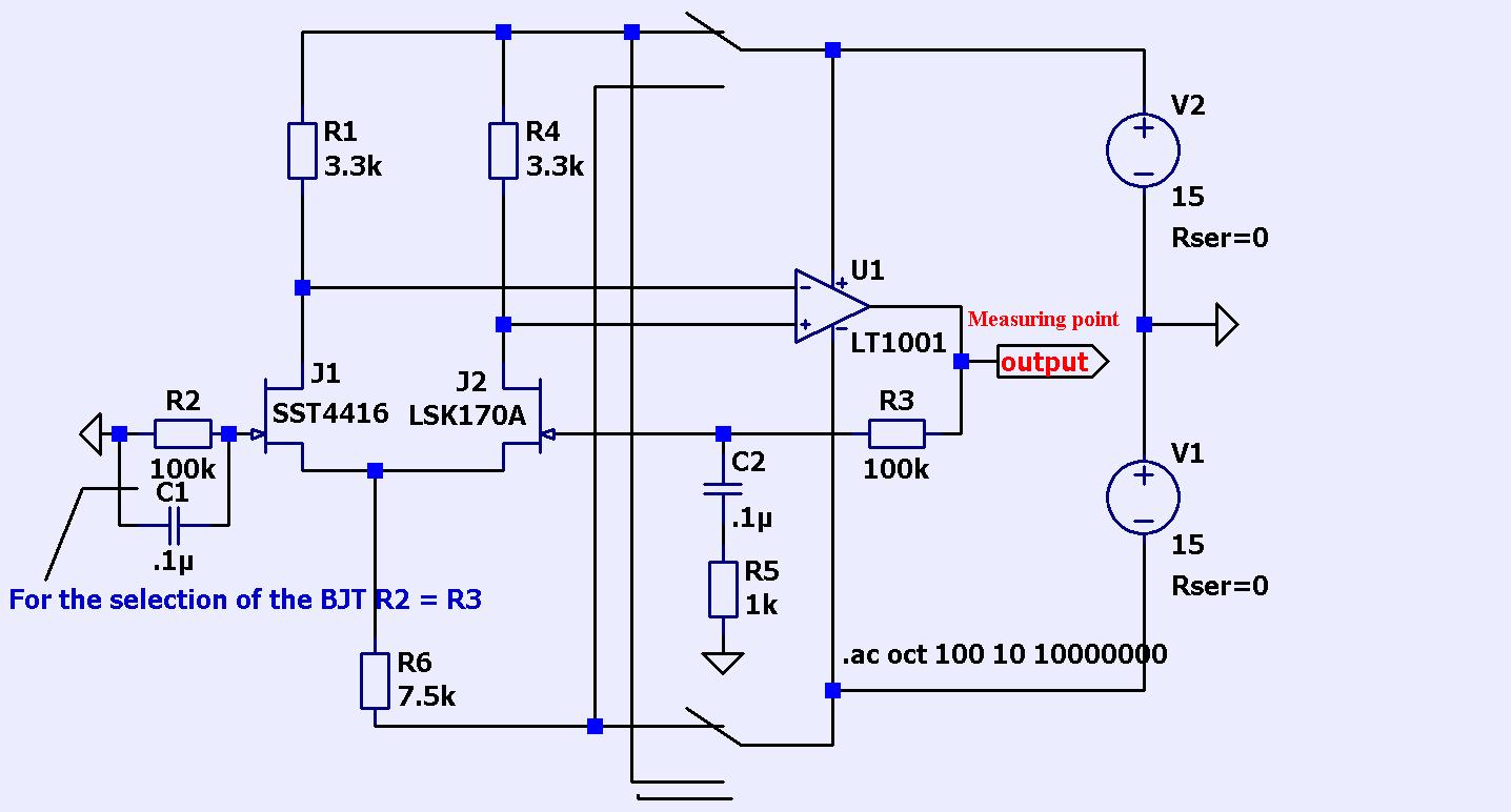

For semi-automatic selection of matched pairs of JFET and BJT.
AHsJFJhC1JVdTiwNFHjIzQRYghQooATggIBTTTRlyNVL0Z4COQLoGuCnQgAduFxBEWgoDaMibGzFWSPmU4csj+wM1PKj1okIIUjp6WEESB+BGGKhQHUrj5U6CaosGTVmjgxZfDhtogIpxgAJAgBgmZTpC5kNAxkcmaIq1B1PgSotWCgQzyIagHx4afCnFZqFdF5IKWCKgGENQxAxKdGi1yBCpWrMCCDCAC0TAdrsuGRDyAcYFIJ0QSDAAIIEiQBEYpWEh5JXTySZAQBmxYADD8KQaOQCTi8cXFZ5cGRBDYRUZd6AuiFnIIhOW1QQucCBFxJMLM7QFTgiioNZheYuAgwIADs=
The idea is that the OpAmp drove the J2 and balanced currents J1 and J2. In place of the J1 and J2 through connector placed a pair of JFET or BJT, and the output OpAmp to measure the voltage of the error and pick up a pair of JFET or BJT at the lower value.
For the selection of the BJT R2 = R3.
You can choose OpAmp any cheap device.
