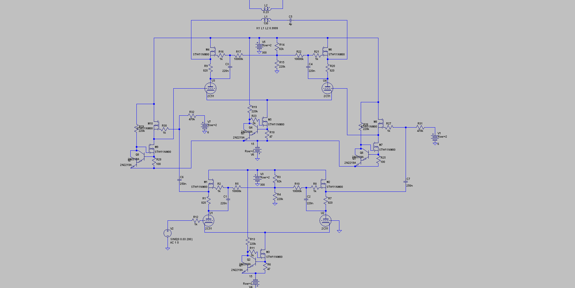

Interesting hybrid circuit. If I understand correctly, L3 and L4 in your schematics are in fact a transformer.
What transformer did you use when you built the circuit ?
Because it's absolutely conventional, and single-ended, transformer in the plate circuit is in some ways both considered the best performer and the most likely to deliver that characteristic valve sound.
I'm not trying to start an argument here, I'm just pointing out that that topology is considered attractive in some quarters. Parafeed and hybrid are somehow second best, with OTL acceptable if it'll work with your phones.
I'm interested in this kind of opinions since it's the "valve sound" I want from this headphone amplifier.
Can you recommend headphone amplifier circuits that sound good and have the "valve sound" ?
Yes, L3/L4 simulates the transformer.
I used the edcor pcw10k-7k/300-32. You can see them in the pics, it gives you an idea of their size compared to the caps/tubes.

00940's 6E5P triode strapped CCS plate loaded parafeed circuit is NOT going to have "a sound". It's going to be very very fast and transparent.
I've done a few similar circuits with 6E5P, only difference being I use a MOSFET gyrator plate load instead of CCS, but it's very similar in transparency.
I would recommend using only one parafeed cap, no parallelling.

This should fit the bill, with the top end rolled off a bit... only 5mA in the final stage.
May I present this as food for thought. Performance is good out to 50khz and power toroidals can be used as both input and output transformers. A parafeed arrangement also works well.
A full compliment of transformers can be had for the cost of a single headphone OT. TRIAD make good candidates.

This is what I would do for a simple and cheap, yet extremely high performing headphone amp.
No need to make compromise for power efficiency for headphones. Linearity and dynamics (the Powerdrive really makes this - any circuit really - shine) with no global feedback. Cheap, simple and relatively easy.
This will not have a sound. It will be fast, musical and dynamic with lots of air and all that.
MOSFETs can be IRF820 or similar.
Tubes can be 6922 or variants, 2C51, 6SN7 or variants with no circuit changes. I would use 6N3P.
Or maybe use 6N16B and change the CCS tails for a bit smaller current and use maybe a bit lower B+. I've been thinking about making this amp for some time; would be very cute and pretty!

I assume the headphones in question are 600 ohms? This is a parafeed plate to line transformer and is not suitable for driving low impedance headphones. (I have a pair I am using in a new line stage design.) Note recommended load impedance is 10K and above.
300 ohm Sennheisers are the only headphones I use, which should reflect 10k. It seems like it should be suitable for a few different kinds of tubes popular in "spud" parafeed like 5687.
The 10K cited is the secondary load, not the load reflected to the primary which is more like 336K with the recommended minimum load. This transformer is really not suitable for driving headphones, honest.
Where does it say the secondary is 10k?
The winding ratio is 5.8:1
If you look at the lundahl data sheet you will see that the performance is specified into a 10K load on the secondary side. (The secondary is not 10K, it is the source impedance divided by the square of the turns ratio ignoring the effects of the shunting inductive reactance of the primary at low frequencies) These transformers are tiny and can't handle an appreciable amount of power.. Note the application. They do not specify the load impedance for the distortion measurements which probably means solely into the input impedance of the measurement setup which would typically be at least 100K ohms based on my experience.
