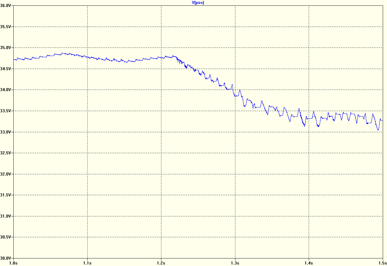

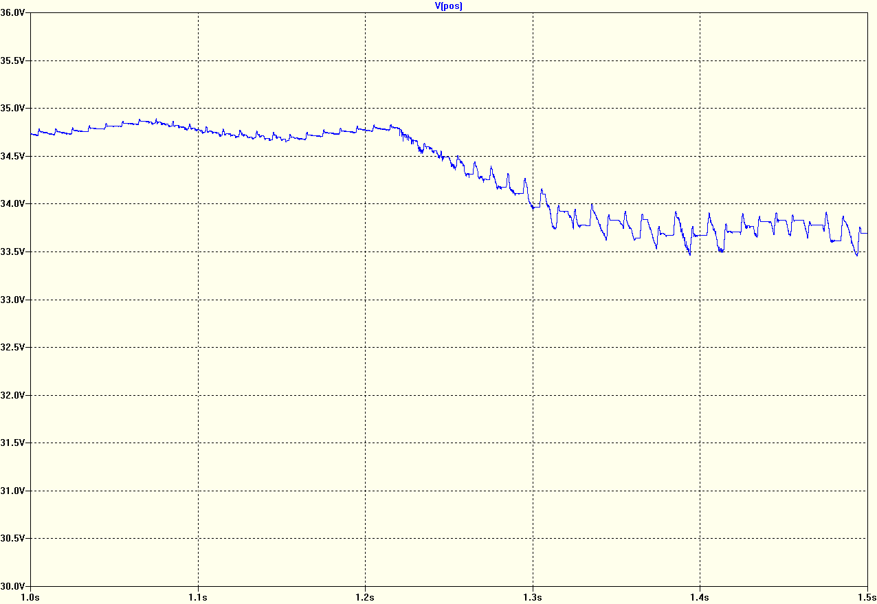

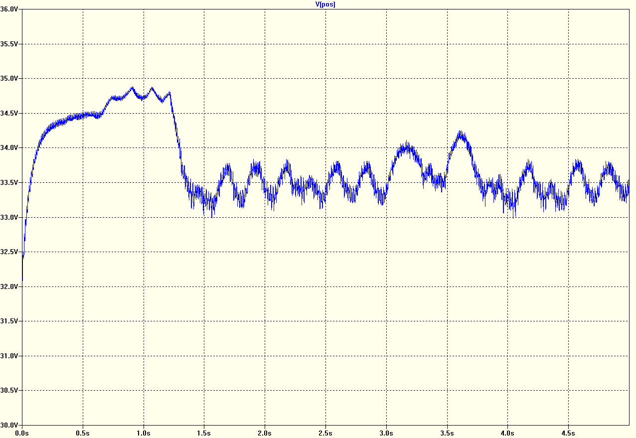

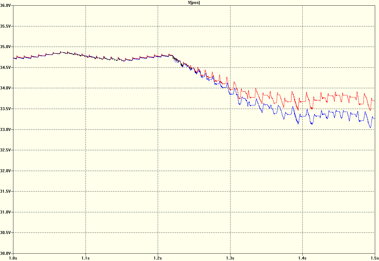

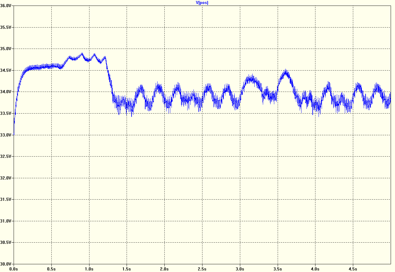

Made a more comprehensive simulation. This time I used the complete P3A circuit with a 2 Ohm resistive load and an actual wave file as input source. The power supply consists of a single rectifier bridge for both rails, 10.000uf of capacitance for each rail, and two modeled transformers.
Simulation time was almost four hours versus a quarter; the generated raw files grew to a full 36GB and 1GB, respectively.
#1: Elaborate Model, 5 seconds of music into 2 Ohms, positive voltage rail shown
#2: Simple Model, 5 seconds of music into 2 Ohms, positive voltage rail shown
#3: Elaborate Model, section of 0.5 seconds for better resolution
#4: Simple Model, section of 0.5 seconds for better resolution
#5: Overlay of both models for direct comparison, Simple one shown in red
#6: amplifier output voltage
Can you try the sim again with 80,000 uf instead of 10k......

Here you are. :cheers:

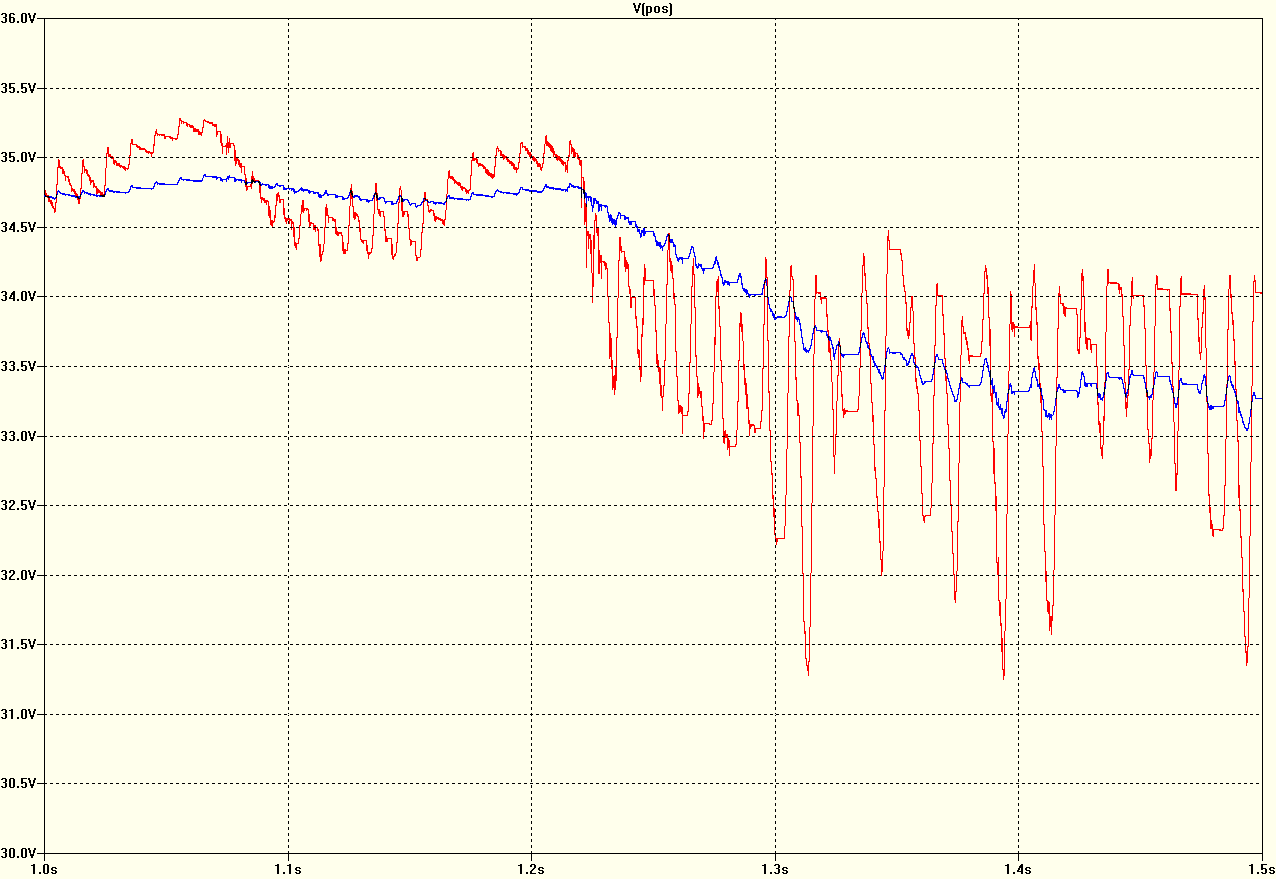

Here are the comparison charts. I used the simulation model from Tom Gootee with the measured data of my trafo.
The first chart shows both models with a simple resistive load on the ac, where the blue line resembles Tom's model and the red line my simple approach.
On the other charts the models were loaded with a full bridge rectifier, 4700uF (ESR=63m) and the stepped resistor. Same colour coding here.
Unfortunately I don't have a transformer with lower VA and equal voltage rating at hand. This would have made the comparison much more descriptive.
Please note that these comparison charts took more than half an hour to simulate, while the simple model is only a matter of seconds :eek:.

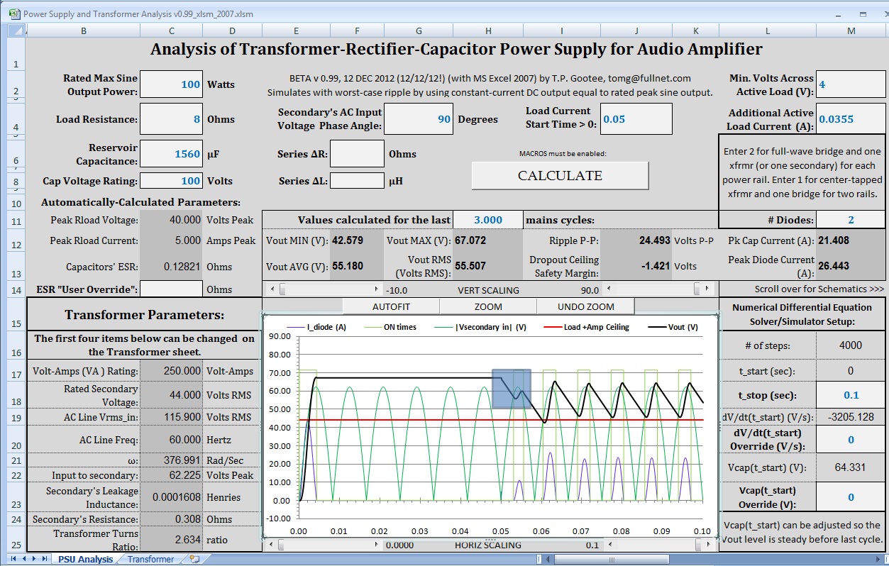

Recently, I also included the auto-scaling transformer model in a spreadsheet that simulates a transformer-rectifier-capacitor power supply with a constant-current load, by using a numerical solution of the differential equations for the circuit. It is downloadable at:
http://www.diyaudio.com/forums/power-supplies/216409-power-supply-resevoir-size-166.html#post3282260
This should point to a screen image of the main user interface:
http://www.diyaudio.com/forums/atta...er-supply-resevoir-size-v0.99scrn_prezoom.jpg
(Ignore the small blue rectangle on the plot. I was just showing how the Zoom feature worked.)
If you want the latest version of my LT-Spice PSU simulation files that use the scalable transformer model, let me know. The latest version lets you set the transformer model's scalable parameters in the main circuit's .asc file. So you can easily step-sweep them, for example.
