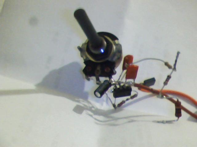

I'm afraid that it will be very difficult, as I said before, I'm poor, and only have an old scope (give me my cousin) my signal generator in the attachment. :D:D

P.S. Sorry for the low resolution photo, taken with my webcam.

If your generator can top at least 100-150KHz (better up to 200KHz of course) its OK for the first time. On the scope you can check voltage peaks and dips. Cheap digital voltmeters often limited to several KHz, so in the absence of True RMS voltmeter scope is a logical choice.
BTW, many PC sound card can output up to 50KHz, use freeware ARTA as software to control frequency..
Additionally, on "Equipment & Tools" section of this forum you can ask for a simple generator schematic and prototype it on dirty cheap Chinese breadboard.
PM me with your e-mail, I'll upload Russian books on my ftp next week when will be back in the office.

I must invert a little to buy a decent Chinese function generator, my 555 based gen is a shame...:eek:
You will want to kill me, but again, my pc is an old pentium 4 build with junk, and its sound card is worse!!! No hope for me...:D
