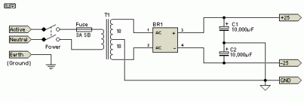

im building a gain clone (i believe) using only half of an lm1876 before building another bridged one to the full 40W potential(specifically for a guitar amp). Got the circuit working using some dedicated power supplies from a lab, but i'm wanting to build my own power supply. Now im wanting to just copy the below schematic but i have a few questions.
When checking out transformers at dikikey, what kind of VA should i aim for with the lm1876 operating at max 20W? Also im aiming for secondary voltage going about 15 - 0 - 15, but i don't get how they mean with parallel voltage or series voltage. and lastly on the transformer what difference is dual vs. single winding?

Hi, magelord04.
There is a good Application Note about power requirements for various chipamp configurations. Go to http://www.national.com and enter AN-1192 into the search box. That should give you the methods needed to calculate what you need for your (and any) particular chipamp(s) setup.
And I guess if you have it working with lab power supplies, then you can measure what you're pulling from them, to help determine what VA rating your transformers might need to be. I'd shoot for at least 160% of what you think you'll need.
The transformers you're looking at (I didn't look at your link) probably have dual secondary windings/outputs (i.e. four wires out, in two pairs). Those are usually rated for both series and parallel connections of the secondaries. If you connect the secondaries in parallel, you get half the voltage compared to series, but twice the current. If a dual-secondary transformer were used as in your schematic, you'd get half of the series-rated voltage from each side (i.e. 1X the parallel-rated voltage), and half of the parallel-rated current from each side.
I try to never buy a transformer that has a single center-tapped secondary, as shown in your schematic. Dual secondaries are much more versatile, but can still be connected as in your schematic. But they can also be used to create a dual + and - regulated supply when using two positive regulators (which is handy when neg regulators aren't available for the current rating needed), which can't be done with a single center tap.
For the bridge rectifier, if you're not using discrete diodes, I'd just standardize on something like a 100V 8A model (or whatever), that could be used for many different projects, and buy 10 or so (if that gives a price break) if you think you might ever want to build more power supplies.
