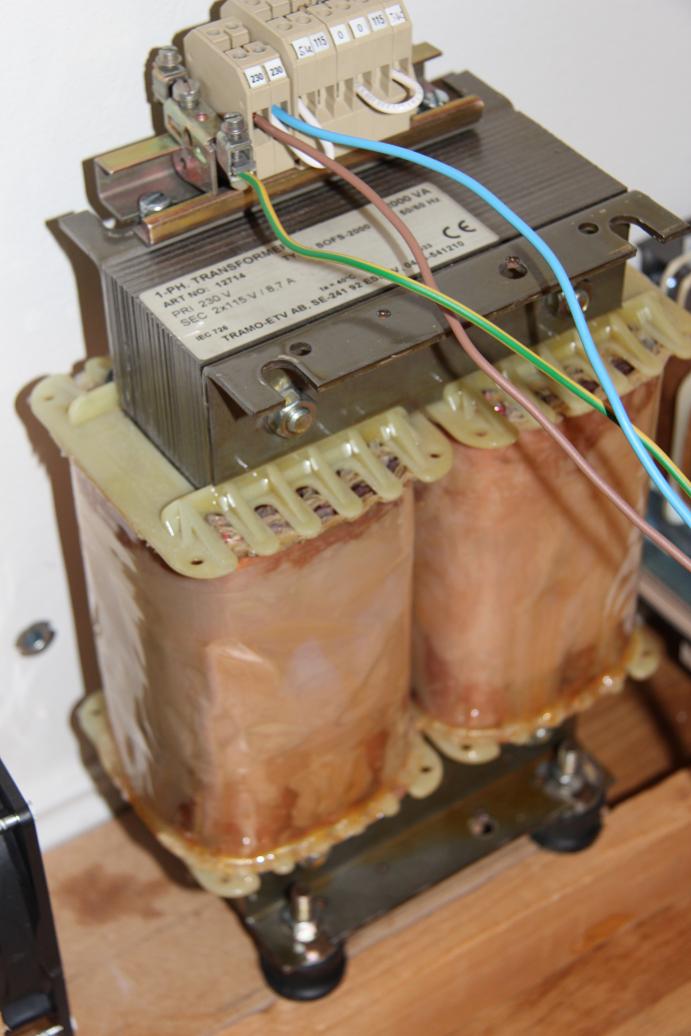

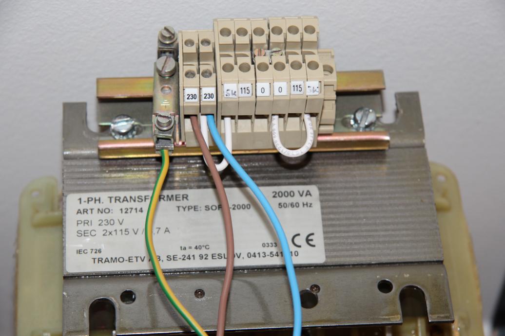

This is an old thread, but people seem to know whats going on. I am about to install an isolation transformer under my workbench so I have a question about how to with it.
My trafo has two shields, one (primary?) between the windings. Thats SK to the left on the picture. Then it has one (secondary?) outer shield, thats SK to the right. Or is this belly band?
I now test connected the inner shield to one of the primary Vin and the outer to 0 ie the center tap of the secondary.
When i plug it this way the left 115 V winding has some 74 VAC to saftey ground and the right 115 VAC winding has some 156 VAC to saftey ground. The interconnected secondary zeros (CT) has some 40 VAC to saftey ground.
Is this the way I should do it or should I have the inner shield, the one between the windings to secondary CT and the outer shields to saftey ground?
And a follow up question on that. My plan is to let secondary (the whole workbench float. I was thinking to use secondary CT as virtual saftey ground. But that now has 40 VAC on it.
Opinions?

the interwinding screen is intended to shunt interference to Earth.
It can only do that via a low impedance connection to Earth.
That low impedance connection is the enclosing metal chassis. It is capacitively connected to Earth.
Connect the interwinding screen to the chassis of the enclosing metal box.
Connect the metal box to PE. Low frequency interference will choose whether it goes via the capacitance, or via the inductive PE wire.
If there is a belly band, then that does not connect to anything. It floats.
If there is a second interwinding screen, then this was discussed briefly in another Thread. I don't know where the second screen should go.
But if some interference does get shunted down it's connecting wire, then that wire does not get connected to any signal ground.
It might go to the next enclosing metal box to be shunted to Earth, but that's just a guess.

Hi Andrew
No metal boxes around. Its gonna stand behind my workbench.
So Interwinding screen to PE in the wall, ie same as the core? External screen, around windings to nothing, just float?
How do I do with saftey grounding on workbench? I dont want mains PE there preferably.
