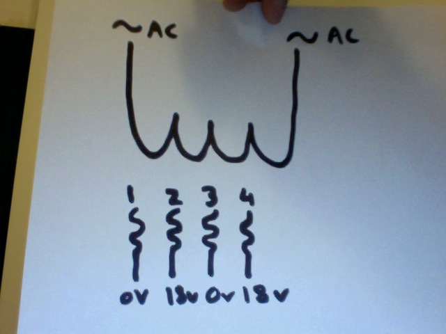

transformer blues
I investigated my transformer today (2x 0-18 - 625VA. 230v primary). the process left me as confused as ever.
The secondary side of the transformer has 4 wires coming out of it - from left to right they are black (marked 0v), blue (marked 18v), black (marked 0v) and blue (marked 18v)
i had them wired with the outer two going to one rectifier and the inner pair going to the other. when i read the voltage between these pairs it gave me 17.7v so i thought it was normal and wired it up.
after taking the amp apart today i measured the resistance between these pairs (one blue and one black wire) and it measured open circuit. i then measured the resistance between the two black wires. it measured 0.2 ohms. the resistance between the two blue wires was also 0.2 ohms. i then paired the two black wires together and the two blue wires together and measured the voltage. i got 18v from each pair!
this left me a bit confused, so i have decided not to re-connect the transformer to the rectifier before i get some advice.
to recap, i am getting 18v(approx) with two configurations. one is with the inner wires as one pair and the outer wires as the other. in this case there is one blue and one black wire per pair and it seems to be logical that this was how the transformer was meant to be wired. it is labelled this way.
the other configuration is if both the black (marked 0v) wires are one pair and the blue (marked 18v) wires are another. this configuration also gives a resistance of 0.2 ohms while the first one reads open circuit
i am thoroughly confused...please help!

From left to right, 1/2/3/4 being wire numbers, it would seem you are saying that 1/4 and 2/3 are valid pairs which you had connected and are getting 18V readings from, and so are 1/3 and 2/4, which you have now measured and are also finding voltages at. Also, that each pair of 1/2 and 3/4 are open circuit.
Obviously, there is some voodoo at work, because if you draw this out, you will see that if 1 is connected to 2 as well as 3, then 2 is connected also to 3 and cannot measure open circuit.
It's extremely confusing, can you prepare a sketch with resistance and voltage readings?
Hi sangram, thanks for stepping in.
1 and 3 are black and are marked 0v
2 and 4 are blue and are marked 18v
1 and 2 measure open circuit
3 and 4 measure open circuit
1 and 3 measure 18v and 0.2 ohms
1 and 4 measure 17.7v and i cant get a resistance reading
2 and 3 measure 17.7v and i cant get a resistance reading
2 and 4 measure 18v and 0.2 ohms
1 does not appear to be connected to 2
3 does not appear to be connected to 4
i will try and post a diagram
thanks
mymindinside
hi again,
sorry for the bad sketch. refer the explanation in the post above
cheers,
mymindinside

Moderator
Joined 2002
When you say you can't get a reading, is it open circuit with the power disconnected?
It would appear to me that the correct pairs are the two black wires and the two blue wires. In most toroids, the secondary windings usually have the same colour wire for the beginning and the end of the winding to prevent confusion, it would appear a simple case of mislabelling.
I still can't get how you are managing to read a voltage off an apparently open circuit...
when i say open circuit (1 and 2, 3 and 4) i mean that there is no resistance reading or voltage reading when these are paired together.
i too find it strange that im getting a voltage reading (1 and 4, 2 and 3) with no resistance reading. i check resistance with the power off and voltage with power on (obviously)
do you think i should connect the same colored pairs to the rectifiers and see what dc voltage i get?
cheers,
mymindinside
p.s. could this be a symptom of some kind of transformer damage? the dc voltage withe 1 and 4, 2 and 3 as pairs is about 23v unloaded and it drops to 19v with the F2 amp load. the amp sounds great with only one channel input connected. if i connect both the inputs i get a loud hum through the speakers (that is the basic problem i'm trying to resolve)
Moderator
Joined 2002
Now I'm more confused - you said you get 17.7V between 1/2 and 3/4 pairs.
Anyway, you should hook up the same wire colours as pairs if you're getting the correct voltage readings. Whatever your no-load reading is, you can expect it to drop a few volts when you connect two channels of the amp.
The loud hum may have been due to the return currents not being able to go back to the transformer windings, though a star ground should have been able to prevent that. Or it was working as a set of half-wave rectifiers because the transformer was only partially connected? I'm not really sure, give it a try and see what happens.

i have measured the resistance and found that i have two windings. lets refer to them as A and B. both measure 18vac. attached each winding to the AC terminals of its own bridge rectifier (this is a enclosed metal can type- not discrete). The voodoo deepens. my dc voltage reading is just 17v! this is with no load just a multimeter attached to the dc outs of the rectifier to measure the voltage. shouldnt this be closer to 22-23v for 18vac on the secondary?
i appreciate your patient advice Andrew, and i think that the importance of safety cannot be over-emphasised. this is true even when troubleshooting because the tempation is to speed up things to get the equipment working again.
EDIT: im sorry i posted that without reading that i was to measure the ac voltage again after connecting the bridge rectifier.will check this and report

It's pretty clear that the dual rectifiers are creating the current path so that two rails can exist even if the secondaries are wrongly connected. What is confusing are the voltage readings he's getting even with open secondaries (or not).
To illustrate my point, here are two diagrams that show the wiring - both will work, except in one configuration the rectifiers work in half wave mode. I strongly suspect the second method was used, but the understanding that I get from the TS is that there is a voltage measurement between the windings number 1 and 2 even when open.
I guess we need to see all voltage readings between all terminals of the transformer both when open and connected to the rectifiers. Unless we place a dead short between terminals of the same winding, I see little danger.
