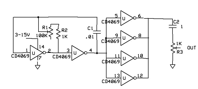

An easy way to inset voltage, is to make a 555 or a HCF4069 oscillator, say, 1KHz squeare wave (near 50% duty cycle) and capacitively couple to any winding (to don´t saturate the core with the DC mean current) , and verify if this signals comes out from other wires.

Yes, but add some kind of manual attenuator at the output of the oscillator, a 1k pot will work properly. Also, if you make the HCF4069 oscillator (using 2 units of 6 inverters inside it for oscillator itself, and the other 4 wired in parallel as "output stage"), it will work with as little as 3V, so I believe that such a voltage will not damage any kind of circuit.
Sorry by the ugly look, but I did it while eating, ouch!!!
Don´t use a too low R2 or the oscillator will stop.

Further data: if you have a oscilloscope, you can measure the turns ratio comparing input and output amplitudes, a bit more difficult with true audio. Also, ringing at the vertical edges and or rounding corners, gives you an idea of how well is the trafo under question.
As Simon tells, don´t use DC to measure audio xformers, they may become magnetized and then increase distortion. Such low level units has very high mu cores, and can get strong remanence with low currents in its windings. For that reason I underlined capacitively couple the trafo to the test gear (Oscillator). It prevents DC flow in the coil.
