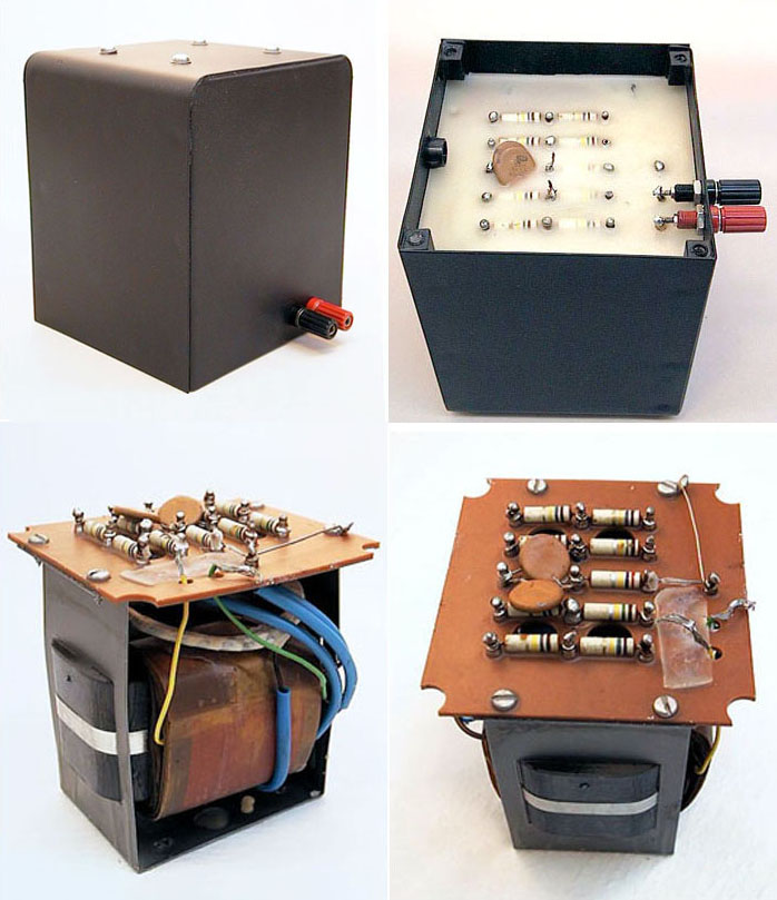

By the way I have one with broken wire. Does someone have details on how many turns & gauge for each winding ?
Is it do-able by hand or does it require a machine (if too many turns or needs to be very tight) ? Thanks
I got a lot of information from Baxandall's book. Just lacking: gauge of each wire.
I answer to myself: I just dis-assembled the transformer.
Regarding each of the 2 smallest coils (for the bass) first: wire has a diameter of about 0.2mm. Overall resistivity is about 2.25kOhm.
This makes length=4158m as first estimate (a lot, there must be something wrong !), computed that way:
2.25*1000/(1.7e-8)*PI*(0.1/1000)^2
Next step: unwind and count number of turns.
Winding seems very tight; not sure I can re-do it easily with a manual winder: the coil might be too thick if not done properly.

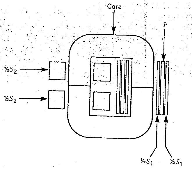

Did you unwind the Quad transformer, do you know the turns ratio. I wondered if it would be possile to us 2 toroidal transformers, one for the bass and one for the treble
Stuart
Hello,
Not yet. I will do this later as this is not essential for me right now: this is a spare part.
The turns ratio is given in Baxandall; I do not it by heart. But this does not give the number of turns, just the ratio. I will get some equipment to count the number of turns as it seems quite high and thus painful to count without making an error.

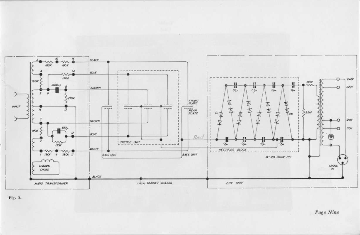

The transformer is made of one main core + 2 additional cores, adding power for the bass panels. Hard to explain but just have a look to schematic (widely available) to make up your mind. Just remember that the bass panels need the 3 cores to work. That's why I think it would be difficult to split the transformer in two and still keep the same behaviour.
But is should work; it would just be different.
Fabien,
Your calculation seems correct, but note that the resistance of a coil can't be measured correctly by a DWM. Try an old-fashioned analog multimeter.
I used a high end multimeter (Fluke 179) thus this should not be an issue. My main error may come from the measurement of the diameter.
Anyway I will conlude once I will have unwinded the coil.
