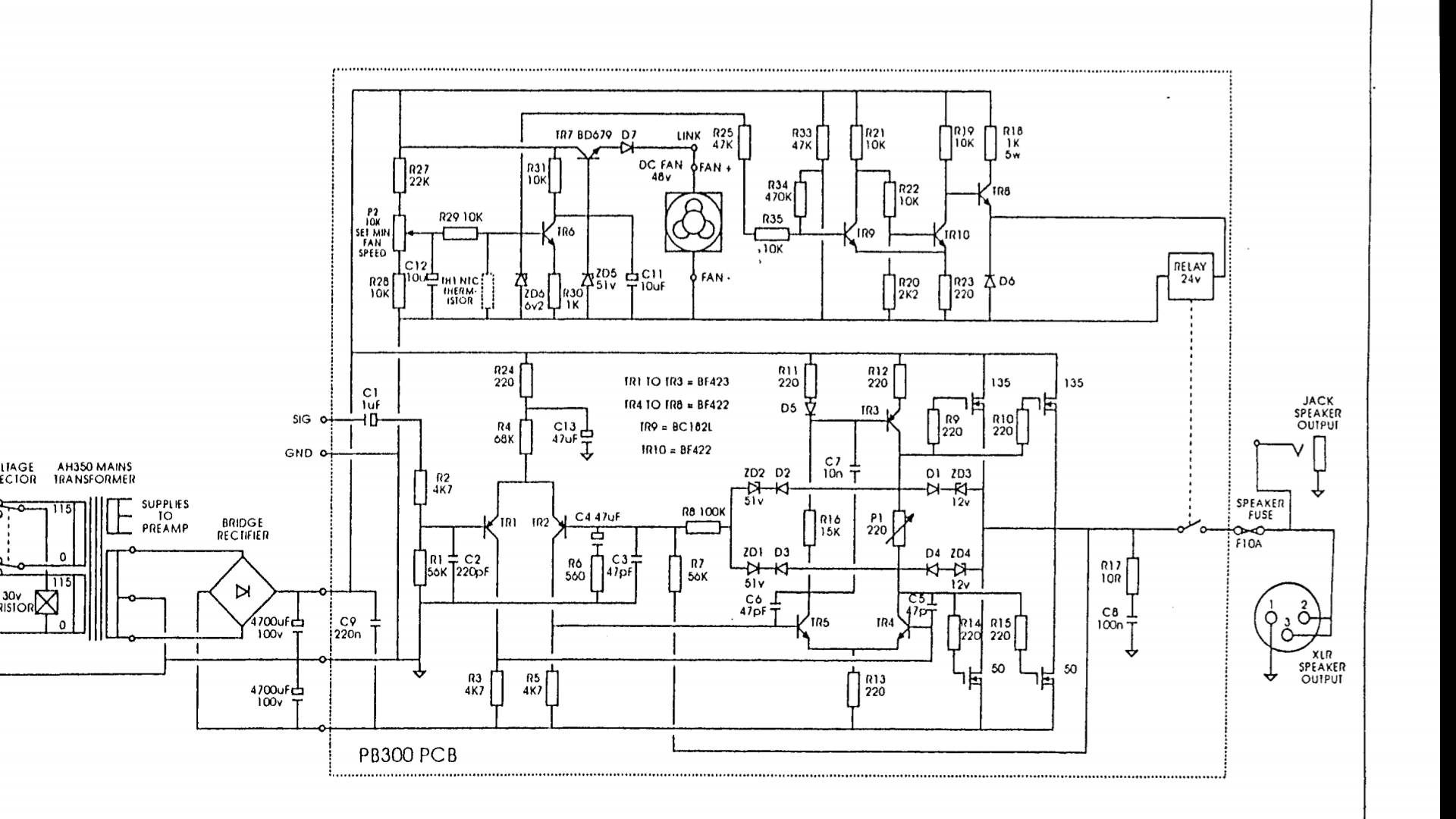

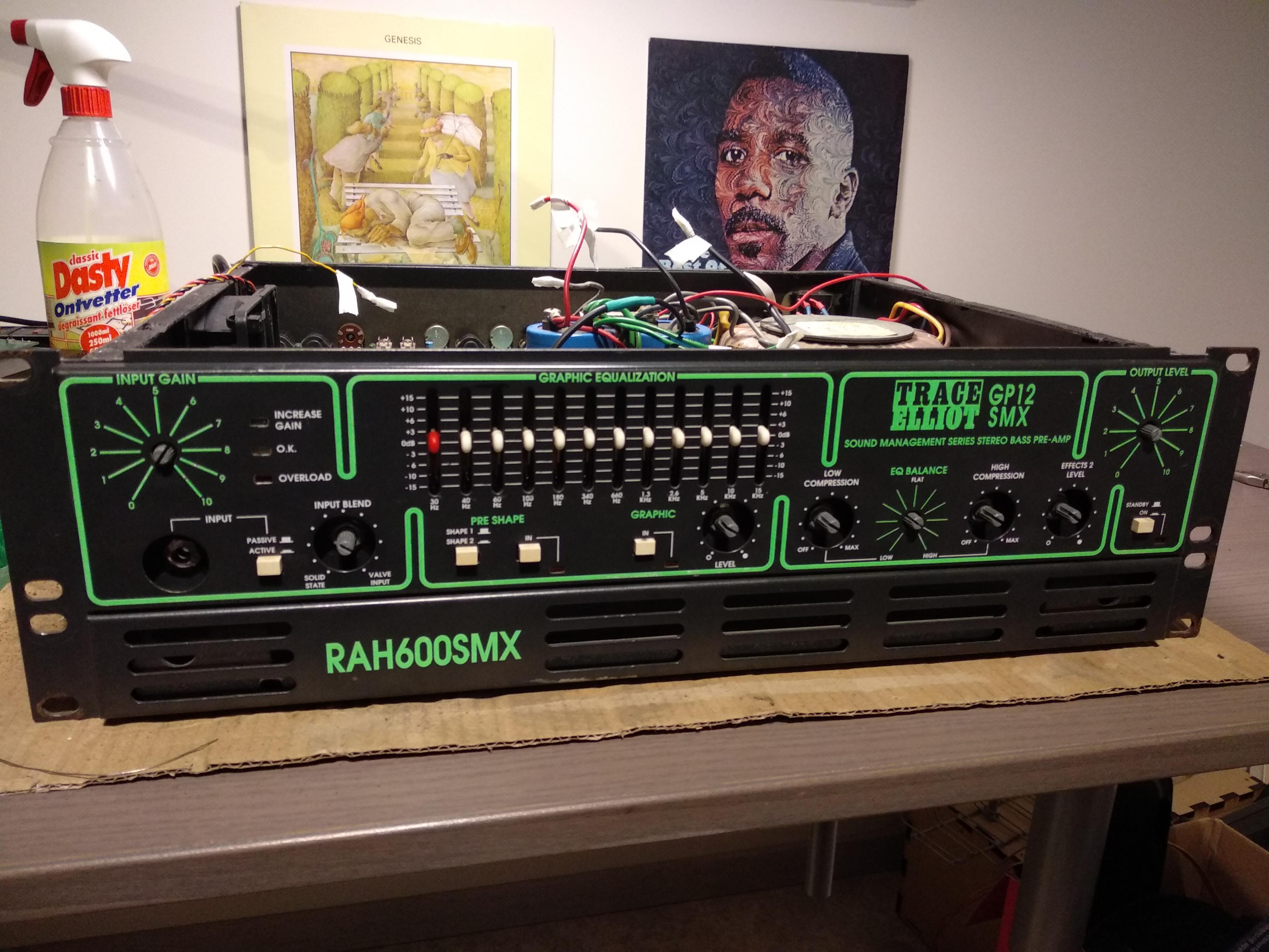

I have this 2x300W bass amplifier on my bench, bought as 'not working'.
The outputs have been changed obviously, at the moment it has 2x2SK176 and 2xSJ50 on each side. These are not direct complements. 2 K176s are original Hitachi, all 6 others are DSI (a brand that specializes in obsolete components).
I do not know what was originally in there, I have found a Trace Elliot schematic with BUZ900-BUZ905 in it, but that might be a different revision (schematic seems identical though).
Anyway, are there any dangers running this kind of configuration? I'm afraid there might be some DC offset as Vgs is different? Im also quite sure the transistors haven't been matched, they are used without a source resistor, should that lead to current balancing issues?
Keep in mind, this is a heavy duty bass amp. It should therefore not be very hifi, but it should be very rugged.
Would you keep this config, or change everything to BUZ900/905?

Schematisch in attachment.

I like the non-existent DC protection. Well it has a fan and relay. 4700uF also seems low for 300W. And if You ever put it in service, please exchange that XLR connector for a Speakon one. What's the rail Voltage ?
Rail is +-70V I believe.
Like I said, it's not a hifi design. I have had 50watt amps with 10mF of cap, but this one only has 10mF for 2x300W. I can get pics tonight.

By the way, the schematic I posted has a parts list with BUZ900/905 in it, but as Enzo says , the numbers next to the symbols probably point to 2SK135 and 2SJ50. These last are probably what used to be in here.

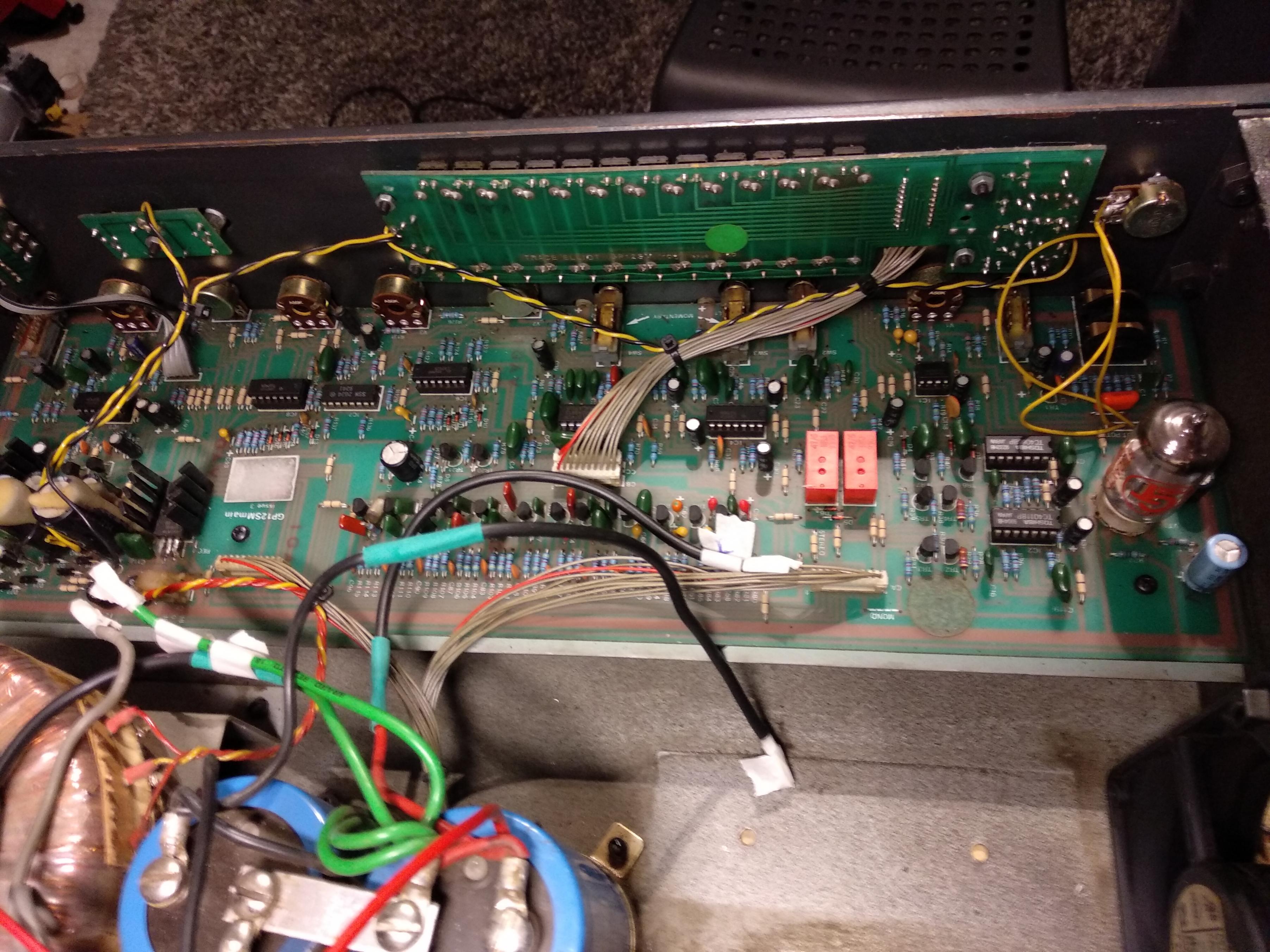

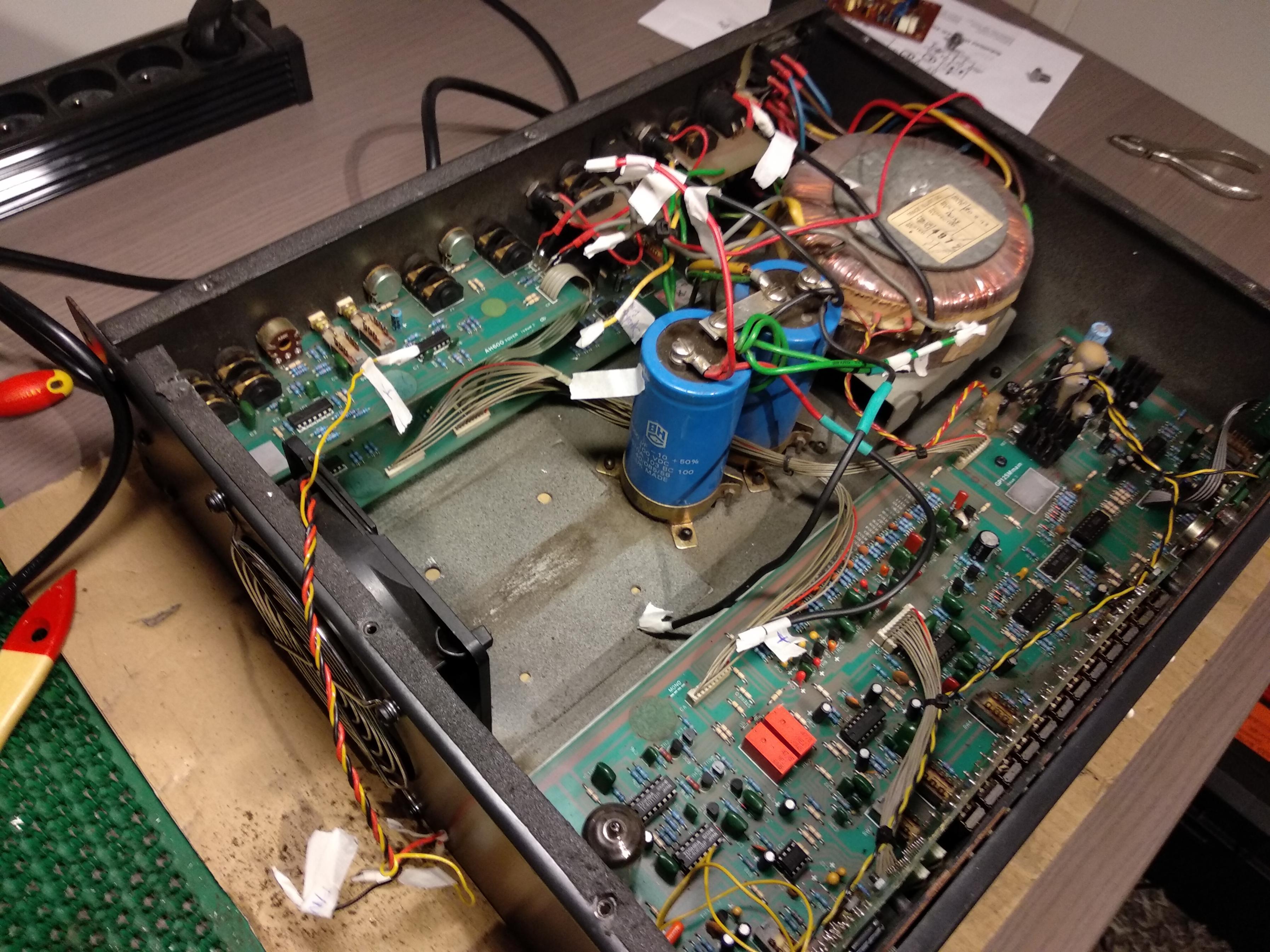

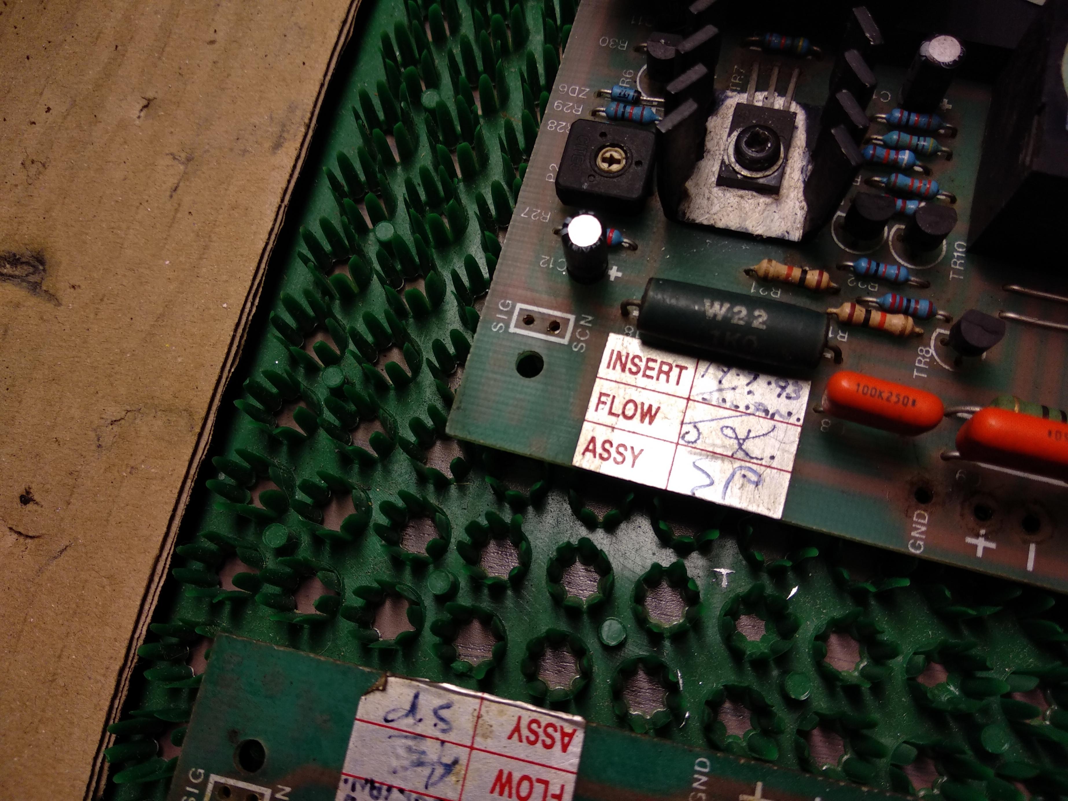

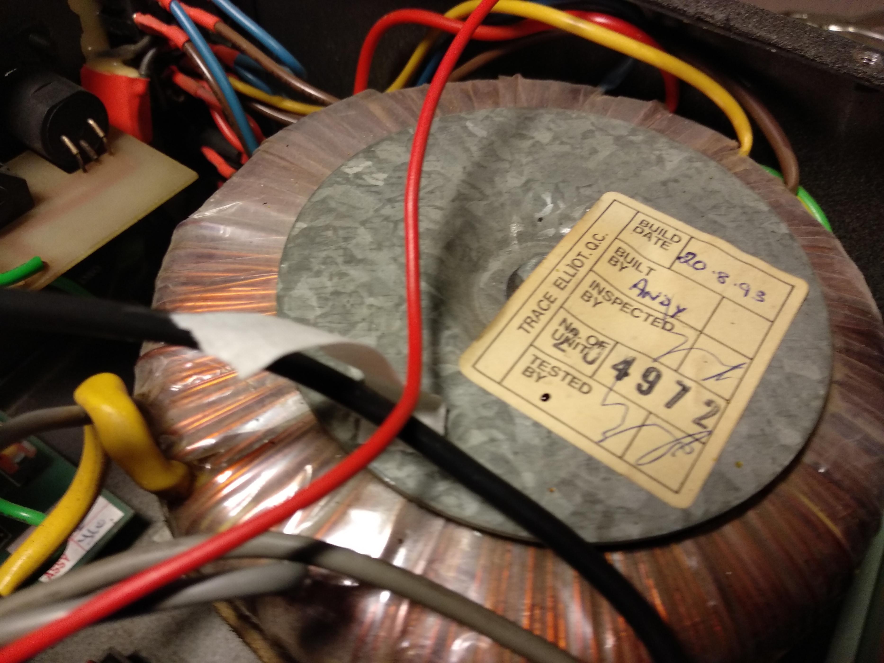

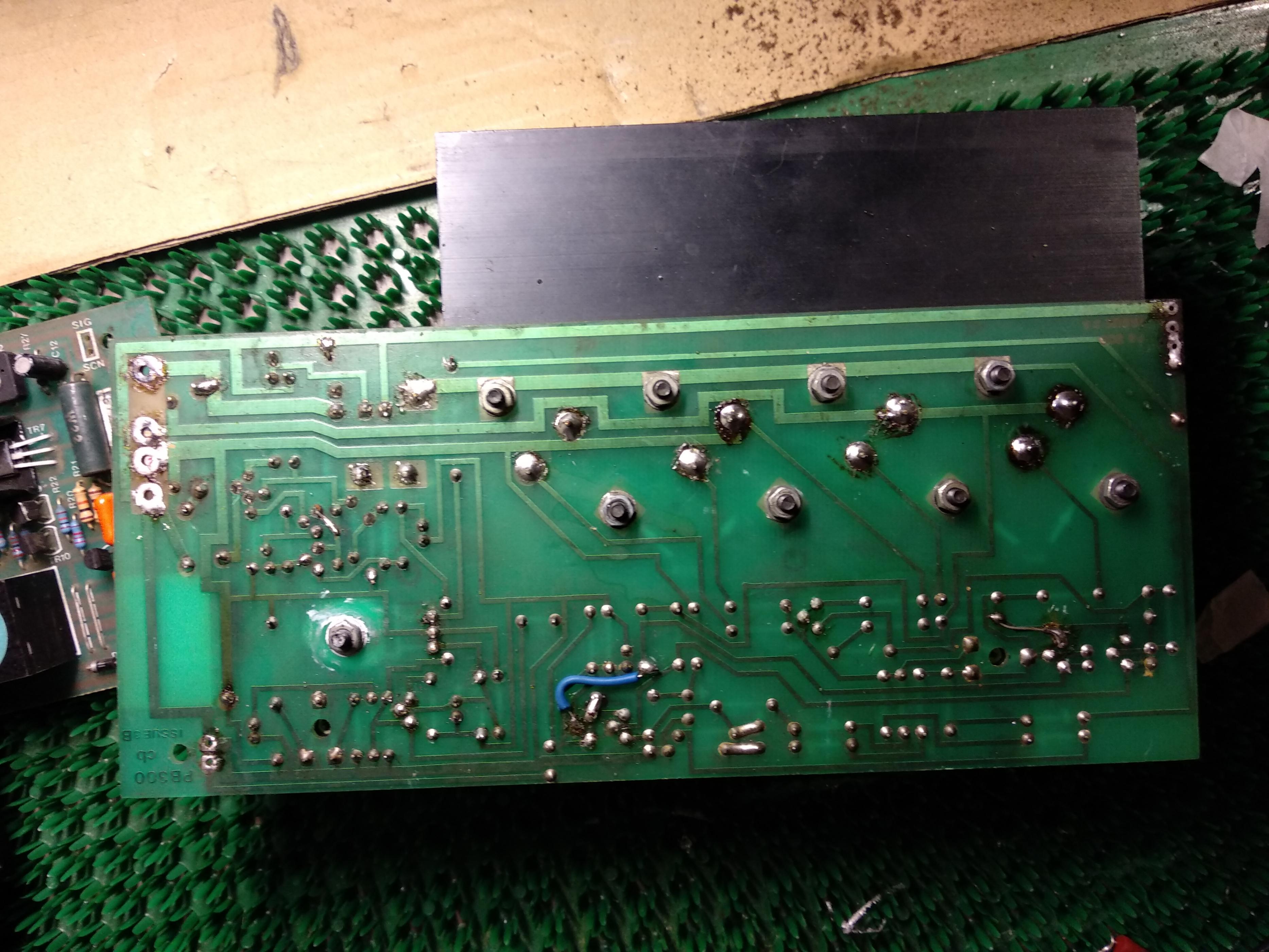

Anyway, here are some pics. Overall, I'm not too impressed. It looks like manual work (apparently "Julian" and "Andy" built this one), even original soldering. Also PCB traces aren't of the greatest quality and like MAAC0 said, there is no DC protection (there is a fuse, but surely something better was available in early 90s..).
Components are of good quality, but then again this used to be a very expensive amplifier. Even now it fetches 500 dollars in good condition.

A little update:
I finally received the replacements, four pairs of BUZ900/BUZ905. I installed everything, powered it up with a bulb in between. No magic smoke, happy!
Anyway, it works again but it needs biasing. Usually there is a description in the service manual, now there is none. As these are MOSFET outputs, the bias current is set by setting a voltage at the gates of the output transistors. However, I cannot measure the current, as there is no series resistor in the output current branches to measure a voltage over...
I tried by checking crossover distortion, but even at the lowest setting I can't see anything visually (that is, with some shitty car speaker as a load and volume at 10%).
Anyone has hints on setting the bias current on this thing?

No big deal, in this case, because Lateral Mosfets are mild mannered smooth and forgiving Gentlemen (unlike their rough Vertical cousins ), not a big nonlinear jump like them.
Usual instructions are just to set "X" mV base into base, in the order of 100 to 200mV, they don´t even care about actual idle current, but to play it safe, do what some do: you cut the track leading to top MosFet Drains with an X-Acto sharp knife, so you create a 0.5mm to 1mm gap, not wider, scratch solder resist on both sides of the gap so you see shiny copper, turn amp ON , no signal, no speakers or any load and bridge both sides of the gap with your Multimeter probes, set to 200mA scale.
You are now measuring actual current through power MosFets only.
Plan B: you bridge gap using a 0.47 or 1 ohm resistor, 2 to 10W, whatever you have available, and measure millivolts across it, to determine current.
In any case, start with minimum bias setting and slowly rise it until you measure some suitable bias current, say 20 to 35mA per power Mosfet.
Once set, turn amp OFF, pull resistor if you added one, and bridge both sides of the scratched gap with a drop of solder.

Hi! Thanks for the reply.
I didn't want to cut the tracks (it would have been quite a nightmare), so I ended up just setting the gate voltage of the N-channels to 0.2V while measuring the total power consumption of the amp.
I calculated it to be about 25 mA of idle current per FET.
Then I did an endurance test, it works without an issue now.
There is still a problem in the preamp (not enough gain) but that's a separate problem, I don't expect it to be a big issue.
