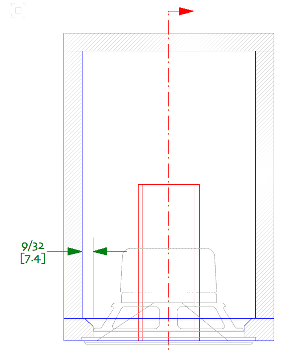

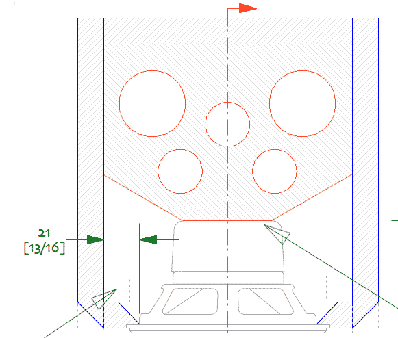

We went thru this when devoping the 1st mFonkens.
This was too narrow:
This turned out OK (3rd try) but still not quite as “open” as the full-size Fonken:
dave
Looking at the image, I'm guessing you have about an inch of space either side of the driver??
As the TD10M is now being used in the midrange only, and I would expect it to stay under 1mm xmax in use over 200hz, does this change anything?
I know Troels did some tests years ago on chamfering the driver hole on the back face, and he came to the conclusion that this reduced the 'cupping' sound.
However, this might actually be a desirable effect as its crossing to a horn with a narrower dispersion pattern....
Can’t findI had to dig deep to find the original drawing (a decade old document):
Prototype
attachment.php
Final:
attachment.php
… chamfering the driver hole on the back face, and he came to the conclusion that this reduced the 'cupping' sound.
Something we always do.
