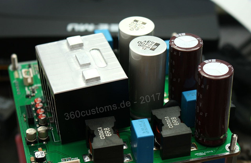

I'm using these with my own boards as well.
attachment.php

looking at the board layout sent earlier, it seems that just adding a couple of horizontal wires from the solder pads on the top of the board, 1cm or so in length, with the supplied caps attached to them (i.e shifting the caps to the top face, and laterally, diagonally away from the inductors.) should allow them to be fitted, assuming the heatsink is removed.
if it appears this wont work i will look at purchasing the suggested alternatives.
now tht is an *extremely* helpful idea!
i must admit im surprised you can remove *all* those big capacitors.. none of them are needed for stereo operation?
that would also have the effect of reducing the overall height to the point where i might not even need to place the big caps on the front face... (consider ill be removing the heatsink, all the bulky connectors for power and output and soldering to the board.)
the tallest elements in this case would be the inductors.

You can't. Even the EVM can't be run at full power for more than a few minutes. The load tests are done with modified active cooled heatsinks.
Beware that the power/thermal pad is more like a heatspreader as the output stage fets just consume like 30% of the pad dimensions, so the heat conduction path is much smaller than what you see on the chip package. That is why you'll need overmilled pollished heatsink contact without any thermal pad.
I'd do the math for 100% load but then derate for real-world-use. I did that in the past, and you'd need something like 0.5K/W which is hard to hit without forced cooling. The actual implementation is doing ~1.5-2K/W passive cooled.
