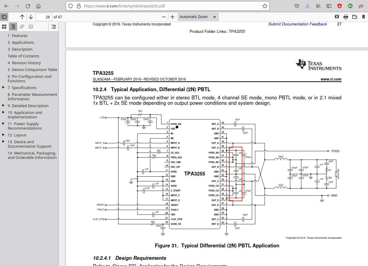

I took a look at the board and it looks like the TI recommended circuit. They have a 22k OCP resistor.
I noticed however that the 4 - 1uF caps near the output of the chip are not populated on the board. I don't know if that could cause this or not.

This might be the PS being recharged by the load, causing the rail voltage to increase past the maximum (OVP) protection. This happens under these kind of conditions with some class-D amps and is called "bus pumping":
https://www.maximintegrated.com/en/design/technical-documents/tutorials/4/4260.htmlhttps://www.diyaudio.com/community/threads/bus-pumping.164953/
Bus pumping happens when charge is returned by the load to the amp board. The SMPS often cannot absorb any charge being returned by the amp board and so the rail voltage rises, and this triggers the OVP on the amp board or potentially the SMPS itself. One potential fix is to place capacitors between the PS and the amp board. The caps absorb charge more than the PS can and this tends to help. If you can just turn everything off and then on again, and it all works as though nothing happened, this may be the cause.
Another approach that would solve this problem would be to use a linear PS (transformer+rectifier+caps) instead of an SMPS since the caps are built into it already.

This sounds like it may be the problem. I have a Peavey CS-800 sitting close by with a couple of big 15000uF caps. I could probably just put one of these across the switching power supply and see what happens. The class D amp board itself has 2x 2200uF caps in parallel for 4400uF at 63V rating. Wouldn't this likely be enough?
