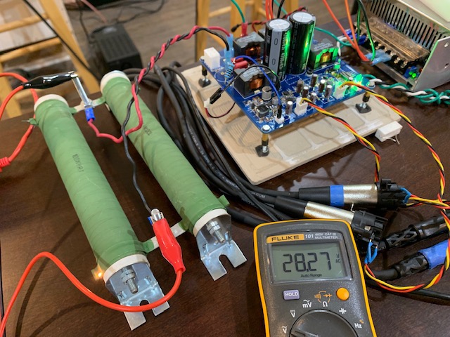

My tests w Connexelectronic 800w 48V for $150 (not free shipping), was surprisingly noisy ( could hear awful hiss), whereas $44 (shipping included) LED SMPS 1200w 48v was absolutely silent. FFTs support this observation.

With the correct current limiting resistor in place, I was easily able to hit 28.27Vrms (200wrms) into 4ohms. You can see one of the power resistors with a local hot spot (left one near end). Will have to avoid these types of load resistors in the future. Only good as heaters as they add a lot of distortion to the measurement and may have unpredictable resistance.

The $44 SMPS 48v 800w (correction from above) did not break a sweat with the fan disconnected on the PSU.

This makes it complicated to give any hint`s for others. You never know what exactly you get next week. Connexelectronic had quite a reputation to work well, but there is no guaranty for two times the same product.
Personally I stick with stuff that is sold in high amounts for quite some times with good or no negative comments, as cheap as I can buy. Aliexpress etc. It takes quite some time to arrive and sometimes it is crap. That is my risk.
I did not use LED SMPS, as they usually are more expensive. Someone told me they where a bit slow in reaction to changing load and have a worse overload caracteristic than others, which are designed for changing load, like CNC motors for example.
In the end it is what you have on your table.
If you need a huge load resistor, make an array out of large (surplus?) resistors and solder them together. If you drop them into a bucket of cold water for the measurement, they will work at many times the load as air cooled. I saw that in some east European video clip... primitive but clever.
