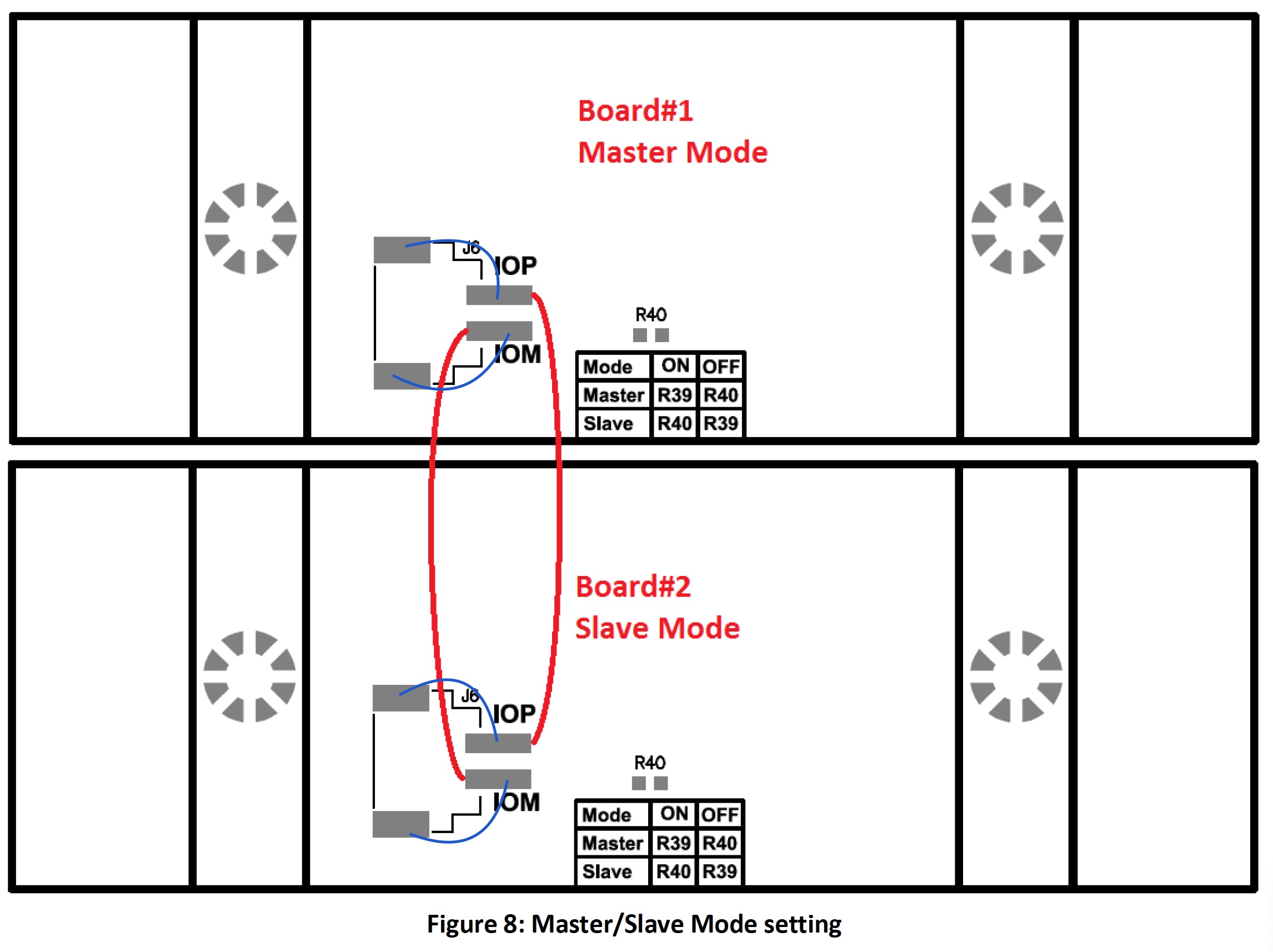

Hi Folks
I have 3 x 3e audio TPA3255, I set them as follows:
1. Master
2. Slave 1
3. Slave 2
as per manual (link below)
http://www.3e-audio.com/wp-content/uploads/2018/07/DS_EAUMT-0260-2-A_Rev1.0.pdf
for the slaves I removed R39 and Added R40 0ohm 0603 resistor (from DigiKey) linked the boards with IOP and IOM as per the manual.
Now master is working but both slaves are not, boards are on but not producing any sound. what else do I need to do add j6? just solder wire? both blue jumpers in the attached image
Also, I'm I set them as SE and there is a bit hiss on zero volume how can I reduce that?

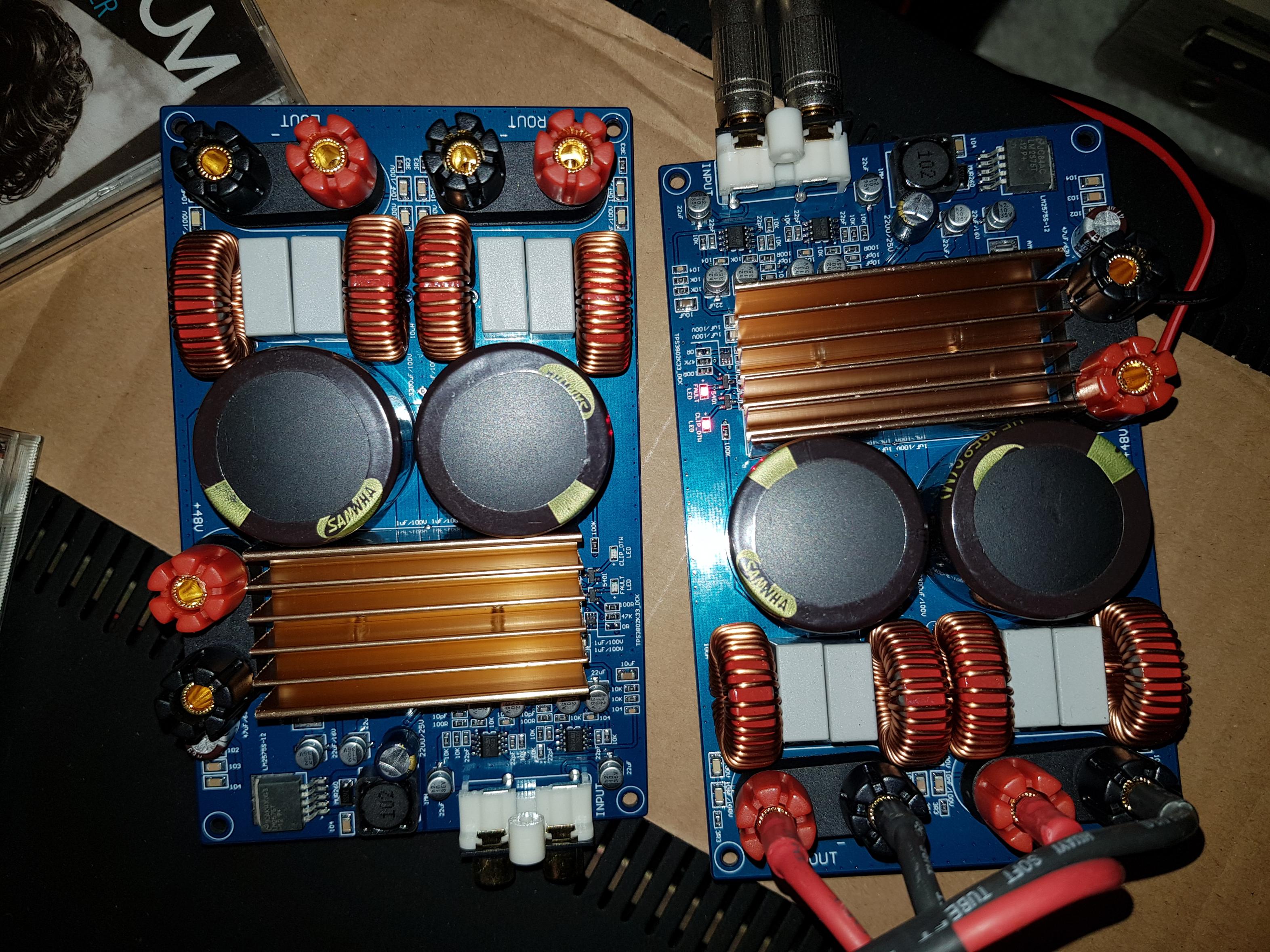

I have bought 2 TPA 3255 s
1st one a direct purchase from Yuan Jing
2nd one via Lazada in Malaysia. It was significantly cheaper . Claimed to have Elna caps .
What i received is the exact same as the earlier one . No Elna caps but who cares.
Big caps are Samwha or something like that
I am using 48V 600W Meanwell switching PSU
No probs at all . They sound good.
I might change a few bits just for fun but they would have to be components that are thru soldered on. I wouldnt dare surface solder as the components are tiny

Page 11 " Please make sure all of these change have been done before power up the boards.Since the board default setting is master mode, so what you should do is set the other one board in slave mode, you can set slave mode 1 or slave mode 2 with just inverse the polarity.Besides, remove the resistor R39(top side, remove heat-sink) and solderR40with one 0ohm0603 resistor, this also marked on the bottom of the board show as below.
Slave mode 1: (Figure 8)Connect the master OSC_I/O to the slave OSC_I/O with same polarity (IOP to IOPand IOM to IOM).
Slave mode 2:Inverse the polarity of OSC_I/O(IOPto IOM and IOM to IOP)"
You could have used a piece of wire or just a blob of solder instead of a 0ohm resistor. But that won't matter.
Did you connect the wires (red lines) from the master to the slave boards?
FYI I'm using 2 of the same boards with the 3e audio dsp without any noise, both running as master sharing a 24v or 48v power supply.
Did you twist the SE input cable any keep it away from noise?
I did connect the wires (red lines) soldered R40 and Removed R39 but it never worked the boards are on but no sound.
Then I connect J6, the master board fault LED was blinking. So no joy either.
I had to reverse everything back to master but I lost one R39 SMD, do know the value of that?
Anywho, I revived one board and one still down due to R39 thingie.
Noise is gone and everything is silent.

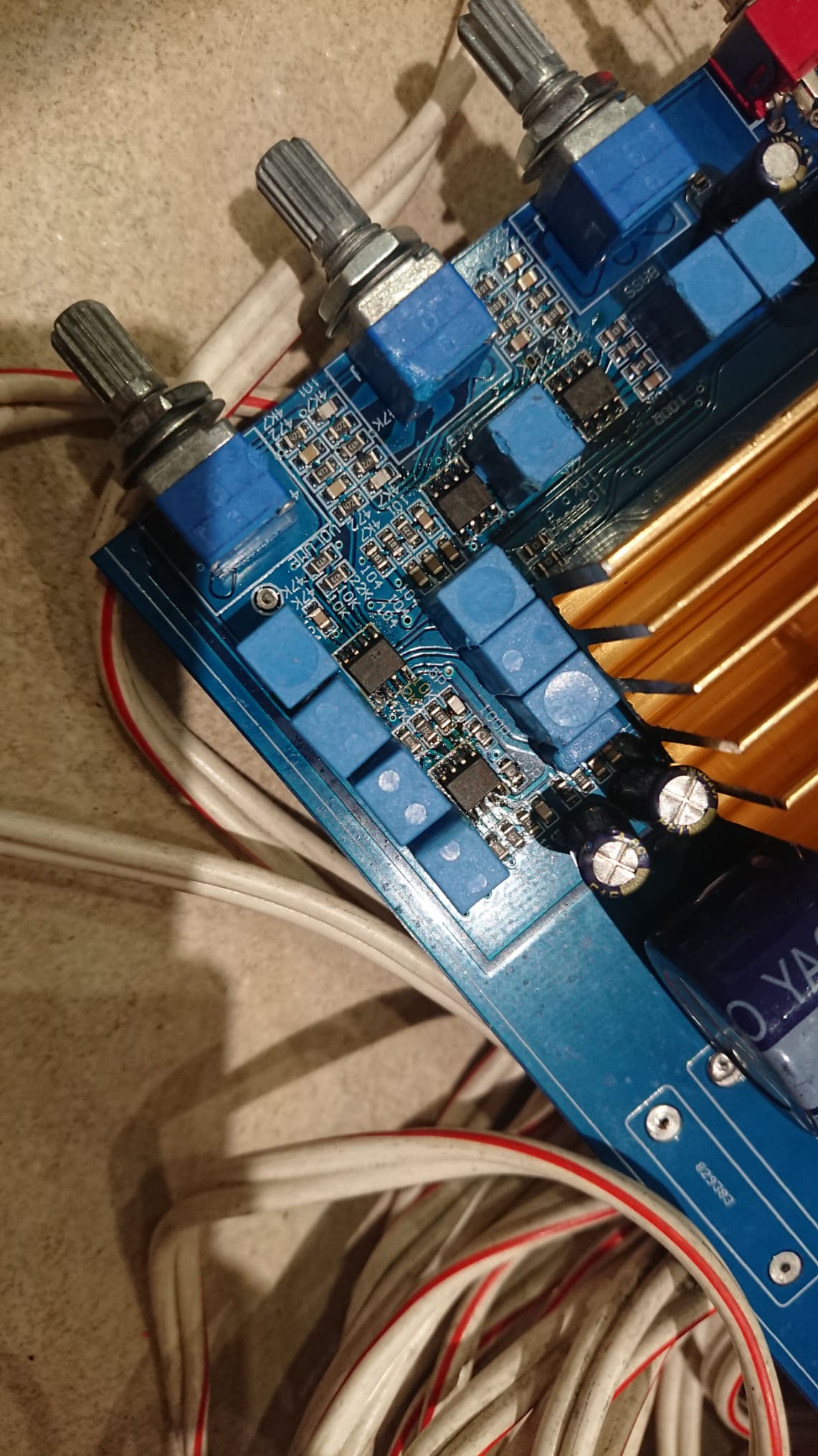

I just changed fake NE5532 for original NE5532. I think some changement on Bass and High adjustment are the result.
My DC-DC converter dont Step-up... I don't know why.
But amp is really good. After this changment and with the true capacitor size its one of the best china amps.
:-D

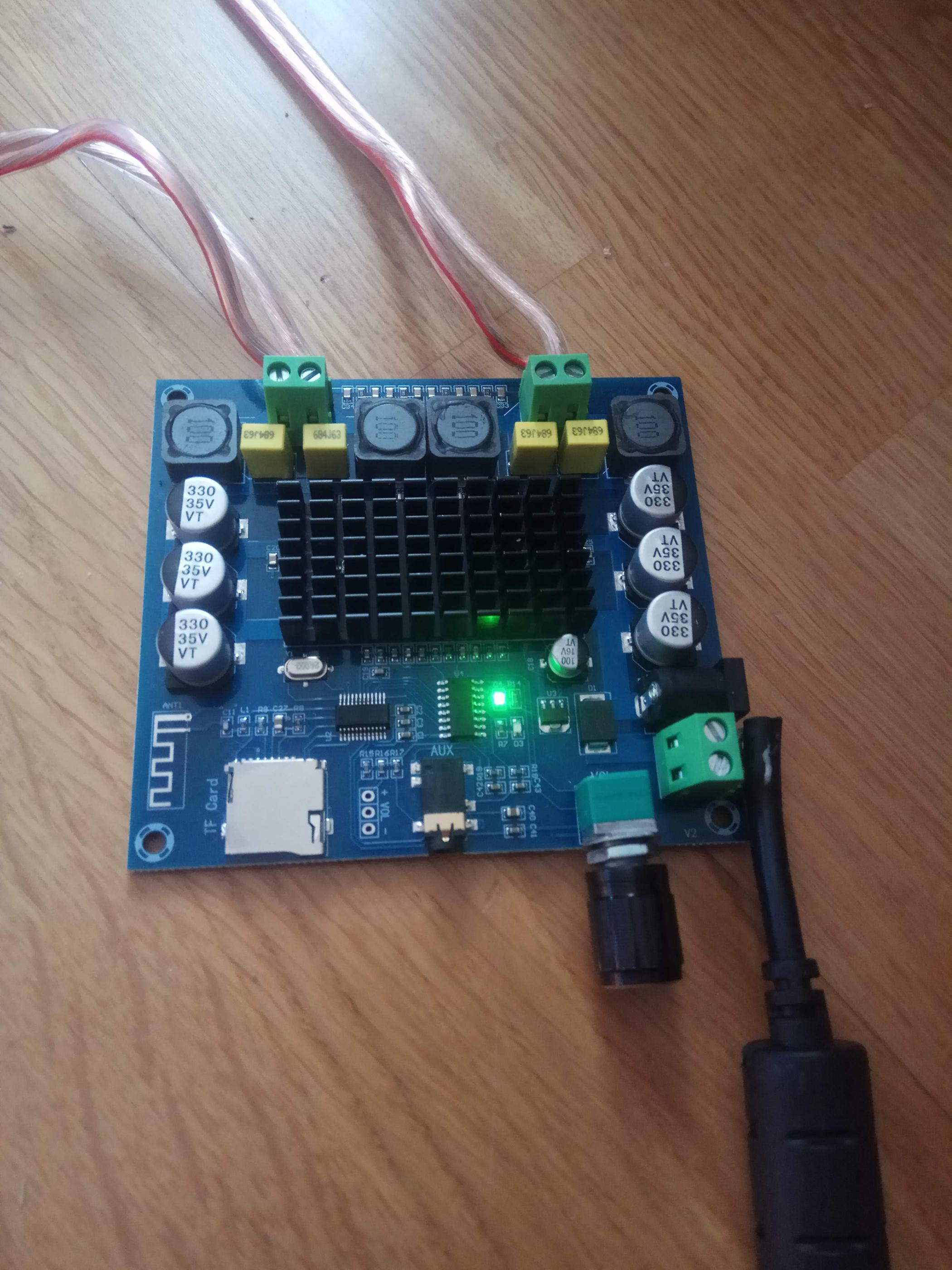

Tpa3255&tda7498 who is winner?
Hi mates again from Ukraine. There was some changes in my setup since my last input here.
Was Canton SC-L + tpa3255 blueboard with Bluetooth in black box . Chip have been fired and replaced by new one successfull. The amp was supplied by dc48v/1200w unit and by laptop brick from laptop 150w/21 volt without significant sound stage difference.
Sold out all these staff.
Now have : B&W DM603 S3 + blueboard tda7498 with aptx/Bluetooth 5 onboard (9$ on AliExpress) supplied by 150w /20v brick from laptop. This setup is sounding far better than previous one in approx 40 sq. Meters room still dont know why because the figures in wattages of amp and Canton speaker datasheet saying they outperform b&w+tda7498. But result is somewhat i didnt expected.

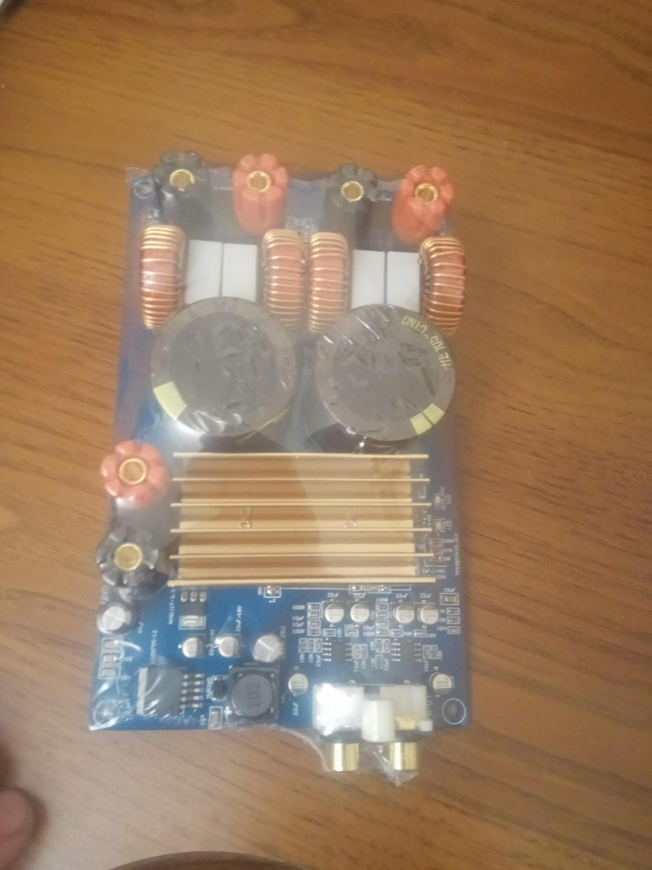

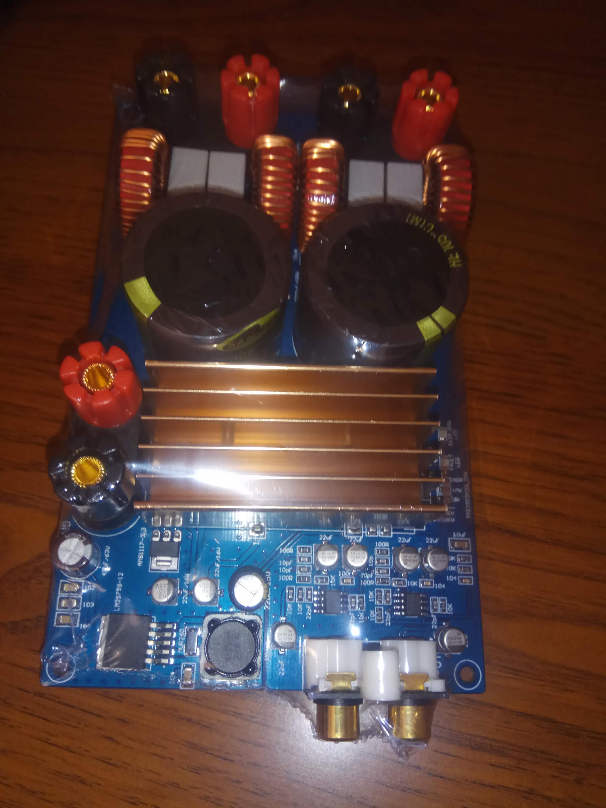

Got tpa3255 board today . Of course no Elna caps, just samwha 63v/4700mkF but who care? Without doubt this board is outperform all my previous boards I tried: tpa3116, tpa3116 doublechips, tda7498, tpa3255 blackbox with Bluetooth 4.0 . And oldschool Marantz sr6400 (100w#8hom). This is the first time ever I am afraid to turn volume knob more than 60% on B&W DM603s it is getting very loud endeed without distortion - the right way to burn out tweeters on sudden music peaks.
From the other side I found the heatsink is 50 celcium degree , checked the thermopaste it is ok. Does anyone checked the sink temperature? Think 50 degree on almost idle level is not ok, what do you think mates?
This board is deadly silent. Think will keep it for a while before icepower or hypex arrival

Founder of XSA-Labs
Joined 2012
I have tried same board and the error lights are always on by default when working. Does yours do that? I was unable to get more than 48Vpp out of it in BTL despite the PSU being 51v. Oscope shows it clips at 48Vpp - not sure why that is. Should have been able to go to 80Vpp easily. Please let me know what your max output is without clip.
