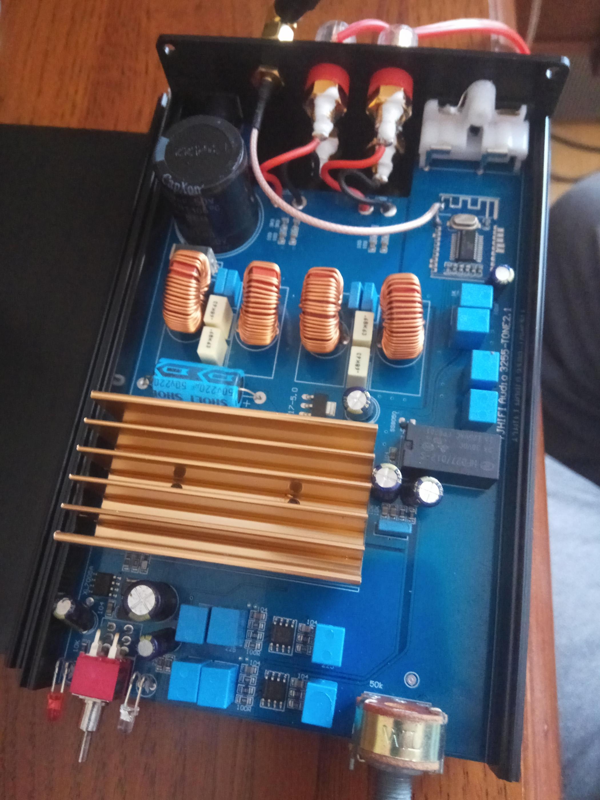

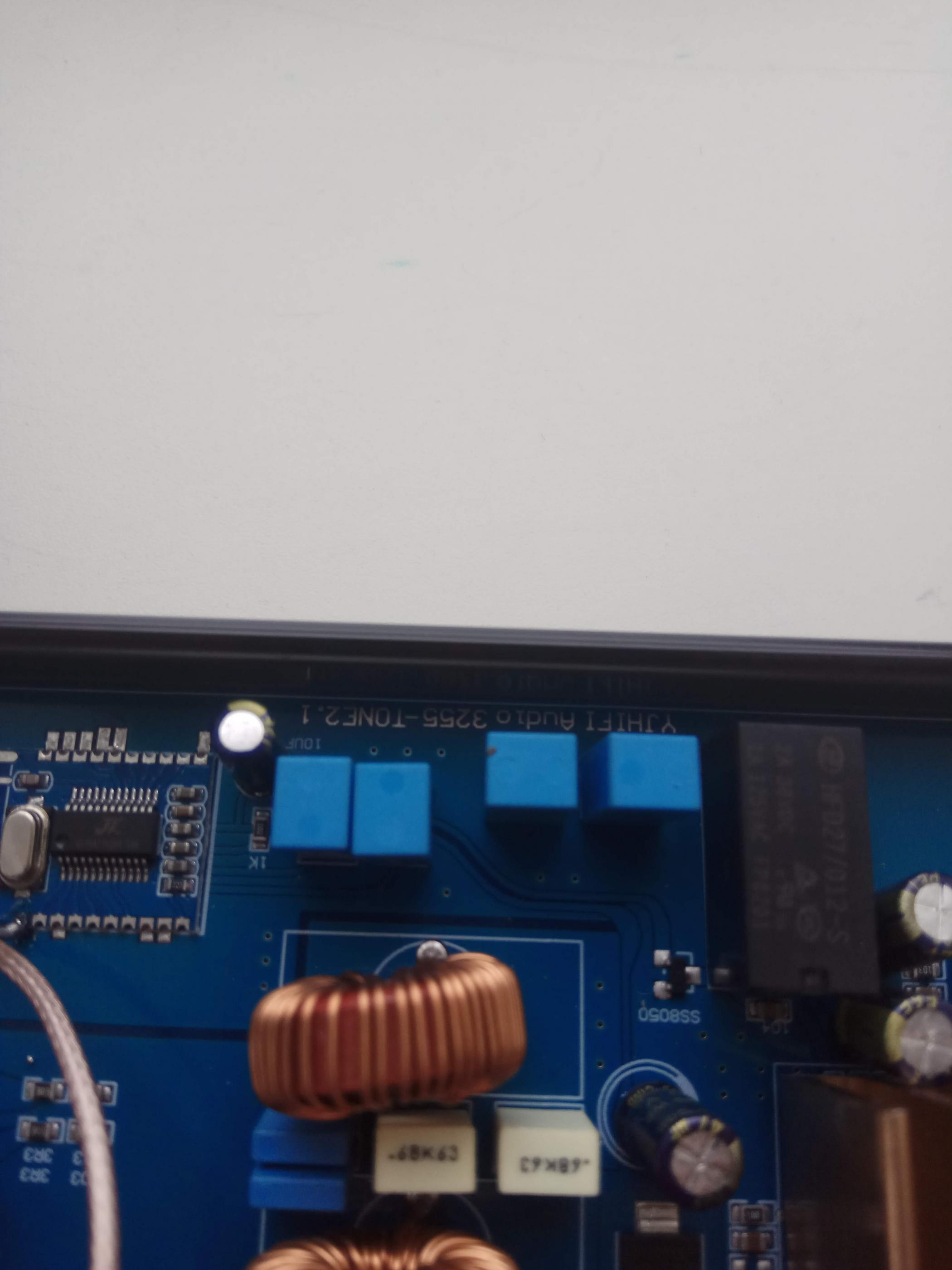

Hi, there. Just opened amp to enable see mates inside. For my experience this looks very budget friendly interpretation of original board. Even main capacitor rated 50V with no reserve for voltage. Im getting nervous since sorcing 50V dc. take a look guys and what are your advices for quick win improvement in my case. Have no precise problem with how it sounds but ...you know we are buying these things to keep on improveing.

Hi Anatoliy
thanks for your pics. (use the smartphone at HDR mode to get sharp pics;))
is it possible to dismount the heat sink and make a pic -we can compare to the other TPA3255 board
pic 1
in the first pic in the bottom there should be the the opamps. I miss the decoupling caps for the power of the op amps....
i read that the Bluetooth made a lot of his...how it is handled here at this amp? i see no switch to choose between bluetooth or RCA input?
is it possible to disconnect the bluetooth module? and compare with/or without bluethooth in soundwise
chris

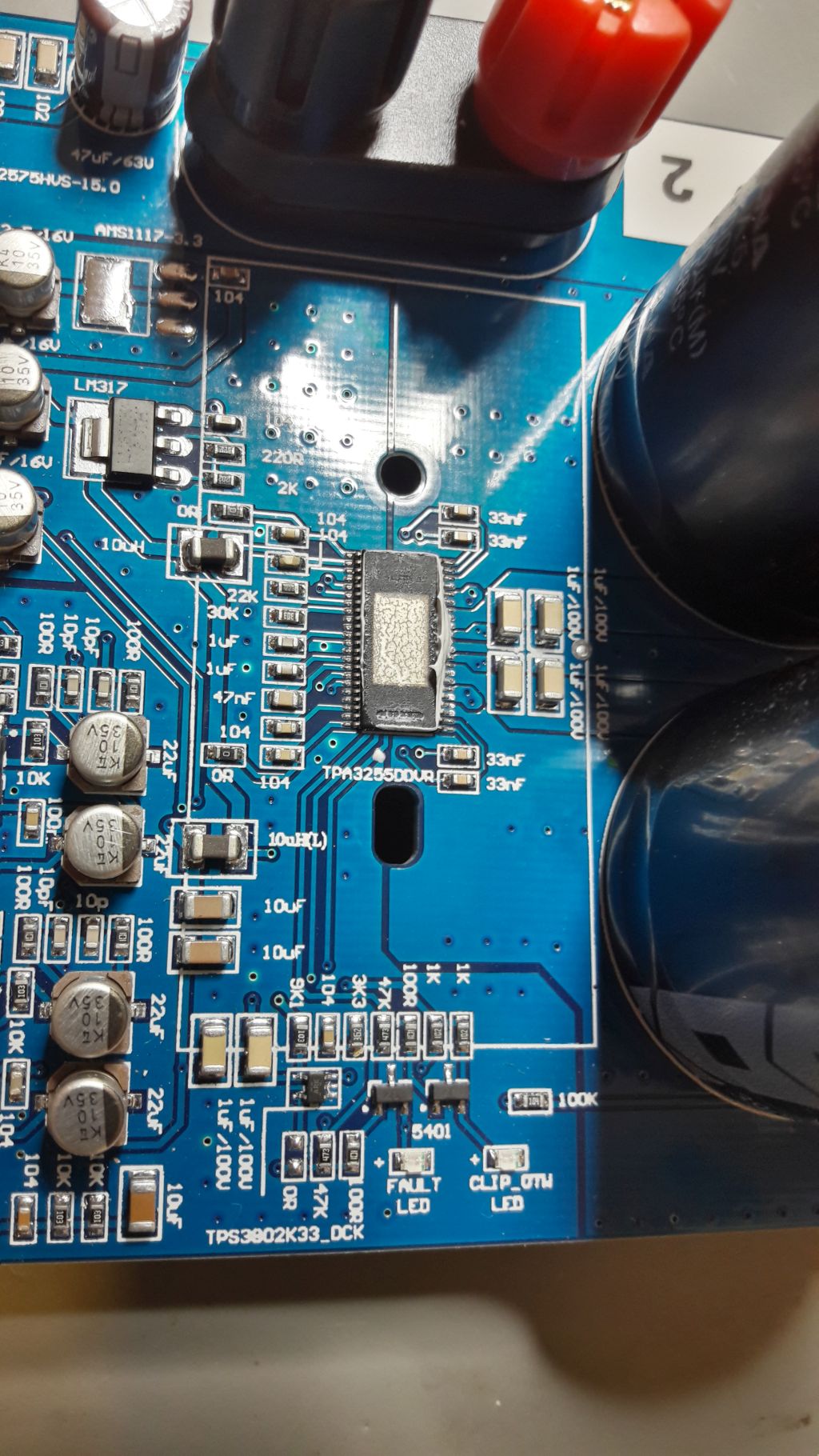

your SMPS should have a poti to adjust the Voltage setting...set it down and then connect it to the amp again.
Not sure dismount heatsink will safe procedure for me. Think thrte should be thermopast inbetween tpa body and sink which iam not in position to look for and put again. BT on device is connected by default just chous from device you are about listening phone/ ipad / xiaomi etc. If no BT connection it switch to rca input . The connection handled by relay , i suppose to due click sound during switching. BT is rsther silent , no audible hizzz. Some hizz within 5-10 cm from high frequency speaker with 90 db/1w/1m sencivity which is quite good for me. Previous board Tpa3116 was deadly silent but this device is ok. Will check if there is less hizz via rca against BT.
