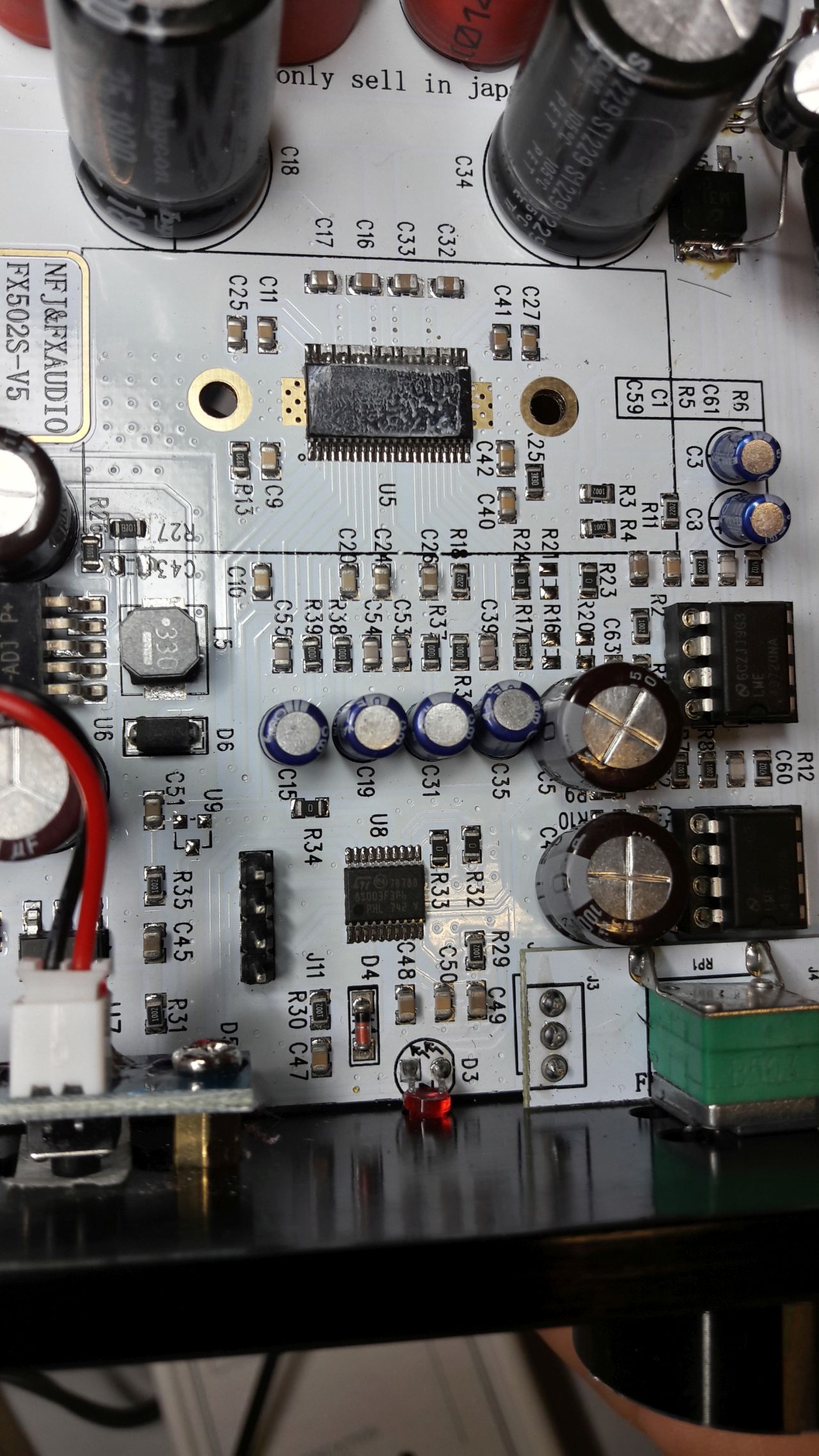

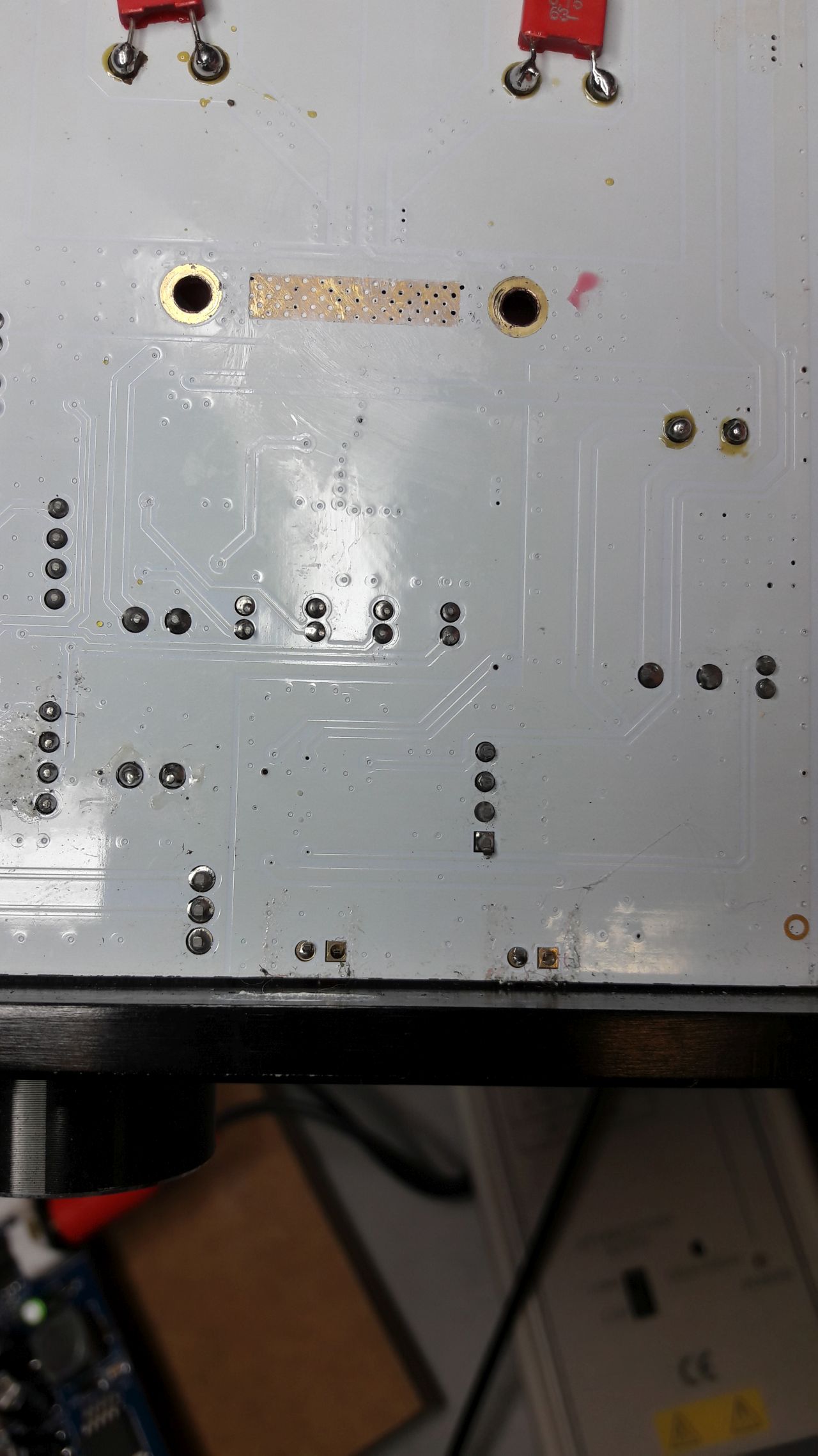

Thanks for the compliments and pictures. Would be great if you can take them front/back with heatsink removed to see all traces and bias with much (soft) light to keep noise and exposure time low to have it nice and sharp. This amp doesn’t feature a voltage supervisor at all. (Or am i blind?)
Then i will put all annotations in where to patch.
Thanks a lot.
Chermann - Chris, notice you have such a strong passion for improving FX502Spro. I am out of town this moment, could you help to share if you have a front pic of FX502Spro full PCB without heatsink for doctormord? ...please...thx

sorry the PCB is coverd with a thick pianting so backlight is not able to view the layout. the same is with the blue_v3 pcb board.....
i try my best to light an make a contrast as good i can...but i think its not useful to track the pcb.

do you ahve troubles with on/ off pop? my amps are quiet.
no moding needed.
chip is U8- the chip for switching on/off?.....i dont know...
label
ST 78788
85003 F3P6
PHL 742 Y

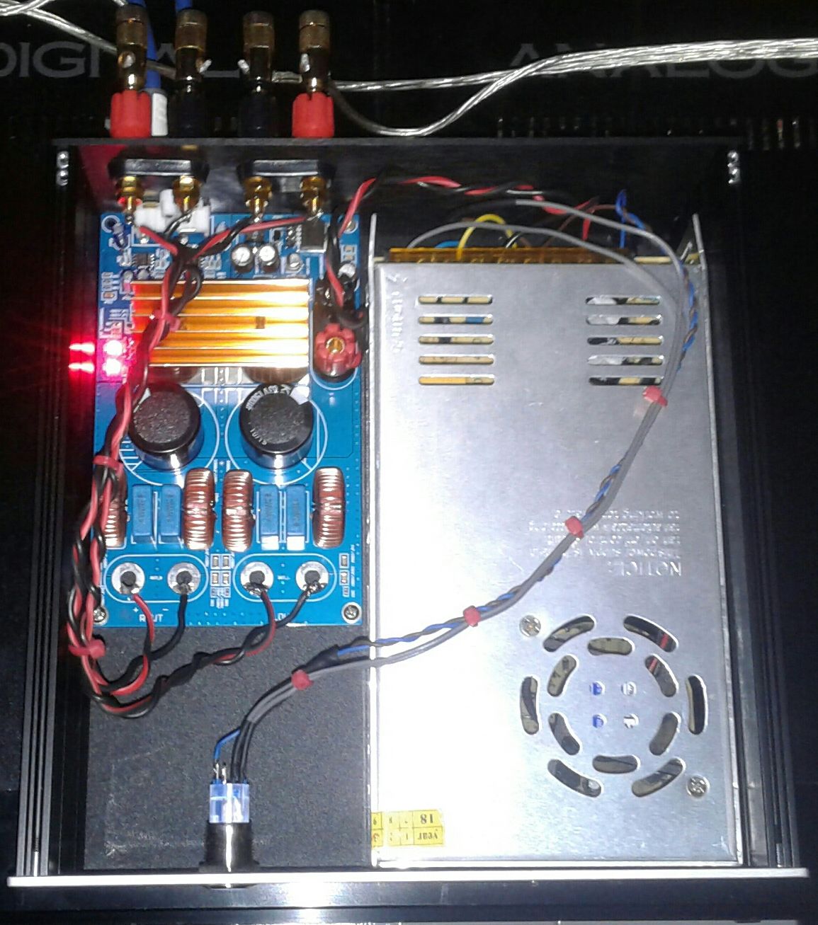

Thks Chris for responding to the call. I provided a similar partial pic without heatsink, doctor told me he need a complete front pcb pic.
my FX502 V3 gives a loud off-pop, not sure what is the cause?
(am running it off a SMPS of 31~32 volts)
