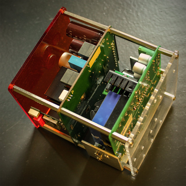

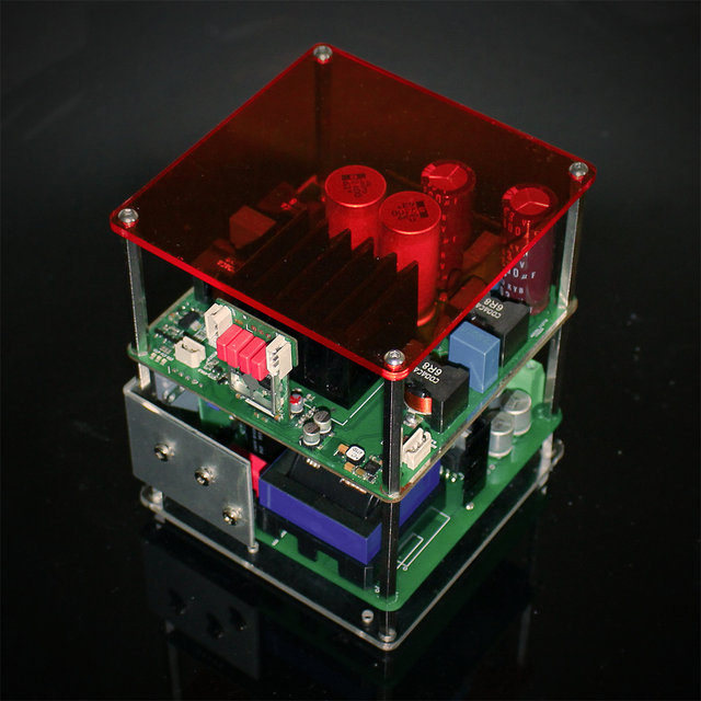

Somehow i missed to post the marriage of our TPA3255 design with the Voltwide LLC supply in a stackup. With the correct length for all distance bolts, it would fit into a 10x10x10cm cube. :D
attachment.php
attachment.php

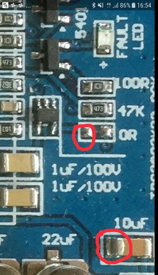

You may use the SHUTDOWN function of the amp to mute while power-up/down.
I once made a fix for the blue PCB version like shown in the picture.
685128d1528216679-tpa3255-diy-discussion-design-etc-29855214_629323700732435_823307045_n-jpg
It's located on the right side next to the heatsink. If yours look different, send a picture of that region.
Wire a switch between these two points for manual muting the amp.
