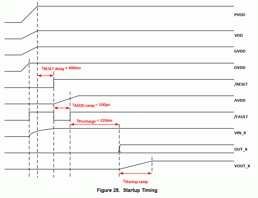

Also there was some discussion about input coupling cap charging. The caps won't charge when /Reset is held low, because the AVDD regulator is disabled to save power under reset conditions. Therefore precharge happens during the 200ms after you pull /Reset high. The caps charge to around 3V through a resistance of about 3K, so you can figure out the RC time constant. About 7tau is what you need for pop-free startup. After precharge is done, input resistance reverts to the normal value.

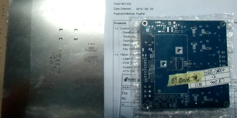

Hi doctormod,Beisde that, boards left the fab.
I've just received today my boards for 50ASX2 buffers, they where posted the 30-08-15 by Elecrow.
So shipping time was about two weeks to France.

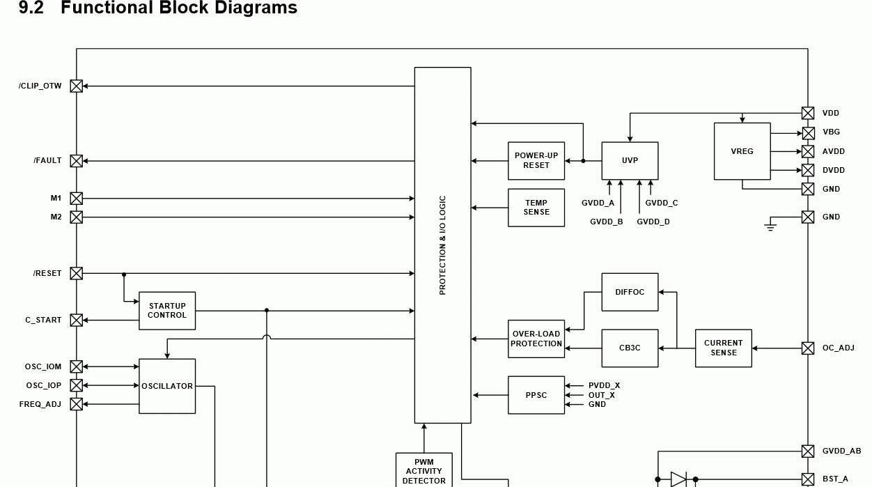

Increasing Cstart for better PSRR makes absolutely no sense to me. (From the datasheet and functional block diagram it only times startup ramp)

You can learn a lot from e2e. Cstart voltage tracks PVDD (try it on your board). It's the common mode input for the input stage. TI may be able to provide PSRR measurements on e2e if you ask nicely
Cstart is the input common mode? Sweet.Hi Doctormod,

Oops, sorry. Correction: It's not really the common mode. More like another input to an inverting summing amp, with a fixed reference on the + input. Therefore it can't be used to eliminate the Cin caps. Moving Cstart voltage does change the common mode DC output voltage though.
But then the datasheet does not show the truth..
Would you mind to explain how this pin tracks PVCC?
C_start (Output): Startup ramp, requires a charging capacitor to GND
isn't the "tstartup_ramp" directly relating to Cstart? If so, i don't see any PVCC relationship.
