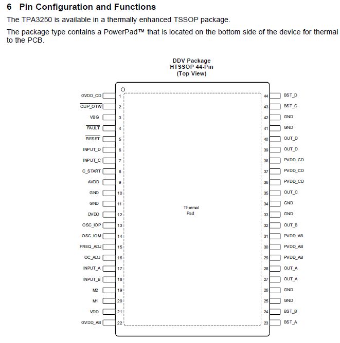

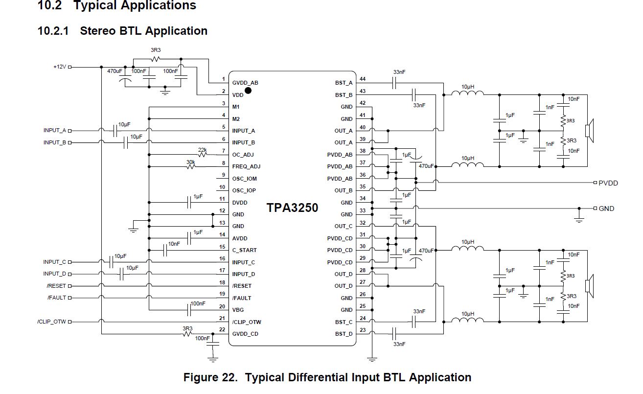

..Wrong datasheet TPA3250...april2016
i want ot look at the implementation of a bigger cap e.g. 470µF at AVDD
i found that the chapter 6 and the chapter 10.2 show different pin layouts!!!
pic 1 is the correct pin layout of tpa3250
pic 2 is the wrong BTL-application it shows the TPA3251
TPA3250 and TPA3251 are mirrored at pin 8 9 and 14 15 !!! (irribeo told me that a long time ago..;)
chris

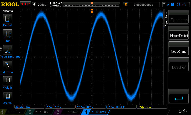

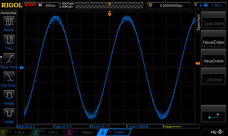

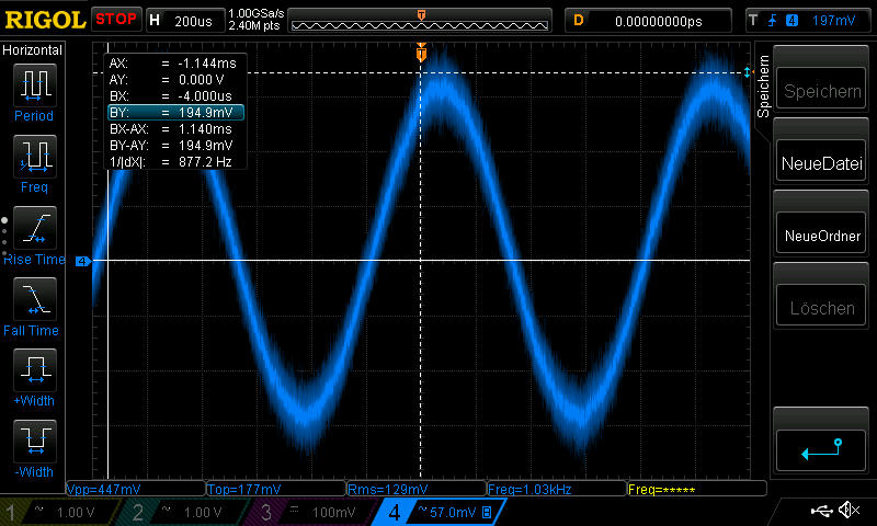

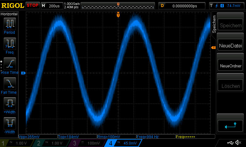

Hi
24Vpsu -1khz tone into rca R+L..8R load
knob at 1 o´clock give me the input on the opamp exactly what i set into the rca input = 100mvrms - pic 1
output is 6,8Vpp ...Gain is about 33 dB
knob at 11 o´clock give me about 50mVrms at the opamps with 100mVrms input and at to output 3,76vpp..its 34dB gain pic 2
knob at max give me about 209mVrms at the opamps with 100mVrsm input and at to output 32,9vpp..its 32,3dB gain pic 3
so the tpa 3250 has a gain of 26db so with this opamps config i get about 33db so its 7db more gain

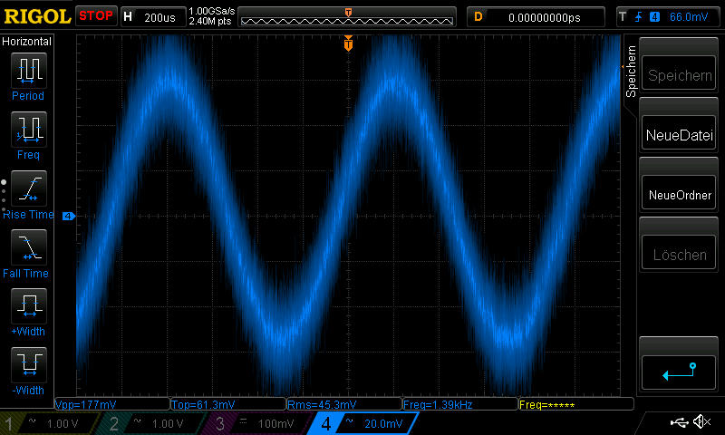

800mV input and the knob at the max give me the clipping at 24V with 45,6Vpp at 8R...pic 4

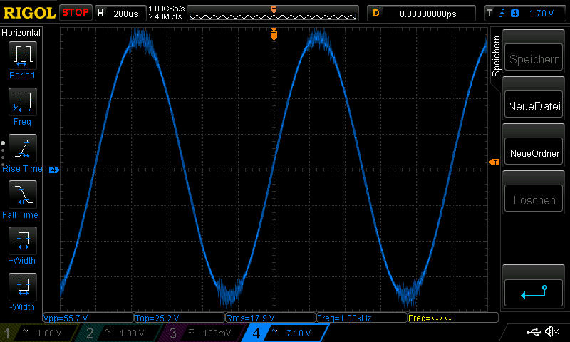

pic 5 is a test of asymmetric signal on the opmap..not much but visible...why?
pic 6 is with 30V/6Amp psu and 820mVrms and knob until clipping and 5-10seconds the amp switch off.
55,7Vpp ...8R= 48Watt
chris

Interesting gain measurements, thanks for that! they probably designed amplifier the way so also weak mobile phone signals can drive the amp to full power.
and ohh that class D.... it messes the signal quite badly :D a lot of ringing or jitter or what the hell is that, doh...
Your test with 30V PSU is interesting, were both channels driven or just one? turn off is it due to heatsink temperature or just chip not capable to dissipate heat into the heatsink fast enough? have you tried 30V PSU with normal musical signal (not continuous sine wave) if that turn off too?
Hi Wiliks
I am happy with your comments. that nice that you read my posts and give feedback;)
partly the signals getting messy with the modulatet carrier frequency of about 480khz PWM.
i always power both channels continiously 1khz!

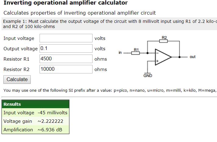

from post 775
is that correct?
so the volume knob- potentiometer is a voltage divider for the input and the inverted opamp has a gain about 7db....correct?
which values should i find an the pcb to get this? can some fresh brain and expert help me?
thanks chris
