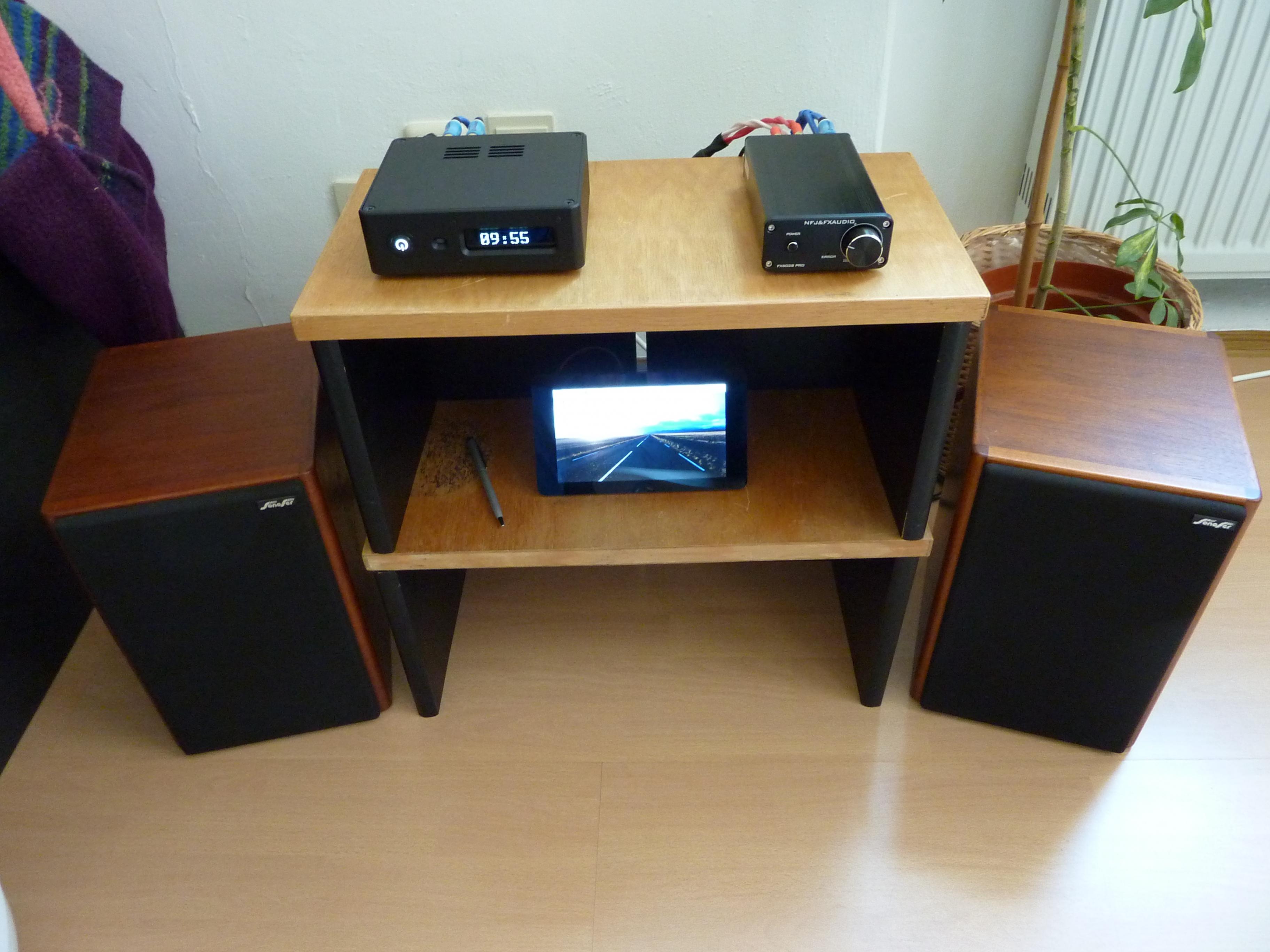

After reading all 66 pages a FXAUDIO FX502SPRO TPA3250 ordered + 2x LME49720NA .....
I have to say that the sound is very good ....;)
Moodeaudio is installed.....:)

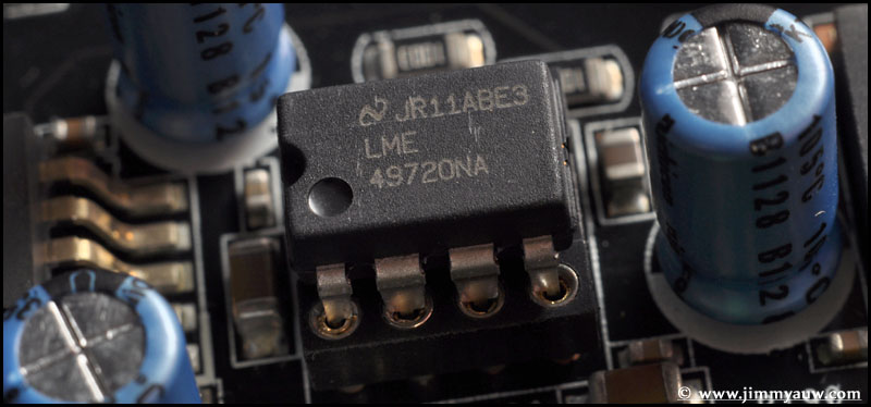

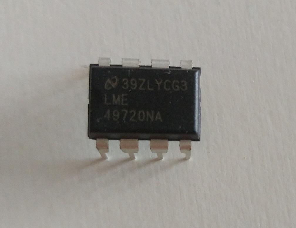

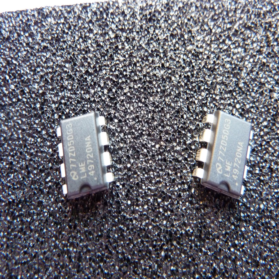

Howdy Cardone, I also bought some LME49720NA for my FX502SPRO
For the sake of my authenticity verification, how does your LME49720NA look like?
Top# Element14's or Bottom# RS-online's
