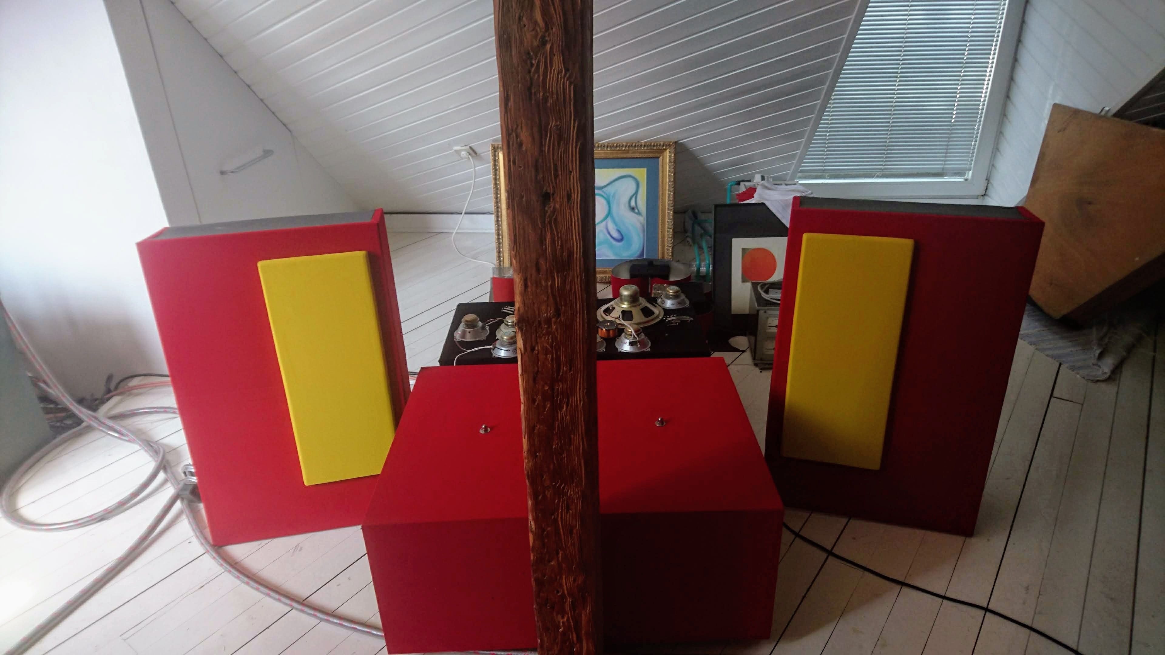

Hi.
i tried 3250(FX), 3251 and 3255 and the winner was
FX with 3250 chip.
All three boards are modified with the lme49720 chip and the FX runs with an connexelectronix powersupply.
My speakers are sensitiv with 98dB/watt. But also with speakers at 90dB the Fx imho
was better.

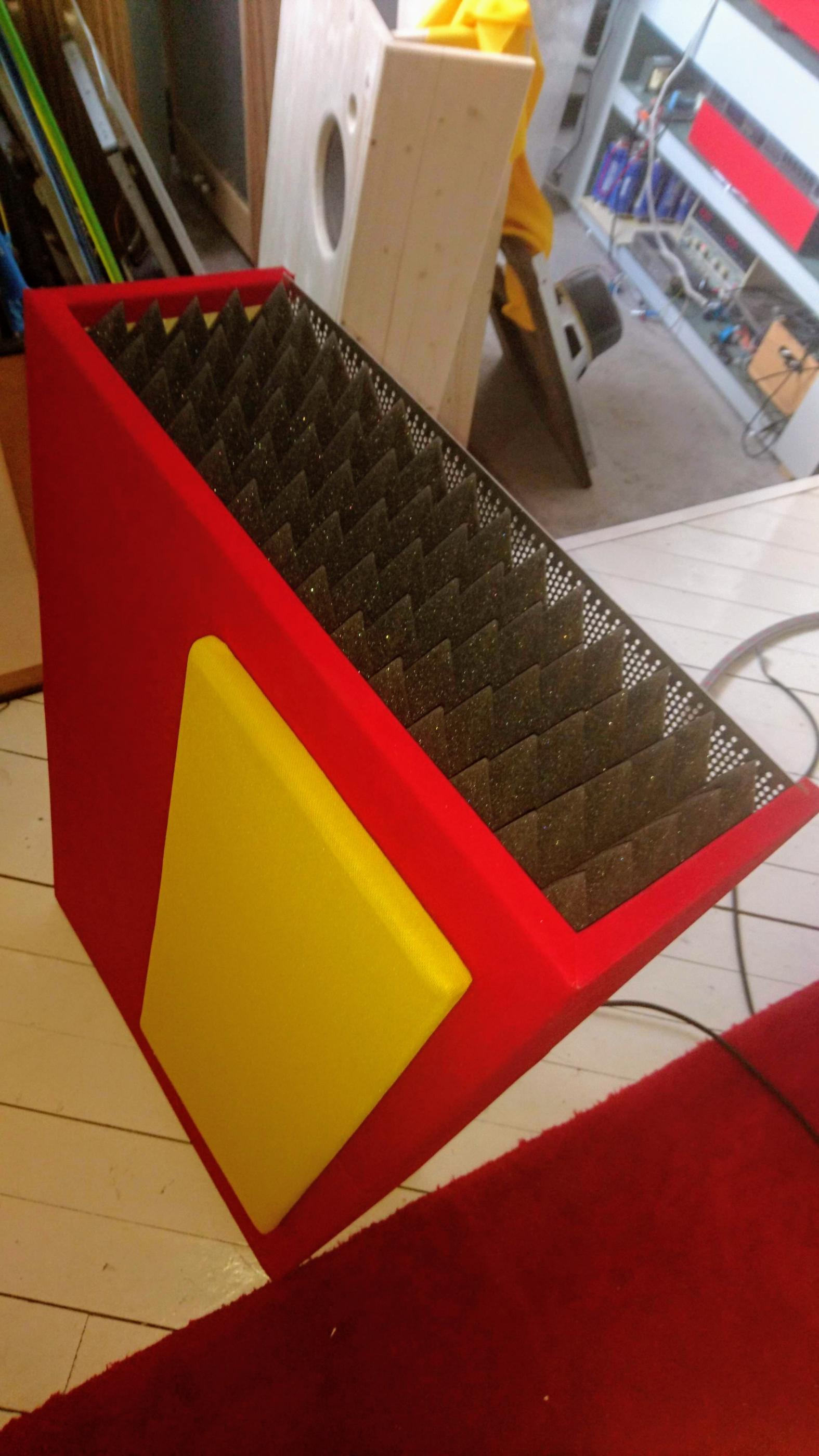

To Lorenzo
the Sachsenwerk openbaffle
Hi Lorenzo
My speakers are a pair of sachsenwerk fieldcoils in open baffle and an other open bafflespeaker
with jensen F12N fieldcoil and Amt 1 from Heil.

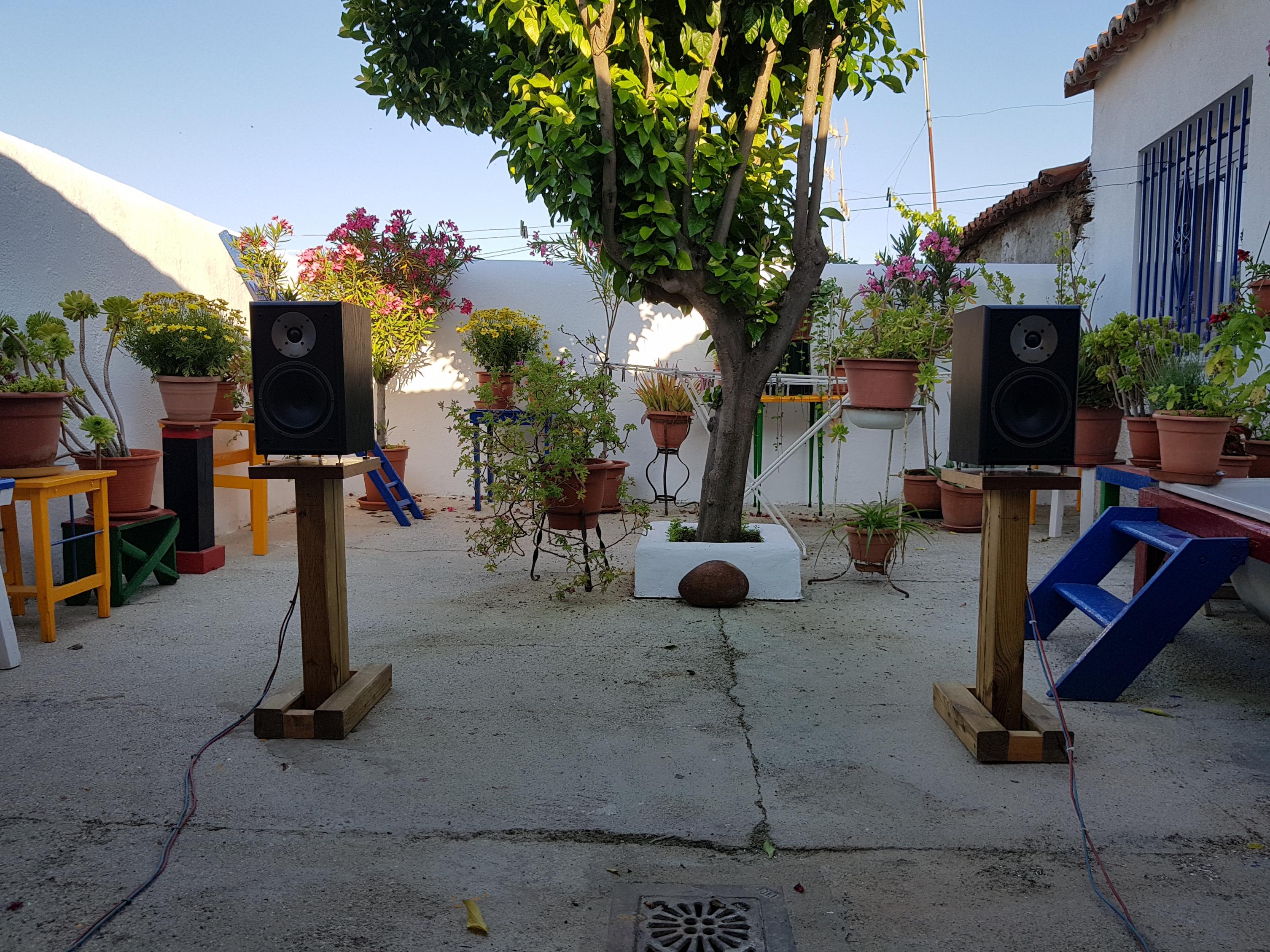

Hi Krautxy,
Thank you very much, I made somme research on internet because I had never heard about such speakers :eek:;)
Very impressive ferrites at the back of speakers ! I had heard about open baffle but never see or heard such a system .
It sounds to me rather high end DIY and "reassured" ;) if I needed that you use as well a FX 502S customized.
I imagine you don't have to set volume much higher to move your speakers with 98dB/W !
Nice colors too, like the spanish flag.
German Magnat brand has not a large audience in France(i'm french) in the audiophile circle, and distibution products almost confidential.
But I think they are great ready made products in terms of price/quality.
Happy with my Magnat supreme 2002 in it's category, and I have as well a pair of bookshelf Magnat supreme 202 to listen outside
in my patio. I dream about a pair of Magnat Quantum 1009 S .
Test Magnat Quantum 1009 S : S comme sensationnelle ! | HDfever
