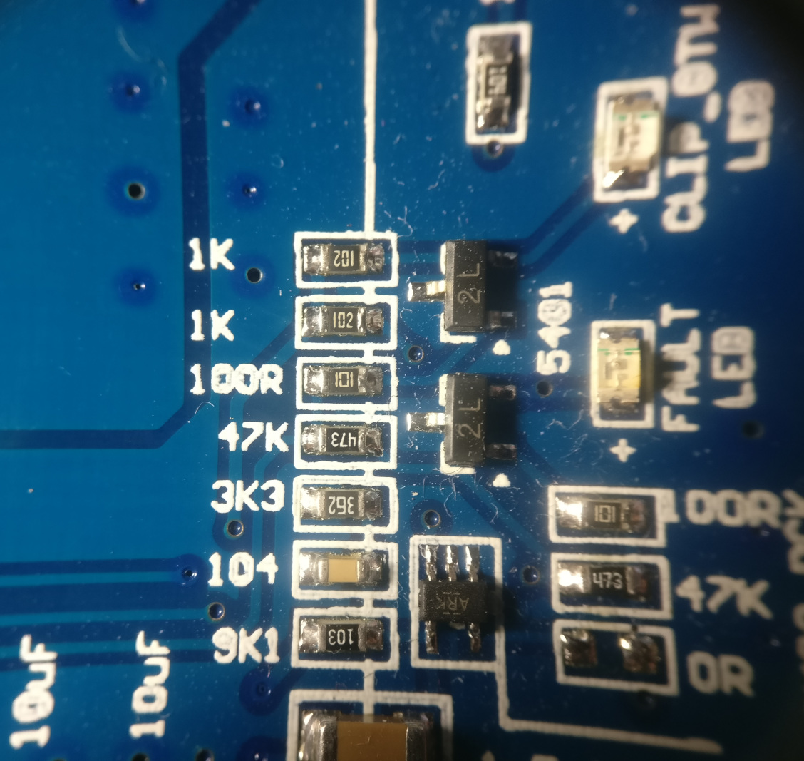

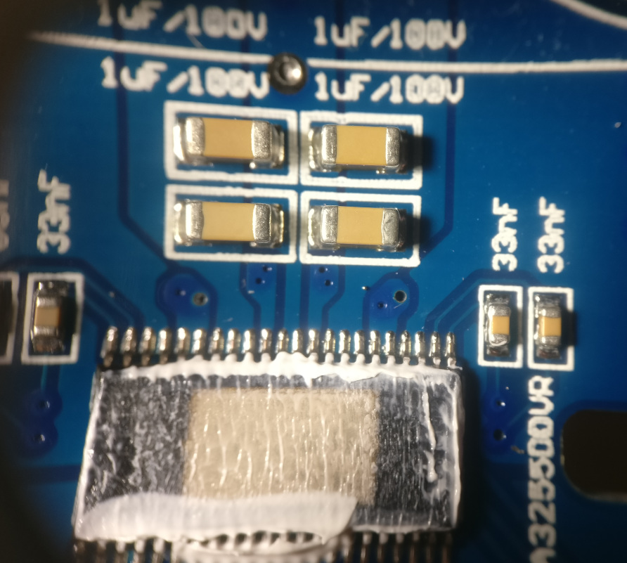

TPA3250 somebody is listening?

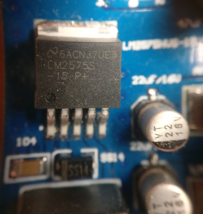

...With the FX I would also prefer dumping the voltage regulator components, as I am already running off a variable linear PS and would like to be able to adjust operating voltage. I do NOT recommend operating the FX on anything other than its normal 24V-- even on lower voltage the components will get hotter as the regulatory circuit probably tries to step it up to 24V. It didn't destroy my amp fortunately but I noticed it only really runs cool at 24V no more no less...
jigglebones, just curious as you are running off variable linear PS - dint you configure to provide 24v?
I am not using the factory's 24v SMPS on this FX amp, instead my PS provides 32v. You noted regulatory circuit tries to step it up to 24V, what was the on-board regulator chip that does it? do you mean even the back-stage power output speaker stage voltage is regulated step up/step down to 24v, instead of driven by whatever voltage coming from the PS connector?!?
Having switched to LME49720NA in my FX audio amp I can say that the NE5532 does significantly hold back the potential of this board...
Jigglebones, another matter to clarify as i consider your LME49720NA swap on FX amp, as i measure the Op-amp socketed Vcc pin8, reads 24v as supplied by on-board LM2596HVS.
existing NE5532 can take 30v, but LME49720NA max-out 17v, wouldnt the 24v would have killed it instead?

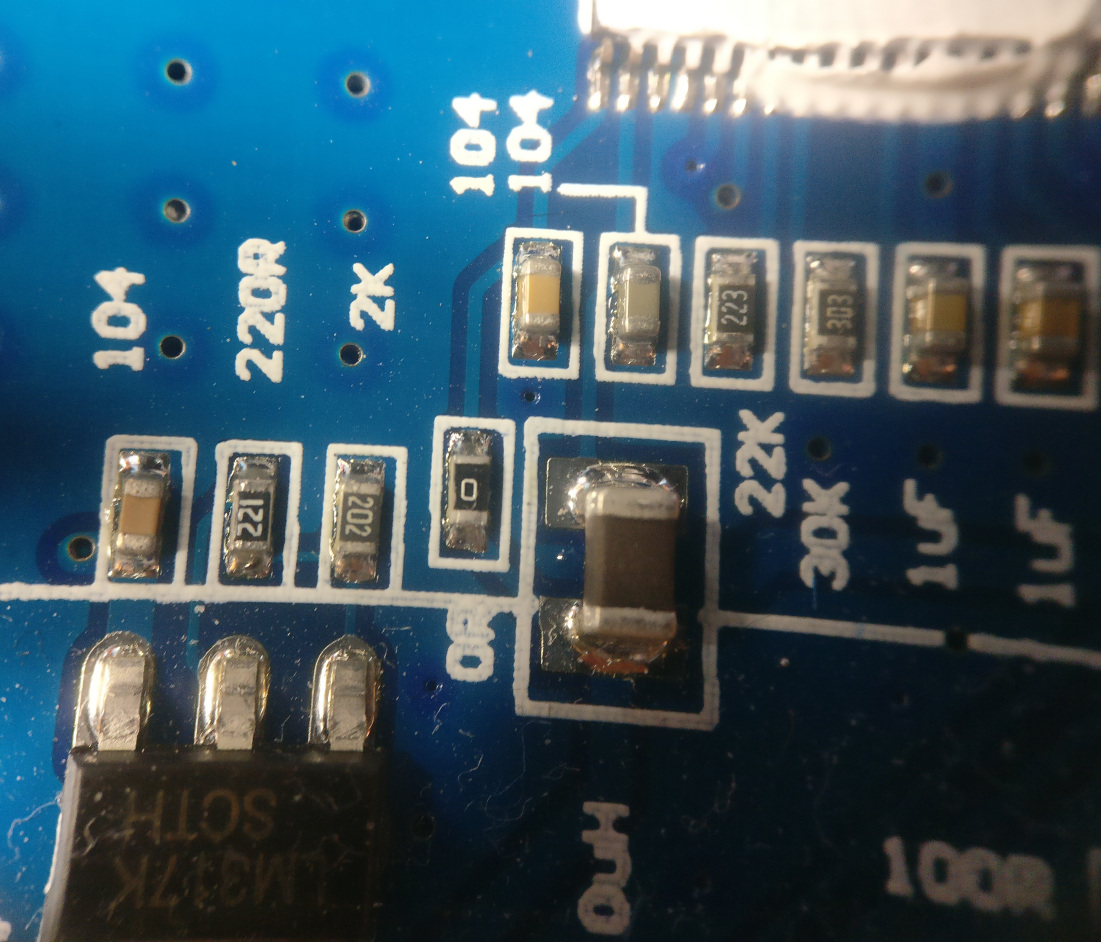

The FX Audio FX502SPRO uses a LM317 regulator to step-down the input voltage to 24V single rail DC (single-supply DC) to the two unbalanced to balanced converter OpAmps. If sums up the +- supply voltages of an OpAmp is equal to or more than 24V DC, it is safe to use in the amplifier.
This board is direct step-down the input supply voltage to the OpAmps. So uses a cleaner DC supply will make it cleaner output.
There are used 35V DC capacitors on the power lines. The maximum power supply should be 30V DC, although the TPA3250 can be supply up to 35V DC.
Yes you right.
I am using the factory's 24V SMPS on this amp. I opened the amp to replace the 2 TI NE5532 to 2 JRC NE5532DD last night. I used multimeter to take the voltage readings on the regulators for reference. I find that the LM317 is directly use the input supply DC voltage to step-down voltage for the OpAmps. The 2 program resistors for LM317 onboard are R1=240R and R2=4.3K. I checked with the LM317 voltage calculator, they are for 24V DC output.The meter readings for LM317 input and output are 24.3V and 22.6V DC respectively. It is under supply voltage for the LM317 and the LM317 is not full functional. If it uses 27V to 30V DC power supply for power input, the LM317 will provide full 24V DC. .
If it cannot provide 27V to 30V DC to the amp to make the LM317 full functional. but a cleaner power input also good for the OpAmps.

Also like to correct earlier typo made by me:
The almost 24V comes from LM317, instead of LM2596HVS (this buck regulator provides 12V to downstream AMS1117 -3.3v)
Well, since FX development team dint factor the needed dropout voltage, does it mean better bring up DC Supply voltage beyond 24V for correct regulation by LM317?
can anyone confirm if FX back-stage is driven by whatever voltage from DC Supply voltage (instead of being internally regulated by LM317)

Those capacitors used in my FX502SPRO amp are 35V caps except the 6 analog input DC blocking caps are 10V caps. So I will say the maximum DC input is 32V DC. Under the 10% safety factor, 35x0.9=31.5V DC.
I will read the LM317 set to 24V DC output for the OpAmp is a safeguard when it is higher than 24V DC power supply input. For example, 27V DC input will burn out an AD8610 if no the 24V DC limit, because the OpAmp is +-13V DC or 26V DC input voltage.
I am no concern of under voltage on the LM317 if it uses quality power supply.
If using 32V DC power supply for the FX amp, I am only concern the over heat problem. It is because the aluminum case is a no airflow holes enclosure.
