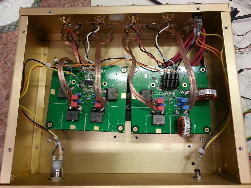

Not sure where the best place to post this is so hope this is the correct spot. Just wanted to share a small side project, amplifier built around the TPA311x.
After reading TI application note SLOA119A and testing out a number of different LC components with load (both resistor and driver), I found different LC components for 4 and 8 ohm speaker loads. I'm sure most of you knew that already but the I wanted to share my results and hope they agree with the consensus. The goal was relatively low peaking at 20k and reasonable suppression of the carrier signal.
8 Ohm = 33uH and 680nF. Used bourns 2200HT-330-V-RC and Wima MK series.
4 ohm = 10uH and 3.3uF. Used sumida CDEP147NP-100MC-125 and Wima MK series.

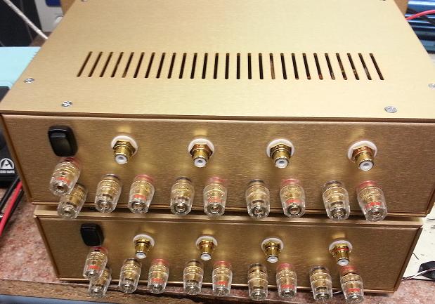

They ICs sound pretty good:) Using them in an active setup with 4 channels per box. Phone camera fuzzy pictures.
Cheers

There are a couple of threads running for the TPA311x...pix of class D is one.
I like the box.
I would not recommend the bourns 2200HT series for class D filtering...just not enough data on the cores for me to put them on the list.
Whose boards?

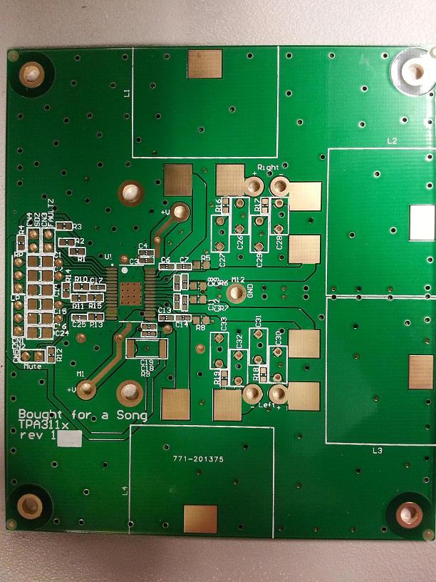

Thanks for the tips and comments. Maybe I could move this post to an appropriate thread? Do you have any recommendations for a 33uH Inductor? I Could drop it in and see if there is much difference. I rolled my own boards for this one as I was able to sneak a 2 layer onto on another panel order. Would like to do some distortion testing on different filters but time and access to reasonable test equipment is not one my side. Any suggestions are welcome:). I did some thread reading but not too many 33uH recommendations.

Thanks for checking. I do see some of that ringing on the bench but when connected with the driver, the effects are a bit less pronounced, bit still there. Further optimization can definately be done. Seeing the Q effects on the oscilloscope are a bit scary, as the higher frequency peaking looks bad. A better 33uH inductor is in order as the response is not ideal. I found the higher I pushed the fc, the higher carrier oscillation amplitude was. This only makes sense as it is a LP filter. I also found the driver load vs the resistive load makes a difference in the peaking so I picked my drivers to have low impedance rise. I didn't realize the output LC of class D was that critical. Definitely not a connect and forget kind of thing:).
